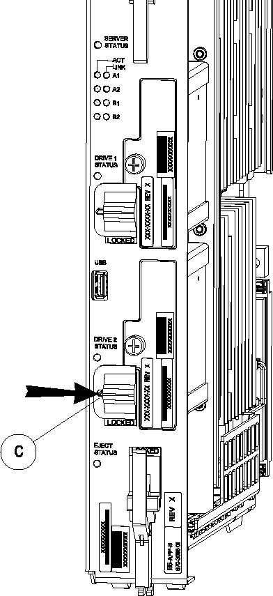

  1. Verify that the drive module is locked in position and in use.
    The switch lock release (C) is in the LOCKED position and the Status LED on the E5-APP-B card is OFF.
    Move the switch lock release (C) to the "released" position by pressing in the direction indicated. Refer to Figure 5-6.
    Figure 5-6 Drive Module Released

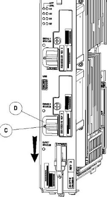

  2. Move drive module locking switch (D) from the LOCKED to the unlocked position and wait for the LED (B) to indicate a steady red state. See Figure 5-7 and Figure 5-8, respectively.
    When drive module locking switch (D) is transitioned from locked to unlocked, the LED will flash red to indicate the drive is unlocked and in process of shutting down.
    Figure 5-7 Drive Module UNLOCKED
    Caution:
    Removal of the drive prior to the LED indicating steady red could result in drive corruption.

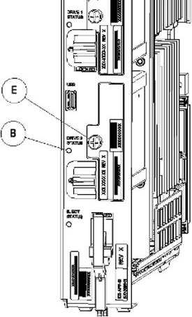

    Figure 5-8 Drive Module Status
    Drive Module Status
  3. When the LED indicates a steady red, the drive module can be safely removed.
  4. Loosen the drive module screw (E) (see Figure 5-8).

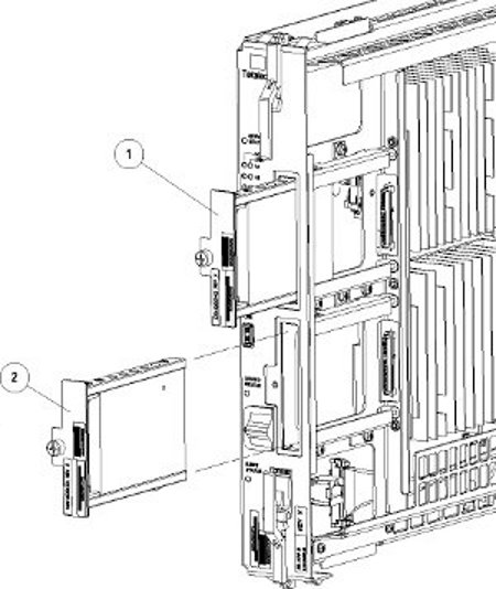

  5. Grasp the screw (E) and pull the drive out slowly until it is free from the card (see Figure 5-9).
    Figure 5-9 Drive Module Removal
