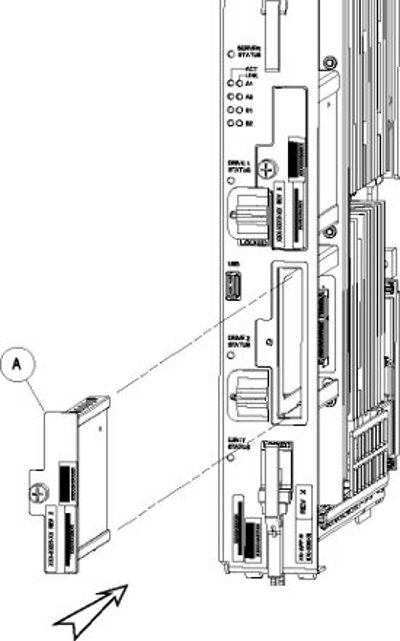

- Slide a new drive(s) module into the drive slot on the card (see Figure 5-10).
Figure 5-10 Drive Module Replacement
- Gently push the drive (A) in slowly until it is properly seated.
- Tighten the mounting screw until the Drive Status LED is in a steady red state ((B), from Figure 5-8).

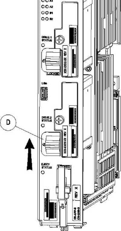

- Move the drive module locking switch (D) from the unlocked to the LOCKED position.
When drive module locking switch (D) is transitioned from unlocked to locked, the LED will flash red to indicate the drive is locked and in process of coming online (see Figure 5-11).
Figure 5-11 Drive Module Locked
