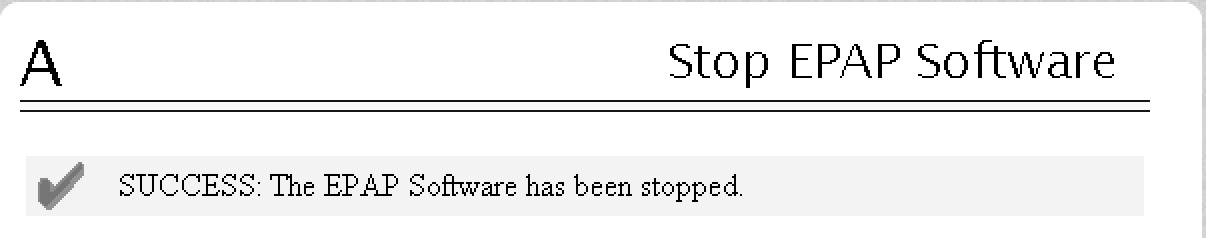

  5. Click the Stop EPAP Software button to stop the software.
    The screen shown in Figure A-8 appears.
    Figure A-8 Stop Software Completion Screen

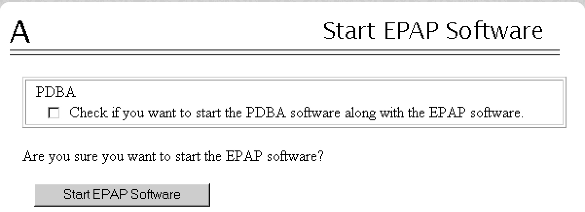

  6. Select Process Control > Start Software.
  7. From the Start EPAP Software screen, make sure that the check boxes are checked as shown in Figure A-9:
    Figure A-9 Start EPAP Software
    Start EPAP Software

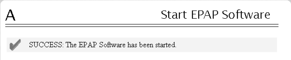

  8. Click the Start EPAP Software button to start the software.
    The screen shown in Figure A-10 confirms that the software has started:
    Figure A-10 Start Software Completion Screen
