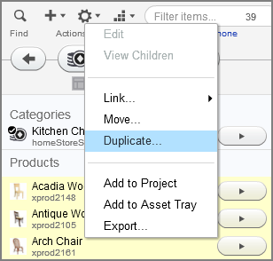

To duplicate assets:
  1. In a Commerce Assets project, select the assets you want to duplicate. See Using the Navigation Pane for details.
  2. Click the Actions button in the toolbar and select Duplicate.
    This illustration is described in the preceding text.
  3. In the dialog box that appears, select the parent asset that will contain the duplicates. See Using the Navigation Pane for details.
  4. Click OK.
