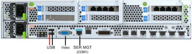

  2. To cable a serial connection, insert the serial console cable into the SER MGT (COM1) port. This illustration shows the USB, Video, and Serial Management ports on the back panel of the Netra Server X3-2 for Acme Packet.
    Connecting to USB, VGA and SER MGT (COM1) Ports

  3. To cable a USB Video connection:
    1. Insert the 15-pin connector on the end of the video cable into the Video port.
    2. Insert the USB cable from the mouse and keyboard into the USB ports.
  4. Lead the cables away from the rear panel and connect the cables to their respective destination components.
