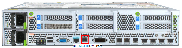

The following procedure explains how to make a connection to the Netra Server X3-2 for Acme Packet Integrated Lights Out Management (ILOM)port. For a remote permanent connection to the SP over the ILOM connection, use the rear panel NET MGT port.
Refer to the Netra Server X3-2 for Acme Packet hardware documentation for information on how to configure your Web browser application to connect to the console, and how to establish communications with the Netra Server X3-2 for Acme Packet.

Plug the RJ-45
connector into the ILOM port.
- Lead the cable away from the rear panel, and connect the other end of the cable to the LAN.
