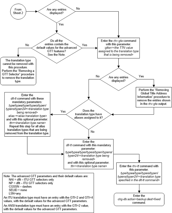

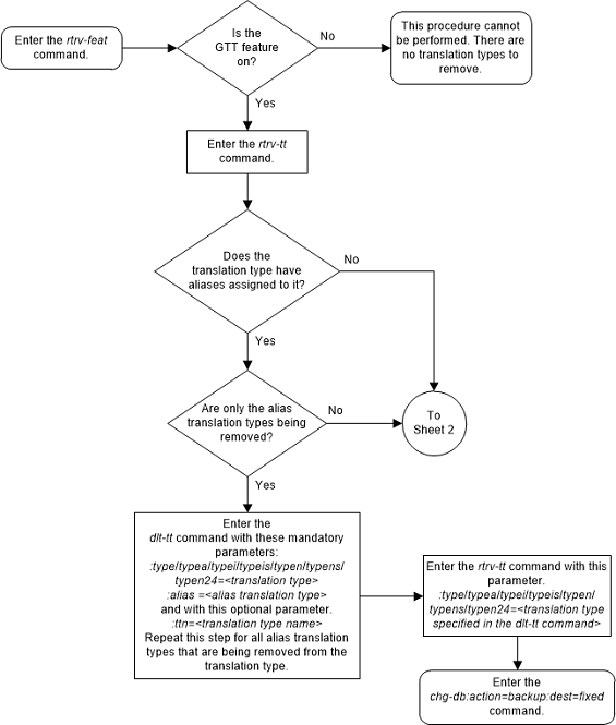

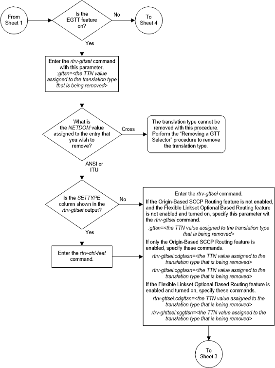

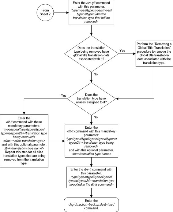

Figure 3-7 Remove a Translation Type - Sheet 1 of 4
Figure 3-8 Remove a Translation Type - Sheet 2 of 4
Figure 3-9 Remove a Translation Type - Sheet 3 of 4
Figure 3-10 Remove a Translation Type - Sheet 4 of 4
