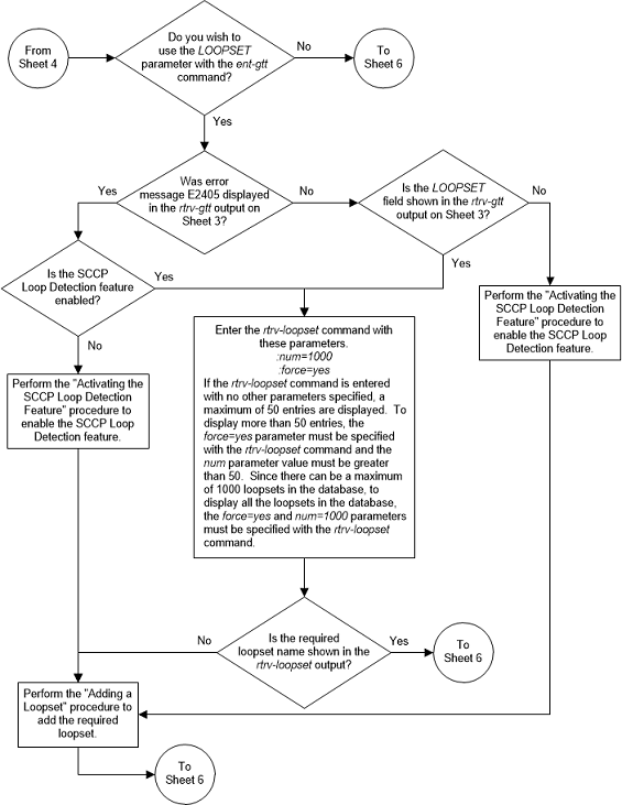

Adding a Global Title Translation
This procedure is used to add a global title translation to the database using the ent-gtt command.
The ent-gtt command uses these parameters.
:gta – Global title start address – along with the egta parameter, identifies all valid global titles for the given translation type to translate to the given pc or ssn parameters. These are the non-SS7 addresses transmitted to the STP for translation.
:type/typea/typei/typeis/typen/typens/typen24 – The translation type and network type of the translation type that is being assigned to the global title translation. The value of this parameter is shown in the rtrv-tt output and provisioned in the Adding a Translation Type procedure.
:ttn - the translation type name associated with the :type/typea/typei/typeis/typen/typens/typen24 parameter value. The value of this parameter is shown in the rtrv-tt output and provisioned in the Adding a Translation Type procedure.
:egta – Global title end address – along with the gta parameter, identifies all valid global titles for the given translation type to translate to the given pc or ssn parameters. These are the non-SS7 addresses transmitted to the STP for translation.
:force – the mated application override. Is the global title translation to be entered without a mated application in the database?

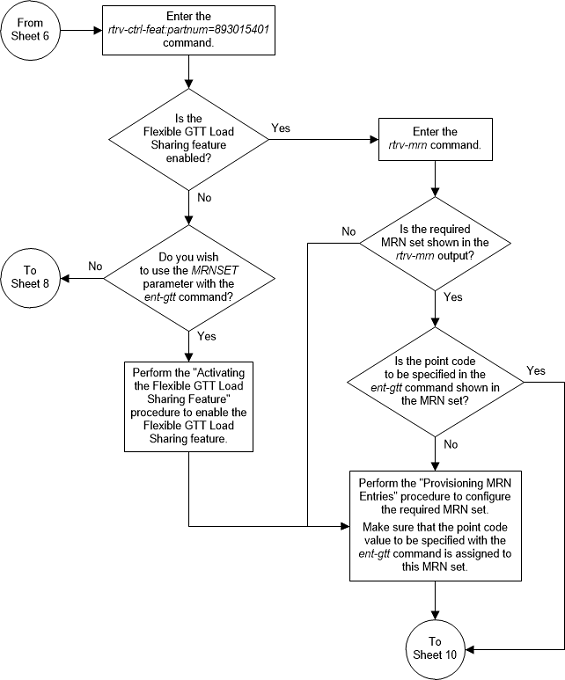

:xlat – Translate indicator – defines the type of global title translation that is to be performed.
:ri – Route indicator – indicates whether a subsequent global title translation is required.
:pc/pca/pci/pcn/pcn24 – The point code of the signaling point that is to receive the message.
See Chapter 2, "Configuring Destination Tables," in Database Administration - SS7 User's Guide for a definition of the point code types that are used on the EAGLE and for a definition of the different formats that can be used for ITU national point codes.
:ssn – Subsystem number – identifies the subsystem address that is to receive the message.
:gtmodid - the name of the GT modification identifier shown in the rtrv-gtmod output and provisioned in the Adding Global Title Modification Information procedure. The GT modification identifier contains the information to modify the numbering plan, nature of address indicator, and the prefix or suffix digits in the called party address or calling party address portion of outbound MSUs.
:mrnset – The MRN set ID, shown in the rtrv-mrn command. This parameter can be specified only, and must be specified, if the Flexible GTT Load Sharing feature is enabled and if the ri=gt parameter is specified for the global title translation. If the Flexible GTT Load Sharing feature is enabled, the point code specified for the global title translation must be assigned to the MRN set specified by this parameter. The status of the Flexible GTT Load Sharing feature is shown in the rtrv-ctrl-feat output. To enable the Flexible GTT Load Sharing feature, perform the Activating the Flexible GTT Load Sharing Feature procedure.
:mapset – The MAP set ID, shown in the rtrv-map command. This parameter can be specified only, and must be specified, if the Flexible GTT Load Sharing feature is enabled and if the ri=ssn parameter is specified for the global title translation. If the Flexible GTT Load Sharing feature is enabled, the point code and SSN specified for the global title translation must be assigned to the MAP set specified by this parameter. The status of the Flexible GTT Load Sharing feature is shown in the rtrv-ctrl-feat output. To enable the Flexible GTT Load Sharing feature, perform the Activating the Flexible GTT Load Sharing Feature procedure.
:loopset - The value of this parameter is the name of the loopset that is assigned to the GTT. This parameter can be specified only if the SCCP Loop Detection feature is enabled. Enter the rtrv-loopset command to verify that the SCCP Loop Detection feature is enabled. Perform the Activating the SCCP Loop Detection Feature procedure, if necessary. By default, the value of the loopset parameter is “none” because no loopset is assigned to the GTT.
:cggtmod - The calling party GT modification indicator. This parameter specifies whether or not calling party global title modification is required. The values for this parameter are yes (calling party global title modification is required) or no (calling party global title modification is not required). This parameter can be specified only if the AMGTT or AMGTT CgPA Upgrade feature is enabled. Enter the rtrv-ctrl-feat command to verify that either the AMGTT or AMGTT CgPA Upgrade feature is enabled. If the AMGTT or AMGTT CgPA Upgrade feature is not enabled, perform the Activating the Advanced GT Modification Feature procedure to enable the required feature.

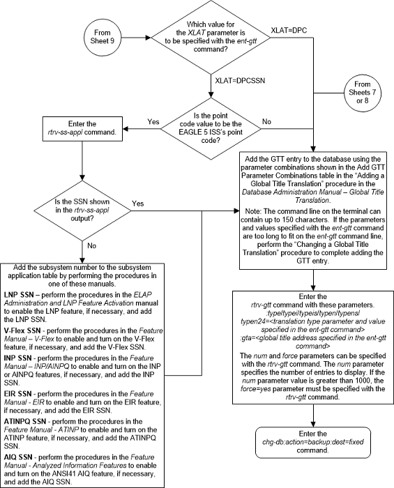

The global title translation data cannot be added to the database if the translation type is defined as an alias and if the global title translation data is already assigned to that translation type.
If the translate indicator is equal to dpc (xlat=dpc) and the routing indicator is equal to ssn (ri=ssn), and the force=yes parameter is not specified, the point code specified in the ent-gtt command must be defined in the database as a mated application. Verify this by entering the rtrv-map command. If this point code is not defined as a mated application, perform one of these procedures to add the point code and subsystem number to the database as a mated application:
The point code and subsystem number do not have to be in the mated application table when the ent-gtt command is executed if these parameters are specified with the ent-gtt command.
  • ri=gt
  • xlat=dpcssn and ri=ssn
If the point code and subsystem, if applicable, are not in the mated application table when either of these parameters are specified with the ent-gtt command, the EAGLE creates a solitary mated application in the mated application table using the point code and subsystem values specified in the ent-gtt command.
If the xlat=dpcssn parameter is specified, the ssn parameter must be specified. Otherwise, the ssn parameter cannot be specified.

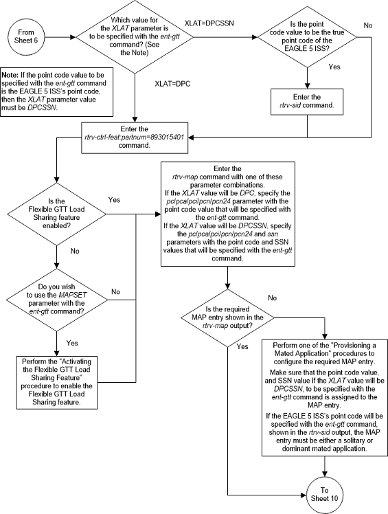

If a point code is the STP’s True PC, then the value of the XLAT parameter must be set to DPCSSN and the value of the RI parameter must be set to SSN. If the SSN parameter is specified and a point code is the STP’s True PC, then the subsystem number specified must exist in the SS-APPL table. This can be verified with the rtrv-ss-appl command. To execute the rtrv-ss-appl command, one or more features shown in Table 3-4 must be enabled, and turned on if necessary. The rtrv-ctrl-feat output shows the required status of the features.

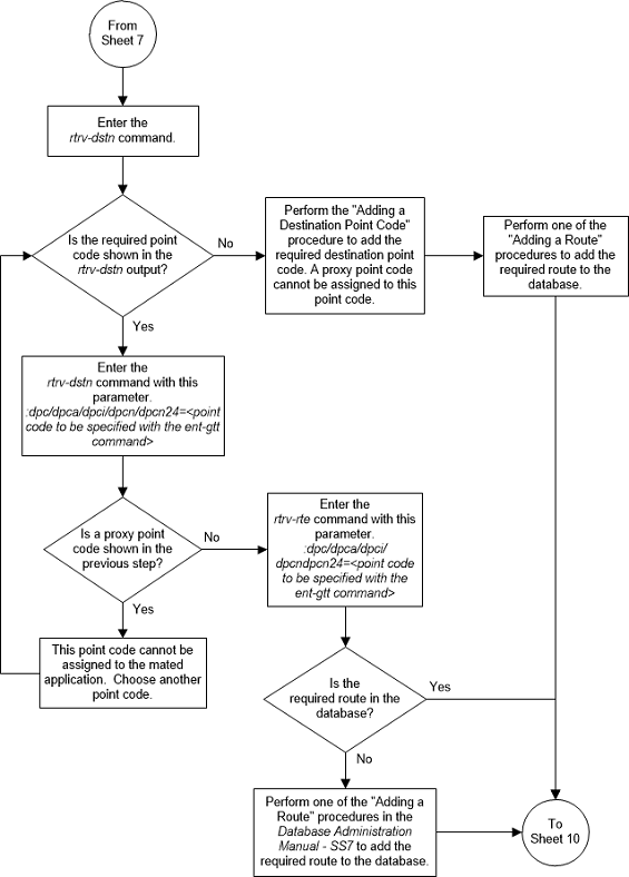

The point code specified in the ent-gtt command must be defined in the routing table or be the EAGLE’s point code. For ANSI point codes (pc/pca), the point code specified in the ent-gtt command, must be a full point code. That point code can be defined as a full point code in the destination point code table, or can be a member of a cluster point code defined in the destination point code table. Cluster point codes or a network routing point codes cannot be specified with this command. Enter the rtrv-rte command to verify that the point code is in the routing table. If the point code is not defined as a route, perform one of the Adding a Route procedures in Database Administration – SS7 User's Guide to define the point code as a route.
If the EAGLE’s point code is specified with the ent-gtt command, then the xlat=dpcssn and ri=ssn parameters must be specified. The EAGLE’s point code is shown in the PCA, PCI, PCN, or PCN24 fields of the rtrv-sid command output.
If the xlat=dpcngt parameter is specified, the ngt parameter and the ri=gt parameters must be specified.
An ANSI point code or ITU international point code containing all zeros is not a valid point code and cannot be entered into the database. An ITU national point code containing all zeros is a valid point code and can be entered into the database.

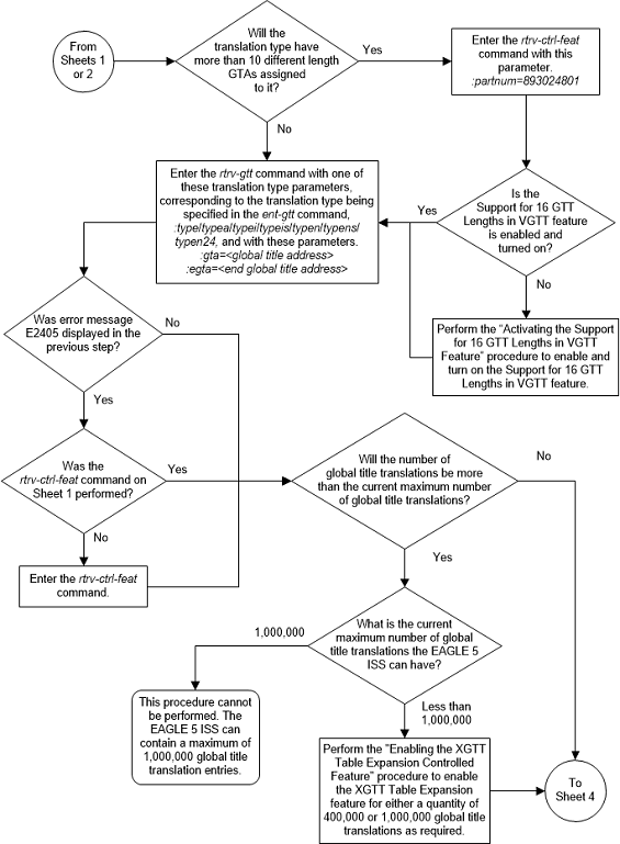

The end global title address (egta) must be greater than or equal to the start global title address (gta) and its length must be equal to the start global title address.

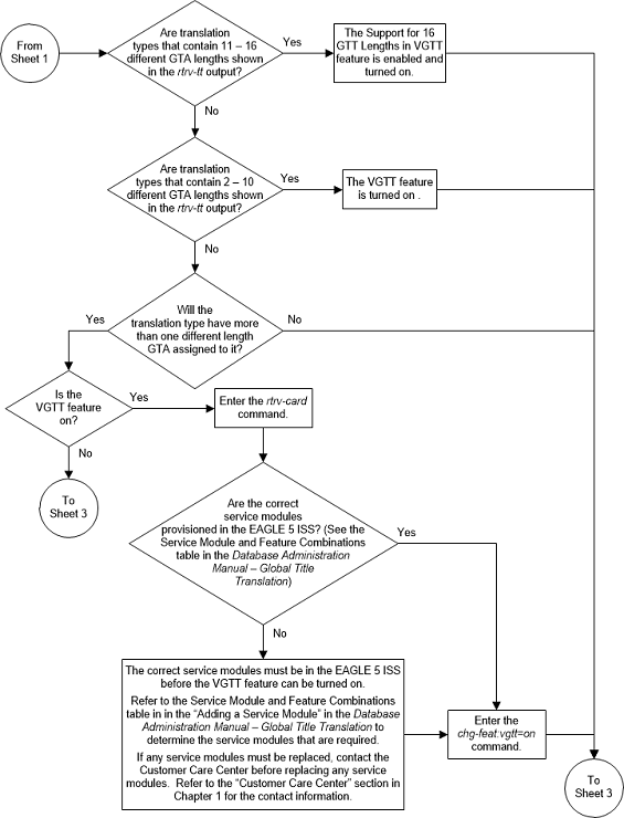

If the Variable-Length Global Title Translation (VGTT) feature is off, shown the entry VGTT = off, the global title address length must be equal to the number of digits specified by the given translation type. The length of the global title address can be verified with the rtrv-tt command.
If the Variable-Length Global Title Translation (VGTT) feature is on, shown the entry VGTT = on, up to 10 different length global title addresses can be assigned to a translation type. If the Activating the Support for 16 GTT Lengths in VGTT feature is enabled and on, shown the entry VGTT with 16 GTT lengths in the rtrv-ctrl-feat output, up to 16 different length global title addresses can be assigned to a translation type. The length of the global title address is only limited by the range of values for the gta and egta parameters, one to 21 digits, and by the global title addresses already assigned to the translation type. The ndgt parameter of the ent-tt command has no effect on the length of the global title address. As global title addresses of different lengths are assigned to a specific translation type, these lengths are displayed in the NDGT field of the rtrv-tt command output.
If the translation type has maximum number of different length global title addresses assigned to it, and another global title address is specified for the translation type, the length of the global title address being added to the translation type must be the same as one of the lengths already assigned to the translation type. If the length of the global title address does not match one of the lengths already assigned to the translation type, the ent-gtt command is rejected with this message.
E4007 Cmd Rej: Exceeding max GTA Lengths supported per TT
If the translation type has less than the maximum number of different length global title addresses assigned to it, and another global title address is specified for the translation type, the length of the global title address can be from one to 21 digits and does not have to match the length of the other global title addresses assigned to the translation type.
Refer to Variable-length Global Title Translation Feature for more information about this feature.
The range, as specified by the start and end global title addresses, cannot already exist in the global title translation data for the specified translation type. If the ranges overlap, the range of global title addresses cannot be split and the ent-gtt command is rejected with this message.
E2401 Cmd Rej:GTA range overlaps a current range. GTA range overlaps a current range
Along with error message 2401, a list of the overlapped global title addresses is displayed as shown in the following example.

The EAGLE can contain 269,999, 400,000, or 1,000,000 global title translations. The system default is 269,999 global title translations. This quantity can be increased to 400,000 by enabling the feature access key for part number 893-0061-01, or to 1,000,000 by enabling the feature access key for part number 893-0061-10. For more information on enabling these feature access keys, perform the Enabling the XGTT Table Expansion Feature procedure.

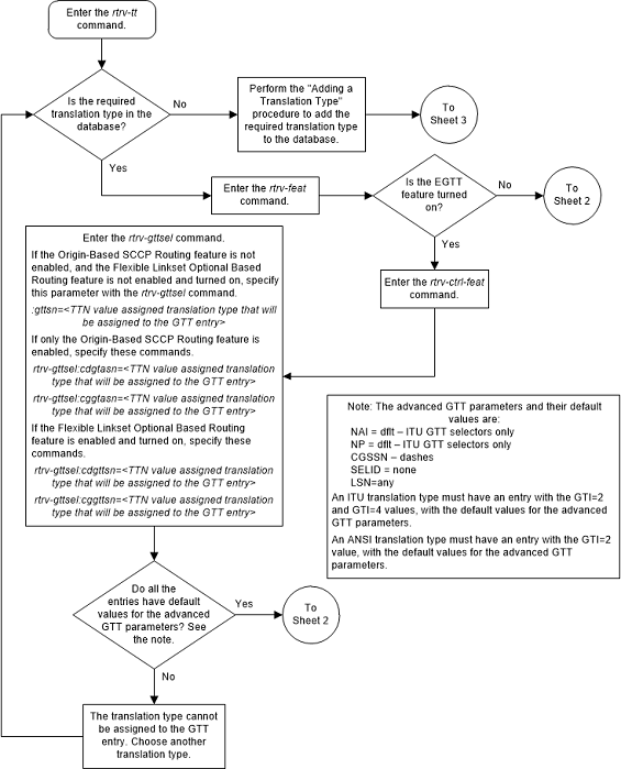

  1. Display the translation types in the database using the rtrv-tt command. This is an example of the possible output.
    rlghncxa03w 10-07-25 09:42:31 GMT  EAGLE5 42.0.0
    TYPEA      TTN        NDGT
    1          lidb       5
    2          c800       10
    3          d700       6
    5          scp1       6
    10         scp2       6
    15         scp3       3
    ALIAS      TYPEA
    30         5
    40         10
    50         3
    65         3
    TYPEI      TTN        NDGT
    105        itudb      8
    ALIAS      TYPEI
    7          105
    TYPEN      TTN        NDGT
    120        dbitu      7
    ALIAS      TYPEN
    8          120
    TYPEIS     TTN        NDGT
    ALIAS      TYPEIS
    TYPENS     TTN        NDGT
    ALIAS      TYPENS
    If the required translation type is shown in the rtrv-tt output, continue the procedure with 2.
    If the required translation type is not shown in the rtrv-tt output, perform the Adding a Translation Type procedure to add the translation type to the database. After the translation type has been added, continue the procedure with 10.
  2. Verify that the EGTT feature is on, by entering the rtrv-feat command. If the GTT feature is on, the EGTT field should be set to on.
    Thertrv-feat command output contains other fields that are not used by this procedure. If you wish to see all the fields displayed by thertrv-feat command, refer to thertrv-feat command description in Commands User's Guide.
    If the EGTT feature is off, continue the procedure with 5.
    If the EGTT feature is on, continue the procedure with 3.
  3. Display the features that are enabled by entering the rtrv-ctrl-feat command.
    The following is an example of the possible output.
    rlghncxa03w 10-07-28 21:15:37 GMT EAGLE5 42.0.0
    The following features have been permanently enabled:
    Feature Name              Partnum    Status  Quantity
    Command Class Management  893005801  on      ----
    LNP Short Message Service 893006601  on      ----
    Intermed GTT Load Sharing 893006901  on      ----
    HC-MIM SLK Capacity       893012707  on      64
    The following features have been temporarily enabled:
    Feature Name              Partnum    Status  Quantity     Trial Period Left
    Zero entries found.
    The following features have expired temporary keys:
    Zero entries found.
  4. Display the GTT selectors in the database by entering the rtrv-gttsel command with the TTN value associated with the translation type that will be assigned to the global title translation. The TTN value is shown in the rtrv-tt output in 1.
    To specify of the TTN value, the parameters shown in Table 3-6 must be specified with the rtrv-gttsel command. The parameters that can be specified are dependent on the features that are enabled, shown in 3.
    Table 3-6 RTRV-GTTSEL Parameters
    Feature that is Enabled Parameter that must be Specified for the TTN Value
    Neither the Origin Based SCCP Routing nor the Flexible Linkset Optional Based Routing, shown as Flex Lset Optnl Based Rtg in thertrv-ctrl-feat output, is enabled. gttsn
    Origin Based SCCP Routing cdgtasn,cggtasn
    Flexible Linkset Optional Based Routing cdgttsn,cggttsn
    For this example, enter these commands.
    rtrv-gttsel:gttsn=scp1
    GTIA    TT     NP      NAI  SELID GTTSN
     2       5     --      ---  none  scp1
    GTII    TT     NP      NAI  SELID GTTSN
    GTIN    TT     NP      NAI  SELID GTTSN
    GTIN24  TT     NP      NAI  SELID GTTSN
    GTIIS   TT     NP      NAI  SELID GTTSN
    GTINS   TT     NP      NAI  SELID GTTSN
    rtrv-gttsel:gttsn=scp2
     2      10     --      ---  none  scp2
    rtrv-gttsel:gttsn=scp3
     2      15     --      ---  none  scp3
    If any of the entries shown in the rtrv-gttsel output do not have the default values for the advanced GTT parameters, or if a GTT selector entry with the TTN value was removed with the dlt-gttsel command, the remainder of this procedure cannot be performed. Choose another translation type to assign to the global title translation and repeat this procedure from 1.
    If all of the entries shown in the rtrv-gttsel output have the default values for the advanced GTT parameters, and none of the GTT selector entries with the TTN value were removed with the dlt-gttsel command, continue the procedure with 5.
  5. Continue the procedure by performing one of these steps to verify if the VGTT or the Support for 16 GTT Lengths in VGTT features can be used to provision the global title translation.
    If multiple values are shown in the NDGT column for any translation type entry, the Variable-Length Global Title Translation feature is turned on. If a translation type entry contains 11 - 16 values in the NDGT column, the Support for 16 GTT Lengths in VGTT feature is enabled and turned on.
    • If no more than 10 values are shown in the NDGT column for any translation type, continue the procedure by performing one of these steps.
      • If the translation type will contain no more than 10 different length global title addresses, continue the procedure with 10.
      • If the translation type will contain more than 10 different length global title addresses, continue the procedure with 9.
    • If more than 10 values are shown in the NDGT column for any translation type, continue the procedure with 10.
    If only single values are shown in the NDGT column for all the translation type entries, continue the procedure by performing one of these steps.
    • If the translation type will contain global title addresses of only one length, continue the procedure with 10.
    • If the translation type will contain multiple lengths of global title addresses, continue the procedure with 6.
  6. Verify that the VGTT feature is on, by entering the rtrv-feat command. If the VGTT feature is on, the VGTT field should be set to on. For this example, the VGTT feature is off.
    Thertrv-feat command output contains other fields that are not used by this procedure. If you wish to see all the fields displayed by thertrv-feat command, see thertrv-feat command description in Commands User's Guide.
    Continue the procedure by performing one of these steps.
    • If the VGTT feature is on, continue the procedure by performing one of these steps.
    • If the VGTT feature is off, continue the procedure with 7.

    The correct service modules must be in the EAGLE before the VGTT feature can be turned on, or the Support for 16 GTT Lengths in VGTT feature can be enabled and turned on. See the Adding a Service Module procedure to determine the service modules that are required. If any service modules must be replaced, contact the Customer Care Center before replacing any service modules. Refer to My Oracle Support (MOS) for the contact information.
  8. Turn the Variable-length Global Title Translation (VGTT) feature on by entering this command.
    chg-feat:vgtt=on
    Once the Variable-length Global Title Translation (VGTT) feature is enabled with thechg-feat command, it cannot be disabled.
    The VGTT feature must be purchased before turning it on. If you are not sure whether you have purchased the VGTT feature, contact your Sales Representative or Account Representative.
    When the chg-feat has successfully completed, this message should appear.
    rlghncxa03w 09-05-25 09:57:41 GMT EAGLE5 41.0.0
    CHG-FEAT: MASP A - COMPLTD
    • If the translation type will contain more than 10 different length global title addresses, perform the Activating the Support for 16 GTT Lengths in VGTT Feature procedure to enable and turn on the Support for 16 GTT Lengths in VGTT feature. After the Support for 16 GTT Lengths in VGTT feature has been enabled and turned on, continue the procedure with 10.
  9. Display the status of the Support for 16 GTT Lengths in VGTT feature by entering this command.
    rtrv-ctrl-feat:partnum=893024801
    VGTT with 16 GTT lengths  893024801 on     ----
    Zero entries found.
    Zero entries found.
    If the Support for 16 GTT Lengths in VGTT feature is enabled and turned on, continue the procedure with 10.
    If the Support for 16 GTT Lengths in VGTT feature is not enabled or turned on, perform the Activating the Support for 16 GTT Lengths in VGTT Feature procedure to enable and turn on the Support for 16 GTT Lengths in VGTT feature. After the Support for 16 GTT Lengths in VGTT feature has been enabled and turned on, continue the procedure with 10.
  10. Display the global title translations in the database using the rtrv-gtt command specifying a translation type (type), translation type name (ttn), or both from the rtrv-tt command output shown in 1 along with the desired global title address (gta). If a range of global title addresses will be specified for the global title translation, the egta parameter can be specified with the rtrv-gtt command. For this example, enter these commands.
    rtrv-gtt:typea=5:gta=910460
    rtrv-gtt:typea=10:gta=615370:egta=615380
    rtrv-gtt:typea=15:gta=800:egta=900
    To add a global title translation, the desired global title addresses cannot be in the database. If the global title addresses are not in the database, the rtrv-gtt command is rejected with the following message.
    E2405 Cmd Rej: GTA does not exist in any range
  11. The global title translation cannot be added to the database if the database contains the maximum number of global title translations the EAGLE is allowed to have. The maximum number of global title translations is shown in the rtrv-gtt output in 10 or the rtrv-ctrl-feat output.
    If error message E2405 was displayed in the output in 10, enter the rtrv-ctrl-feat command to verify the maximum number of global title translations that are allowed in the database.

  12. Continue the procedure by performing these steps based the XGTT Table Expansion entry that is shown in the rtrv-ctrl-feat output in either 3 or 11.
    If the entryXGTT Table Expansion is not shown in thertrv-ctrl-feat output, the maximum number of global title addresses that the database can contain is 269,999.
    If the maximum number of global title translations is 1,000,000, and adding the global title translation will exceed 1,000,000 global title translations, the new global title translation cannot be added and the remainder of this procedure cannot be performed.
    If the maximum number of global title translations is either 269,999 or 400,000 and adding the global title translation will exceed the maximum number of global title translations, perform the Enabling the XGTT Table Expansion Feature procedure to enable XGTT Table Expansion feature for either 400,000 or 1,000,000 global title translations as needed.
    If adding the global title translation will not exceed the maximum number of global title translations, or if the Enabling the XGTT Table Expansion Feature procedure was performed in this step, continue the procedure by performing one of these steps.
    • If the gtmodid parameter will be specified for the global title translation, continue the procedure with 13.
    • If the cggtmod=yes parameter will be specified for the global title translation and the gtmodid parameter will not be specified for the global title translation, continue the procedure with 14.
    • If the gtmodid and cggtmod=yes parameters will not be specified for the global title translation, continue the procedure with 15.

  15. A loopset can be assigned to the global title translation to determine if SCCP messages are being looped. The loopset parameter is used to assign a loopset to a global title translation. To assign a loopset to the global title translation, the SCCP Loop Detection feature must be enabled.
    If you do not wish to specify theloopset parameter with theent-gtt command, continue the procedure with 17.
    If the SCCP Loop Detection feature is enabled, the LOOPSET field is shown in the rtrv-gtt output, and the entry SCCP Loop Detection is shown in the rtrv-ctrl-feat output.
    If the LOOPSET field is shown in the rtrv-gttoutput in 10, continue the procedure with 16.
    If error message E2405 is displayed in the rtrv-gttoutput in 10, enter the rtrv-ctrl-feat command with the SCCP Loop Detection feature part number to verify the status of the SCCP Loop Detection feature. Enter this command.
    rtrv-ctrl-feat:partnum=893016501
    rlghncxa03w 09-05-28 21:15:37 GMT EAGLE5 41.0.0
    SCCP Loop Detection       8930165101  on      ----
    Zero entries found.
    Zero entries found.
    If the SCCP Loop Detection feature is enabled, continue the procedure with 16.
    If the LOOPSET field does not appear in the rtrv-gttoutput in 10, or the rtrv-ctrl-feat output shows that the SCCP Loop Detection feature is not enabled, perform the Activating the SCCP Loop Detection Feature procedure to enable the SCCP Loop Detection feature. After the SCCP Loop Detection feature has been enabled, perform the Adding a Loopset procedure to add the required loopset. After the loopset has been added, continue the procedure with 17.
  16. Display all the loopsets in the database by entering this command
    rtrv-loopset:num=1000:force=yes
    LoopSet            Mode          Point Codes
    cary2             notify         005-015-005     007-007-007 (ANSI)
                                     033-004-003     033-007-003
                                     005-027-005     007-004-007
    cary4             notify         005-012-005     007-026-007 (ANSI)
                                     003-049-003     033-002-003
                                     005-008-055     007-014-007
    apex3             discard        005-017-008     007-017-009 (ANSI)
                                     033-005-043     005-014-005
                                     005-017-005     007-014-007
                                     033-002-043     005-038-005
                                     007-009-027     033-003-043
                                     005-012-005     007-002-027
    apex4             discard        005-007-008     027-007-009 (ANSI)
                                     033-005-003     005-004-055
                                     027-001-007     033-008-003
                                     033-007-003     005-003-055
                                     027-008-007
    ral5              notify         005-005-005     007-007-007 (ANSI)
                                     003-004-003     003-001-003
                                     005-007-005     007-004-007
                                     003-002-003     005-008-005
                                     007-009-007     003-003-003
                                     005-002-005     007-002-007
    ral6              notify         005-007-008     007-007-009 (ANSI)
                                     003-005-003     003-007-003
                                     005-007-005
    dunn1             discard        005-002-055     007-051-007 (ANSI)
                                     003-008-033
    rtp9              discard        005-002-005     007-001-007 (ANSI)
                                     003-008-003     003-007-003
                                     005-003-005     007-008-007
                                     005-004-005
    rtp5              discard        005-007-008     007-007-009 (ANSI)
                                     003-005-003
    rtp1              discard        005-005-005     007-007-007 (ANSI)
                                     003-004-003     003-007-003
                                     005-004-005
    rtp2              notify         005-007-008     007-007-009 (ANSI)
                                     003-005-003
    LOOPSET table is (11 of 1000) 1% full
    RTRV-LOOPSET: MASP A - COMPLTD
    If thertrv-loopset command is entered with no other parameters specified, a maximum of 50 entries are displayed. To display more than 50 entries, theforce=yesparameter must be specified with thertrv-loopset command and the num parameter value must be greater than 50. Since there can be a maximum of 1000 loopsets in the database, to display all the loopsets in the database, theforce=yes andnum = 1000parameters must be specified with thertrv-loopset command.
    If the required loopset is shown in the rtrv-loopset output, continue the procedure with 17.
    If the required loopset is not shown in the rtrv-loopset output, perform the Adding a Loopset procedure to add the required loopset. After the loopset has been added, continue the procedure with 17.

  19. To use either the mrnset parameter (if the routing indicator value for the global title translation is GT) or mapset parameter (if the routing indicator value for the global title translation is SSN), the Flexible GTT Load Sharing feature must be enabled.
    If the Flexible GTT Load Sharing feature is enabled, either the mrnset or mapset parameters, depending on the routing indicator value for the global title translation being added in this procedure, must be specified with the ent-gtt command.
    Verify that the Flexible GTT Load Sharing feature is enabled by entering this command.
    rtrv-ctrl-feat:partnum=893015401

    If the routing indicator for the global title translation being added is GT, there are three actions that can be taken.
    • If the Flexible GTT Load Sharing feature is not enabled, and you do not wish to specify the mrnset parameter for the global title translation, continue the procedure with 20.
    • If the Flexible GTT Load Sharing feature is not enabled, and you do wish to specify the mrnset parameter for the global title translation, perform the Activating the Flexible GTT Load Sharing Feature procedure to enable the Flexible GTT Load Sharing feature. After enabling the Flexible GTT Load Sharing feature, continue the procedure with 23.
    • If the Flexible GTT Load Sharing feature is enabled, continue the procedure with 23.

  20. Display the destination point codes in the database by entering the rtrv-dstn command. This is an example of the possible output.
    rlghncxa03w 10-12-10 11:43:04 GMT EAGLE5 43.0.0
    Extended Processing Time may be Required
       DPCA          CLLI        BEI ELEI   ALIASI           ALIASN/N24    DMN
       001-207-000   ----------- no  --- --------------   --------------   SS7
       001-001-001   ----------- no  --- --------------   --------------   SS7
       001-001-002   ----------- no  --- --------------   --------------   SS7
       001-005-000   ----------- no  --- --------------   --------------   SS7
       001-007-000   ----------- no  --- --------------   --------------   SS7
       008-012-003   ----------- no  --- --------------   --------------   SS7
       003-002-004   ----------- no  --- --------------   --------------   SS7
       009-002-003   ----------- no  --- --------------   --------------   SS7
       010-020-005   ----------- no  --- --------------   --------------   SS7
       DPCI          CLLI        BEI ELEI   ALIASA           ALIASN/N24    DMN
       1-207-0       ----------- no  --- --------------   --------------   SS7
       0-015-0       ----------- no  --- --------------   --------------   SS7
       0-017-0       ----------- no  --- --------------   --------------   SS7
       1-011-1       ----------- no  --- --------------   --------------   SS7
       1-011-2       ----------- no  --- --------------   --------------   SS7
    Destination table is (14 of 2000) 1% full
    Alias table is (0 of 12000) 0% full
    PPC table is (1 of 20) 5% full
    If the required point code is not shown in the rtrv-dstn output, perform the "Adding a Destination Point Code" procedure in Database Administration - SS7 User's Guide to add the required point code. A proxy point code cannot be assigned to the point code.
    After the new point code has been added, perform one of the Adding a Route procedures in Database Administration - SS7 User's Guide to add the required route to the database. After the route has been added, continue the procedure with 27.
  21. Display the point code that will be assigned to the global title translation by using the rtrv-dstn command and specifying the point code. For this example, enter this command.
    rtrv-dstn:dpca=010-020-005
       PPCA         NCAI PRX     RCAUSE NPRST SPLITIAM HMSMSC HMSCP SCCPMSGCNV
       009-002-003  ---- no      50     on    20       no     no    none
    If the point code is not shown in the rtrv-dstn command output, the following output is displayed.
    rlghncxa03w 09-05-10 11:43:04 GMT EAGLE5 41.0.0
    No destinations meeting the requested criteria were found
    A proxy point code (a point code value is shown in the PPC column) cannot be assigned to the point code. If a proxy point code is shown in this step, choose another point code from the rtrv-dstn output in 20 and repeat this step.
    If the point code is not shown in the rtrv-dstn output, perform the “Adding a Destination Point Code” procedure in Database Administration - SS7 User's Guide and add the point code to the destination point code table.
  22. The point code specified with the ent-gtt command must be the DPC of a route, unless the point code is the EAGLE’s point code. Enter the rtrv-rte command with the dpc parameter specifying the point code to be used with the ent-gtt command to verify whether or not the point code is the DPC of a route.
    rtrv-rte:dpca=007-007-007
    rlghncxa03w 09-05-07 11:43:04 GMT  EAGLE5 41.0.0
       DPCA       ALIASI     ALIASN/N24     LSN        RC      APCA
    007-007-007  --------   -----------     ls03       10    007-007-007
                                            ls02       30    150-150-150
                                            lsa2       50    200-200-200
                                                   RTX:No  CLLI=ls03clli
    rtrv-rte:dpca=003-003-003
    003-003-003   --------    ----------    ls02       10    002-002-002
                                            ls08       30    025-025-150
                                            lsa5       50    066-030-100
                                                   RTX:No  CLLI=ls07clli
    rtrv-rte:dpca=005-005-005
    005-005-005    ------    -----------    ls05    10    005-005-005
                                            ls15    30    089-047-123
                                            lsa8    50    077-056-000
                                                   RTX:No  CLLI=ls05clli
    If the point code is not shown in the rtrv-rte output, perform one of the Adding a Route procedures in Database Administration - SS7 User's Guide and add the required route to the database.
  23. The point code and MRN set ID specified for the global title translation must be shown in the rtrv-mrn command output. The point code must be assigned to the MRN set that will be assigned to the global title translation.
    Enter the rtrv-mrn command to verify that the required MRN set is configured in the database, and that the required point code is assigned to the MRN set. The following is an example of the possible output.
    MRNSET   PC             RC
    DFLT     001-001-001    10
             001-001-002    20
             001-001-003    30
    MRNSET   PC             RC
    110      001-001-001    10
             001-001-005    20
             001-001-006    30
             001-001-003    40
             001-001-008    50
    MRNSET   PC             RC
    111      001-001-001    30
             001-001-005    30
             001-001-006    30
             001-001-003    30
             001-001-008    30
    MRNSET   PC             RC
    112      001-003-001    10
             001-003-002    10
             001-003-003    30
             001-003-004    30
             001-003-006    60
             001-003-007    60
             001-003-008    80
             001-003-009    80
    MRNSET   PCN               RC
    113      s-1-1-1-0123-aa   1
             s-1-1-1-0235-aa   2
             s-1-1-1-0235-aa   3
    If theWeighted GTT Load Sharing feature is enabled, theWT, %WT, andTHR columns are shown in thertrv-mrn output
    If the required MRN set is not shown in the rtrv-mrn output, or if the required point code is not assigned to the required MRN set, provision the required MRN set by performing the Provisioning MRN Entries procedure. After provisioning the required MRN set, continue the procedure with 27.
    If the required MRN set is shown in the rtrv-mrn output, or if the required point code is assigned to the required MRN set, continue the procedure with 27.
    If the EAGLE’s point code is not going to used for thepc parameter of theent-gtt command, continue the procedure with 26.
  24. If the ri=ssn and xlat=dpcssn parameters are specified with the ent-gtt command, and you wish to use the EAGLE’s point code for the value of the pc parameter of the ent-gtt command, the point code value must be in the EAGLE’s self ID table. Display the EAGLE self-identification, using the rtrv-sid command.
    PCA               PCI          PCN           CLLI         PCTYPE
    010-020-030     1-023-1      12-0-14-1     rlghncxa03w    OTHER
                  s-1-023-1    s-12-0-14-1
    CPCA
    002-002-002       002-002-003       002-002-004      002-002-005
    002-002-006       002-002-007       002-002-008      002-002-009
    004-002-001       004-003-003       050-060-070
    CPCI
    1-001-1           1-001-2           1-001-3          1-001-4
    1-002-1           1-002-2           1-002-3          1-002-4
    2-001-1           7-222-7
    CPCN
    2-0-10-3          2-0-11-0          2-0-11-2          2-0-12-1
    2-2-3-3           2-2-4-0           10-14-10-1

  26. Enter the rtrv-map command with the pc parameter specifying the required point code to verify that the required data is in the mated application table.
    For this example enter this command.
    rtrv-map:pca=005-005-005
    If the Flexible GTT Load Sharing feature is not enabled, this is an example of the possible output.
    rlghncxa03w 09-07-25 09:42:31  GMT  EAGLE5 41.1.0
       PCA            Mate PCA      SSN RC MULT SRM MRC GRP NAME SSO
       005-005-005                  250 10  SOL *Y  *Y  GRP01     ON
    MAP table is (37 of 1024) 4% full.
    If the Flexible GTT Load Sharing feature is enabled, this is an example of the possible output.
       MAPSET ID=DFLT
       005-005-005                   55  5  DOM YES YES -------- OFF
                      001-001-002    15 15  DOM YES YES -------- ON
                      001-001-003    25 20  DOM YES YES -------- ON
                      001-001-002    40 35  DOM YES YES -------- OFF
       MAPSET ID=1
       005-005-005                   50  5  DOM YES YES -------- OFF
                      001-001-002    10 15  DOM YES YES -------- ON
                      001-001-003    20 20  DOM YES YES -------- ON
       MAPSET ID=    2
       005-005-005                    5 10  SOL *Y  *Y  -------- OFF
    MAP table is (12 of 36000) 1% full.
    If the ri=ssn and xlat=dpc parameters are being specified with the ent-gtt command, the point code must be in the mated application table. If the point code is not in the mated application table when the ent-gtt command is executed, the force=yes parameter must be specified with the ent-gtt command.
    If the EAGLE’s true point code and the EAGLE’s subsystem number, along with the ri=ssn and xlat=dpcssn parameters are being specified with the ent-gtt command, the EAGLE’s true point code and the EAGLE’s subsystem number must be in the mated application table.
    If the required point code, subsystem number, or MAP set ID is not shown in the rtrv-map output, perform one of these procedures to add the required information to the mated application table.
  27. Add the global title translation to the database using the ent-gtt command using the parameter combinations shown in Table 3-7.
    ent-gtt:typea=5:gta=910460:egta=919460:xlat=dpcngt:ri=gt :pca=007-007-007:ttn=scp1:mrnset=114:cggtmod=yes:gtmodid=modid2
    ent-gtt:typea=10:gta=615370:egta=615380:xlat=dpcssn:ri=ssn :pca=003-003-003:ssn=254:ttn=scp2:mapset=3
    ent-gtt:typea=15:gta=800:egta=900:xlat=dpc:ri=ssn:pca=005-005-005 :ttn=scp3:mapset=1:loopset=rtp:cggtmod=yes
    When each of these commands have successfully completed, this message should appear.
    rlghncxa03w 09-05-07 11:44:13 GMT  EAGLE5 41.0.0
    ENT-GTT:  MASP A - COMPLTD
    The command line on the terminal can contain up to 150 characters. If the parameters and values specified with theent-gtt command are too long to fit on theent-gtt command line, perform the Changing a Global Title Translationprocedure to complete adding the GTT entry.

Figure 3-11 Add a Global Title Translation - Sheet 1 of 10
Figure 3-12 Add a Global Title Translation - Sheet 2 of 10
Figure 3-13 Add a Global Title Translation - Sheet 3 of 10
Figure 3-14 Add a Global Title Translation - Sheet 4 of 10
Figure 3-15 Add a Global Title Translation - Sheet 5 of 10
Figure 3-16 Add a Global Title Translation - Sheet 6 of 10
Figure 3-17 Add a Global Title Translation - Sheet 7 of 10
Figure 3-18 Add a Global Title Translation - Sheet 8 of 10
Figure 3-19 Add a Global Title Translation - Sheet 9 of 10
Figure 3-20 Add a Global Title Translation - Sheet 10 of 10
