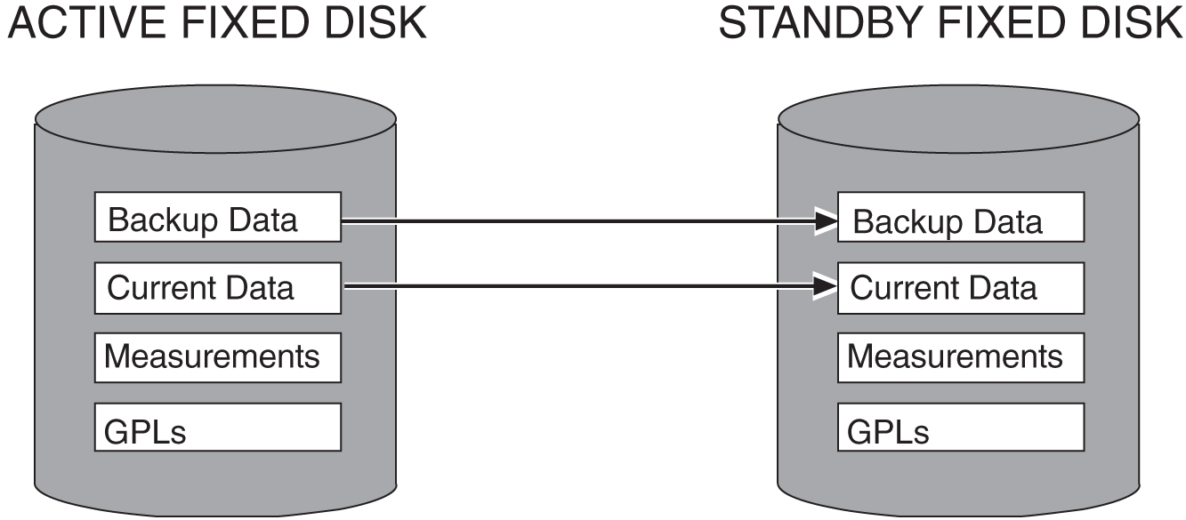

Perform the repair procedure whenever the two fixed disks have a different database image, such as after a MASP failure. This procedure copies the fixed disk image of the database associated with the active MASP to the fixed disk of the standby MASP. Figure 2-8 illustrates this action. To repair a database, The chg-db command uses only one parameter, action=repair – the operation to perform on the database, repairing a database
Figure 2-8 Action of the Repair Procedure

chg-db:action=repair command. This command can take up to 30 minutes to execute, depending on the size of the database and other system activity that is in progress when this command is entered.
If this command takes more than 60 minutes to execute, contact My Oracle Support (MOS).During command execution, these messages appear:
REPAIR: MASP A - Repair starts on standby MASP. REPAIR: MASP A - Standby MASP will reboot to load data. REPAIR: MASP A - Repair from fixed disk complete.
