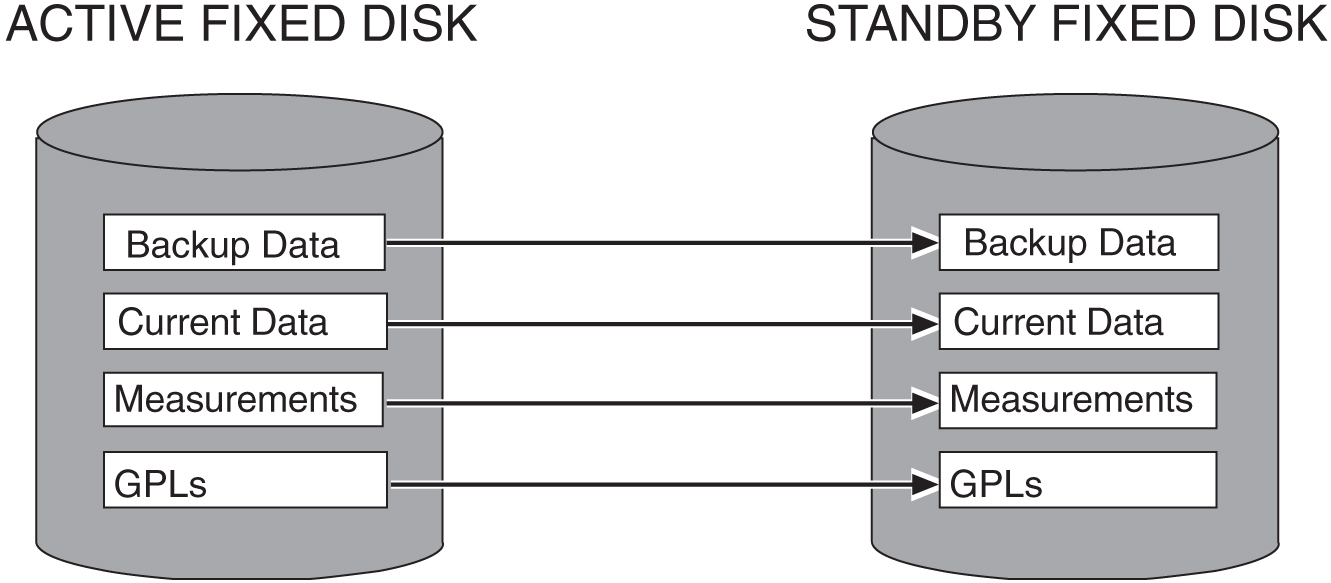

This procedure copies everything on the active fixed disk to the standby fixed disk using the copy-disk command. Figure 2-10 shows the action of the copy-disk command.
Figure 2-10 Action of the Copy Disk Procedure
