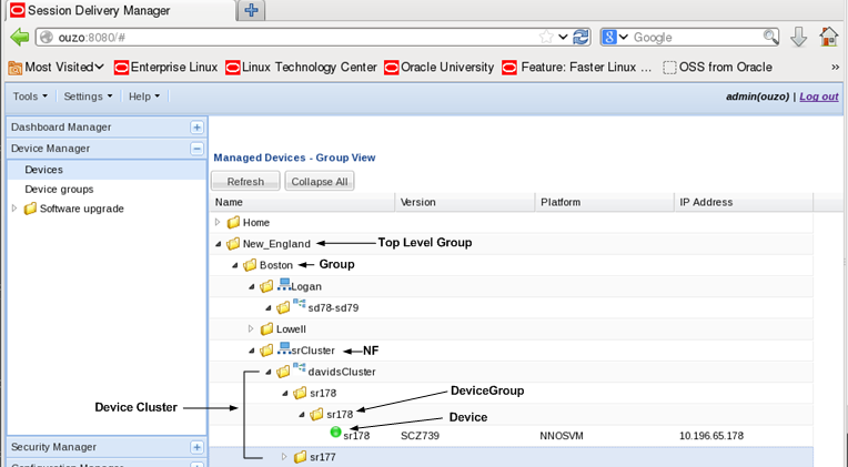

Expand the Device Manager slider and click Devices. The system displays a device group hierarchy showing the group, subgroup, and the network function (NF) that contains the devices, as shown in the following example.
Figure 2-2 Device groups and their associated NF devices
The following states of a device in the Managed Devices table indicate if it can be reached by Oracle Communications Session Element Manager:
- Green—The Oracle Communications Session Element Manager can reach the device and retrieve information about the device through SNMP.
- Red—The Oracle Communications Session Element Manager cannot currently reach the device (or cannot contact both devices in an HA device pair).
