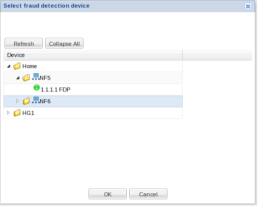

- Expand the Fraud Protection Manager slider, and click Administration.
 - In the Fraud detection devices page, select an FDP from the FDP table and click Register.
