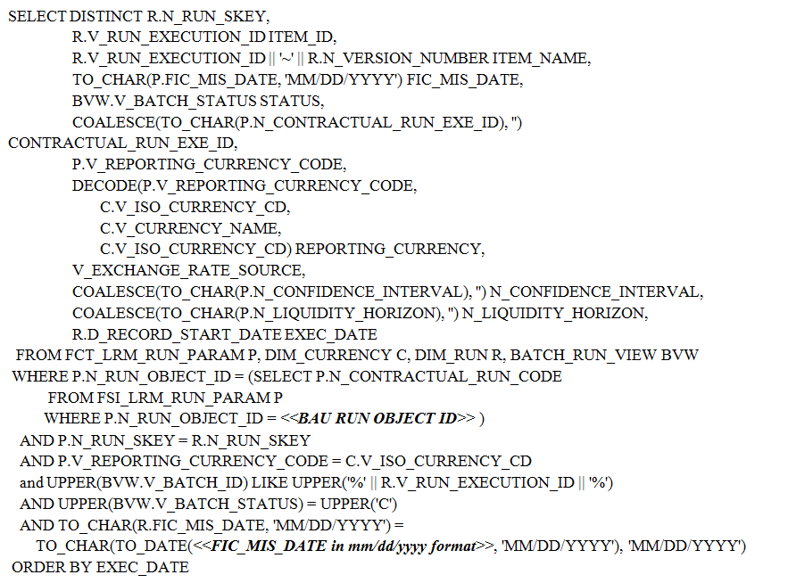

f.       CONTRAEXECID: For BAU/Stress Run, enter the ID of the Contractual Run execution to be used. The following query can be used to find the various Contractual Run Execution IDs:
NOTE:
Choose any value of ITEM_ID column as an input for CONTRAEXECID from the result of the query.
