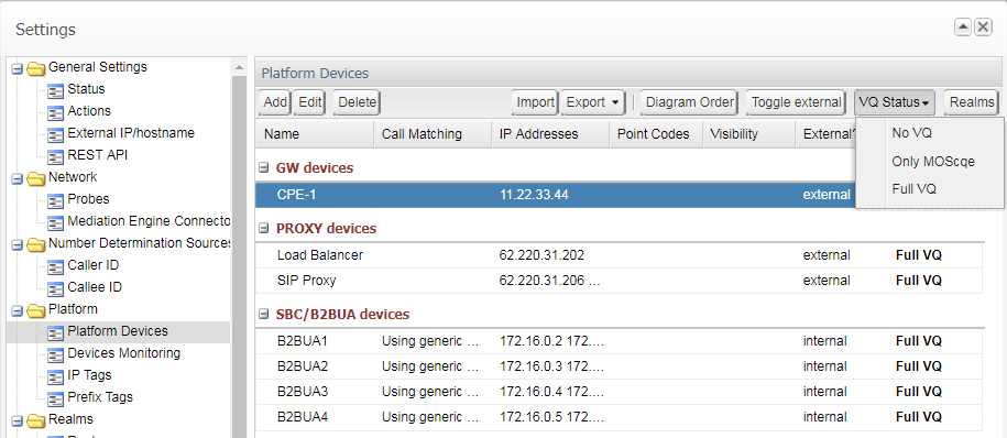

Platform Devices
The Platform Devices section is used to define the topology of the monitored network. This section defines the SIP devices and how they behave in order for Operations Monitor to properly merge calls and provide accurate overall and per-device statistics (see Figure 7-6).
To add, modify, or delete a device:
To add a new device, click the Add button from the upper toolbar. A wizard guides you through the device options.
To edit a device, double click its table row, or select the device and click the Edit button. A wizard dialog box opens, pre-filled with the current values for the selected device.
To delete a device, select it and click the Delete button. A confirmation window opens. Click OK.

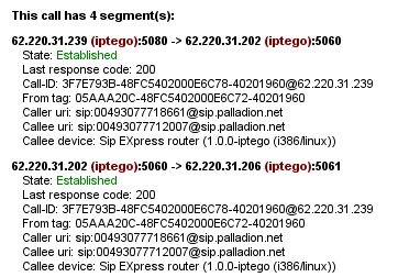

SBC/B2BUA Call Merging
Call merging across B2BUA devices is a crucial point for SIP troubleshooting. Operations Monitor can use a large set of criteria for matching the calls, has several easy-to-use presets, and can also combine the criteria in a very flexible way by using custom algorithm expressions.
For STP devices, a similar choice of options applies. For SGW devices, the only options are the default or custom matching algorithm.

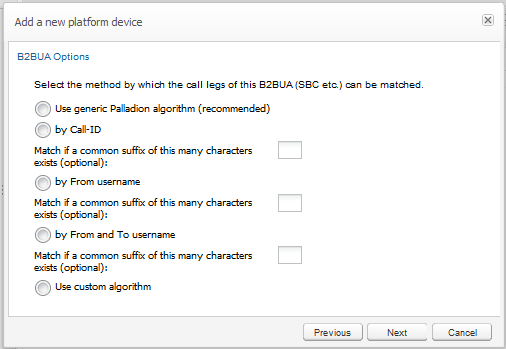

The wizard panel offers the high-level options shown in Figure 7-8 and described in Table 7-4:
Figure 7-8 Choosing the Call Matching Type for a B2BUA Device
Description of "Figure 7-8 Choosing the Call Matching Type for a B2BUA Device"
Table 7-4 B2BUA Device Options
| Option | Description |
Use generic OCOM/EOM algorithm  |
The algorithm was developed to accurately detect which call legs belong to the same call for the most common SBC/B2BUA configurations. The algorithm takes into account the time difference between the calls, the session-id from the SDP, the From and To users, the P-Asserted-Identity header, the Diversion header, etc. Oracle recommends using this option and to adjust if necessary. For more information about the generic algorithm, see "Call Merging Algorithms".  |
by Call-ID  |
To be used if the SBC/B2BUA is configured to copy the Call-ID header from the incoming call leg to the outgoing call leg. If the suffix parameter is given, then only the last suffix characters are compared. This is useful, for example, if the SBC/B2BUA only prepends a string to the Call-ID to make it unique.  |
by From username  |
To be used if the SBC/B2BUA is configured to keep the same From user between call legs, and this does not lead to false positives in most cases. If the suffix parameter is given, only the last suffix characters are compared. This is useful if the SBC/B2BUA only changes the prefix of the numbers (for example, from +49 to 0049).  |
by From and To username  |
To be used if the SBC/B2BUA is configured to keep the same From user and To user between call legs. If the suffix parameter is given, only the last suffix characters are compared. This is useful if the SBC/B2BUA only changes the prefix of the numbers (for example, from +49 to 0049).  |

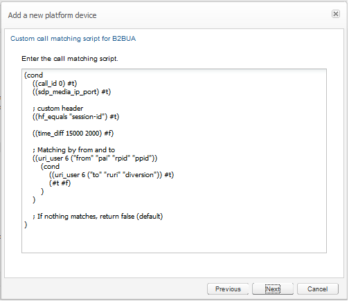

Use custom algorithm  |
This allows flexible combining available criteria for matching, ordered tests, and nested tests, as well as matching on arbitrary SIP headers. For more information on how to write a custom algorithm, see "Call Merging Algorithms". If this is selected, another wizard panel will be shown for entering the algorithm (see Figure 7-9). The Operations Monitor generic algorithm is pre-filled as a starting point.  |
Figure 7-9 Entering a Custom Match Algorithm
Description of "Figure 7-9 Entering a Custom Match Algorithm"

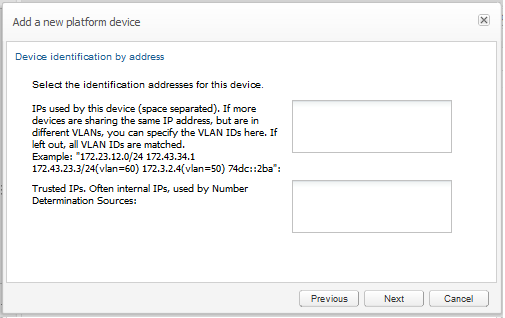

Device Identification
The devices are usually identified by only their IP addresses. Exceptions are the trunk devices, which can be also identified by the OTG and DTG parameters, and the set-ups in which the hardware addresses are significant. Either IPv4 or IPv6 addresses may be supplied. IP ranges with bitmasks smaller than 24 (for IPv4) or 120 (for IPv6) might impact performance significantly.
In the Device identification by address wizard panel, specify the identification addresses for the device you create. Enter the IPs used by the device in a list separated by spaces. If multiple devices share an IP address, but are in different VLANs, you can also specify the VLAN IDs.
You can specify VLAN IDs in multiple ways. You can enter:
IP(VLAN=x) with x>=0, which matches packets with VLAN ID x.
IP without a specified VLAN. The IP matches any packets, with or without a VLAN.
IP(VLAN=0) or IP(VLAN=off) which only matches packets with no VLAN. This restricts the IP to only non-VLAN packets.
Figure 7-10 Device Identification Settings
Description of "Figure 7-10 Device Identification Settings"

Figure 7-14 Platform Devices Settings - VQ Status
Description of "Figure 7-14 Platform Devices Settings - VQ Status"
If the VQ status displays the word "Partial" in red while associating a device with the VQ status, it implies there has been an issue causing the device counters to not match the VQ status. To resolve this issue, try setting VQ Status back to "No VQ" for the device using the Platform Device Settings page, and then again to "Full VQ" to re-add the VQ counter.

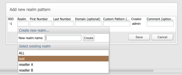

Figure 7-19 shows the panel used for defining realm patterns. Selecting a realm pattern and then clicking the toolbar Edit button, or double-clicking an entry opens an editing window. For an example, see Figure 7-18.
Table 7-5 describes the fields found in the Add new realm pattern table:
Table 7-5 Add a New Realm Pattern Fields
| Field | Description |
Rid  |
The ID of the realm.  |
Name  |
The name of the realm. The edit select menu of the field offers the previous used realms, but also allows entering a new name. By entering a new name and pressing the Create button, a realm with that name is created immediately.  |
First number  |
The first phone number from a number range realm. If this is specified, then the Last number must also be specified. The realm will contain all numbers from the range.  |
Last number  |
The last phone number from a number range realm. If this is specified, then the First number must also be specified. The realm will contain all numbers from the range.  |
Domain  |
The domain from a domain restricted realm. The realm will contain all the users from the given domain. This can be combined with the First number and Last number options in which case all restrictions apply. If the First number and the Last number are provided, the caller or callee number must be in the range between those values. If Domain (optional) is provided, then the number must be in between the First number and Last number. Additionally, the domain must match the value provided in the Domain field. Therefore, between First number, Last number, and Domain, there exists an AND relationship. The caller or callee information must fulfill all the conditions to be assigned to the realm.  |
Custom Pattern  |
Give a custom header pattern for matching of calls to this pattern. If a call's invite contains this header pattern then it is counted in the realm. For more information, see "unresolvable-reference.htm". You can also provide a Custom Pattern. For Custom Pattern, either the First number, Last number, and Domain OR the Custom Pattern must match. For a Custom Pattern, there exists an OR relationship.  |
Creator  |
The user who created this realm.  |
Comment  |
(Optional) Comment line, only for convenience.  |
In order for the domain restricted realms to work, Operations Monitor needs to be configured to consider the domains in the user identifiers. Set the Use User Domains to true. For more information, see "unresolvable-reference.htm".
Configuring a large number of realm patterns will affect the performance of the server.
Figure 7-18 The Add or Edit Realm Pattern Window
Description of "Figure 7-18 The Add or Edit Realm Pattern Window"
For example, the configuration from Figure 7-19 defines the realm reseller A to contain:
The phone number range 00491234000 to 00491234999, regardless of the domain name.
The phone number range 0301234000 to 0301234555, regardless of the domain name.
All users that have a.sip.palladion.net as their domain name.

Automatic Realm Pattern Import
You can create an external list of realm patterns and import the list into Operations Monitor. You can compose a list as a CSV file, upload the file by using FTP, and configure Operations Monitor to have the CSV file processed at a defined interval to import the realm patterns.
This is an alternate method of adding realms to Operations Monitor. Importing realm patterns from an external CSV file may be preferable if you have a large number of entries to add or if you make frequent changes to the realm definitions. See "unresolvable-reference.htm" for more information on adding realms using the Operations Monitor interface.
Caution:
Importing new realm patterns overwrites existing realm patterns. The import feature is not additive; rather, all numbers for all realms should always be present in the CSV file.
About Formatting the CSV File
Each line in the CSV file contains the realm name and the number pattern separated by a comma.
For example:
RealmName, NumberPattern
Assign each realm name and number pattern a unique value and order the list alphabetically. Only enter single number entries (even if there are number ranges belonging to the realm). Do not include duplicate entries. The import function of Operations Monitor compacts the numbers to the least possible amount of patterns by grouping them into the ranges.
Following is an example of a list of realm names and number patterns:
03940394, 444333222111 40404044, 404040404040 realmone, 133334444555 realmone, 133334444666 second, 12224444333
