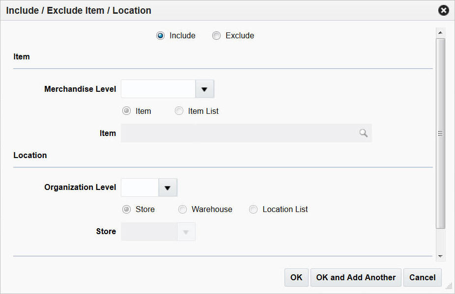

Finally, you define the items and locations where the deal can be applied. You can choose to include or exclude locations as necessary.

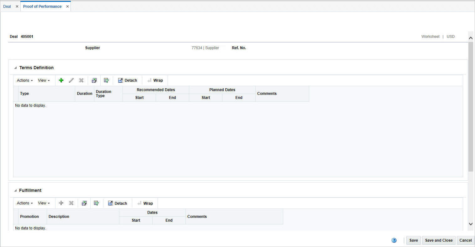

Additionally, you can define the proof of performance (POP) terms and expected deal income. You can define deal income only for bill back and rebate deals. POP terms are defined by the deal vendor that offers the deal. For deals, POP terms can be defined at the deal, deal/component, or deal component/item loc combination. For fixed deals, the POP terms are defined at the deal level.

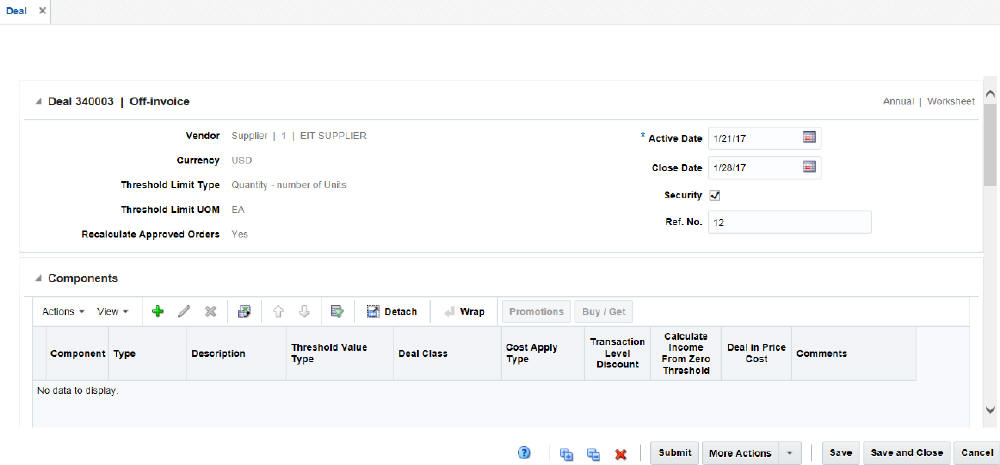

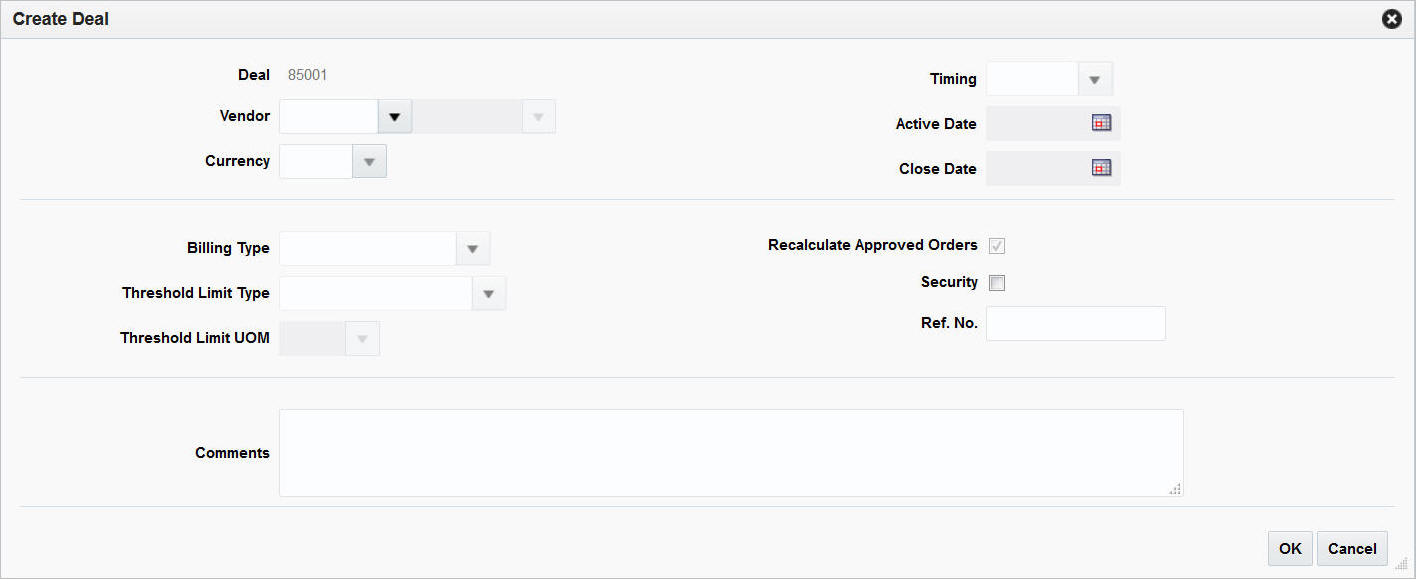

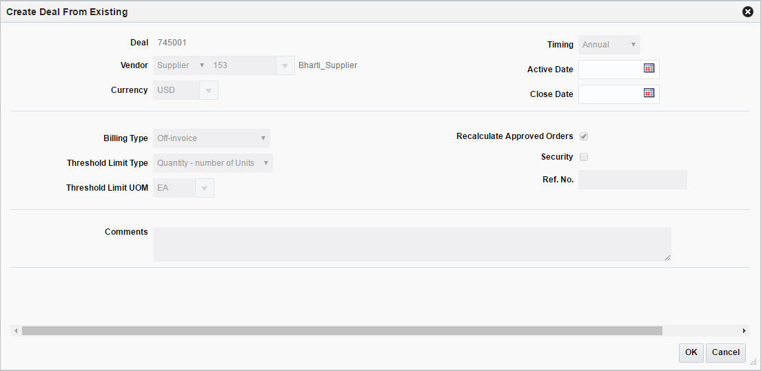

To create a deal:
From the Tasks menu, select Orders > Deals > Create Deal. The Create Deal pop-up appears.
The deal number is displayed by default.
In the Vendor field, select the vendor type, enter, select or search for the deal vendor.
In the Currency field, enter, select or search for the currency.
In the Timing field, select the timing of deal:
Annual: A yearlong deal you have with a deal partner. Only one annual deal can be applied to an item at a time. You close the deal manually when it expires, or the deal is closed automatically when you create another annual deal with the deal partner. On selection of Annual, the Billing Type gets defaulted to Off-invoice, and the field is disabled since this is the only possible type of annual deal.
Promotional: A deal that is generally shorter than an annual deal. Multiple an promotional deals can be applied to an item at the same time. The deal closes automatically on the specified end date. Bill Back, Vendor Funded Promotion, Vendor Funded Markdown, and Off-invoice can all be promotional deals.
In the Active Date field, enter the date on which the deal becomes active, or click the calendar icon and select the date.
In the Close Date field, enter the date on which the deal ends, or click the calendar icon and select the date.
This field is not required for annual deals.In the Billing Type field, select the type of deal being created.
If you select Annual in the Deal Timing field, Off-Invoice is the default for the Billing Type and cannot be changed.Off-Invoice: The deal is reflected as an amount decremented from the cost on the invoice.
Bill Back: The deal income amount is invoiced to the supplier after the goods are purchased. A special type of a bill back is a rebate, which can be calculated on sales, purchase orders or receipts.
In the Threshold Limit Type field, select the type of threshold limit type. Certain deal types such as Off-invoice and Bill Backs allow the tracking of the threshold limit in terms of units or an amount.
In the Threshold Limit UOM field, select the UOM. If units are selected as Threshold Limit Type, you also need to define the Unit of Measure (UOM) that the threshold tracks. It will be disabled otherwise. For PO specific deals, if the Transaction Level Discount is set to Y, the threshold limit type is always Amount.
Select the Recalculate Approved Orders check box. This is only applicable to an Off-invoice deal. This indicates whether approved orders should be recalculated based on the current deal parameters and applies only in case of an off invoice deal. If this is checked, any approved order currently in the system that meets the deal criteria is recalculated based on the new deal once it is approved.
Select the Security check box. This indicator is used to implement user based security for the deal that is currently being created. In case this has been set for a deal, the deal details can be viewed or edited only by users who have the same or higher privileges compared to the deal creator.
In the Ref. No. field, enter a number.
In the Comments field, enter any additional comments as necessary.
Click OK to save any changes. The Deal page appears.
Click Cancel to return to the Tasks menu without saving changes.
You can also create a deal by clicking Create in Actions menu, or by clicking the Create iconThe Deal Header includes the following fields.

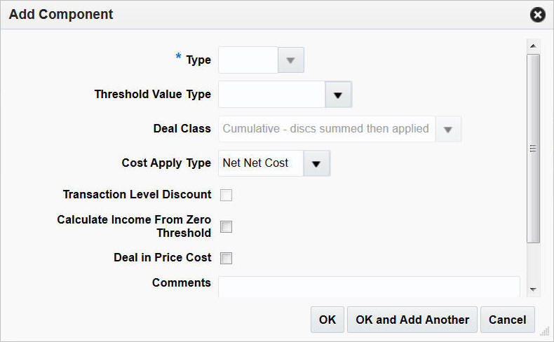

To add deal components:
Enter the relevant data and click OK to save the changes. The Deal page appears.
In the Deal page, go to the Components section.
From the Actions menu, click Add or click the Add icon
. The Add Component pop-up appears.
In the Type field, select the component type.

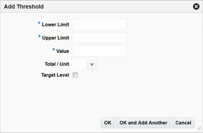

In the Threshold Value Type, select the threshold value type. This field is used to capture the incentive type that would be received on attaining the threshold limit of the deal. The options are amount off per unit, percentage off per unit, get units for fixed price or buy/get free or discounted items.
For an off-invoice deal, in the Deal Class field, select the way in which calculations would be performed in case of multiple deal components. The options are Cumulative, Cascade, or Exclusive.
For a Bill Back, Vendor Funded Promotion, and Vendor Funded Markdown this field will default to Cascade and cannot be changed.In the Cost Apply Type field, select how the deal component is used to calculate future costs. The options are Net Cost, Net-Net Cost or Dead Net Cost. The details such as Cost Apply Type is defaulted to Net Cost and can be overridden.
The value in this field is defaulted based on the type of deal you selected, but can be changed.Select the following check boxes:
Transaction Level Discount - This check box applies to PO-specific off-invoice deals. If this check box is selected on the screen, the deal component applies to an entire PO, receipt or sale transaction. This field can only be selected if the vendor is a supplier. Because these deals apply to the entire order, items and locations are not added to transaction level deals.
Calculate Income From Zero Threshold - This check box is not applicable for off-invoice deals. This indicator is used in cases where the vendor has specified that a minimum threshold needs to be reached before a discount applies and when that threshold is reached, the discount applies against the entire threshold, including the level below the threshold.
Deal in Price Cost - This indicator defines whether the deal is to be used in the pricing cost calculation used by Price Management to determine the margin on the items linked with the deal.
Then choose one of the following options.
Click OK to add the deal component.
Click OK and Add Another to add more deal components.
Click Cancel to return to the Deal Page.

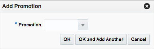

The Promotions pop-up allows you to view a component of a deal with promotions. You can attach multiple promotions to a deal component. The promotion is set up in the pricing system and can then be attached to the deal component.

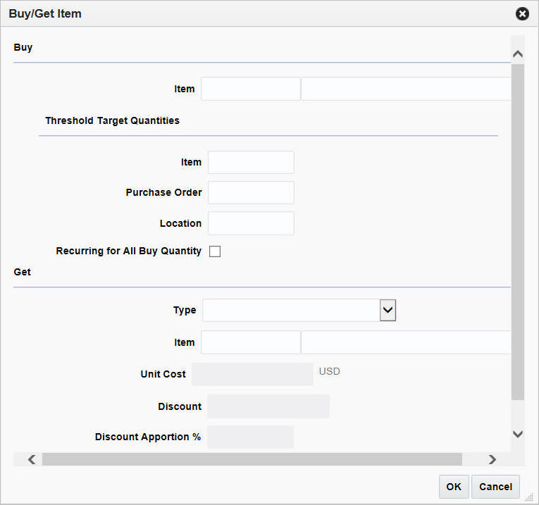

The Buy/Get Item pop-up is only enabled, if Threshold Value Type selected is Buy/Get free or discounted items for off-invoice deals.
To add buy/get item:
Click Buy/Get Item from the Components section. The Buy/Get Item pop-up appears.
The Buy/Get Item pop-up consists of the following three sections:
Buy
In the Item field, enter or search an item using the search icon. It identifies the item that must be purchased for a quantity threshold-type discount.
Threshold Target Quantities
In the Item field, enter an item threshold target quantity for the buy item that must be ordered to qualify for the free item.
In the Purchase Order field, enter the threshold target quantity for all locations on the purchase order which the buy item is part of. This is the target level that will be used for future calculation of net cost.
In the Location field, enter threshold target quantity which is the average targeted purchase level per location on the deal. This value will be used in future cost calculations.
Select the Recurring for All Buy Quantity check box. This indicates if the quantity threshold discount is only for the first buy amount purchased (example, for the first ten purchased, get one free), or if a free item will be given for every multiple of the buy amount purchased on the order (example, for every ten purchased, get one free).
Get
In the Type field, select the Get type from the list. Valid options are free, percent, amount or fixed amount.
In the Item field, enter or search for an item using the search icon. This identifies the get item for a quantity threshold-type (buy/get) discount.
In the Unit Cost field, enter the amount. This will be enabled if the Get type selected is Free and identifies the unit cost of the threshold free item that will be used in calculating the prorated quantity discount. It will default to the item/supplier cost, but can be modified based on the agreement with the supplier.
In the Discount field, enter a value. This will be enabled in case Get type is not 'Free'. It will be percent in case get type is Percent otherwise value.
In the Discount Apportion % field, enter a value. This specifies the percentage of the total discount that should be apportioned from the get items unit cost for off invoice deals where buy item is not the same as the get item and Get type is Free. The remaining will be apportioned from the buy item unit cost.
In the Threshold Quantity field, enter a value. This identifies the quantity of the identified get item that will be given at the specified get discount if the buy amount of the buy item is purchased.
Click OK to add the buy/get item information.
Click Cancel to return to the Deal page.
To edit a deal component:
Select the deal component you want to edit.
From the Actions menu, click Edit or click the Edit icon
The Edit Component pop-up appears.
Edit the enabled fields as necessary.
Click OK to return to Deal page.
Click Save or Save and Close to save the changes.
To delete a component:
Select the deal component you want to delete.
From the Actions menu, click Delete or click the Delete icon
You are prompted to delete the deal component.
Click Yes to confirm deletion.

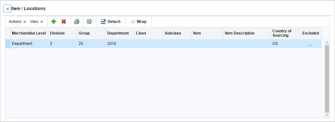

On the Item/Locations section, you can select the items to which the deal components are applied. You can also specify specific locations for the items. Items and items at specific locations can also be excluded from deal component.
The item/location information is set up per component.
You can customize the view of the table by using the options in the View Menu. For information about this menu, see below and see ”View Menu” in the Oracle Retail Merchandising Foundation Cloud Service Do the Basics User Guide.
Table 4-3 Item/Locations - View Menu/Icons and Description
| View Menu List | Description |
Saved Views |
Saved views are predefined arrangement of table columns to provide certain specific information by using default and optional columns and is different from the default view. The views available are Merchandise Hierarchy, Organization Hierarchy, and Item Level. For every record you can choose respective saved view to see information related to merchandise hierarchy, organization hierarchy, or item level. |
You can add item/locations to a deal component while creating or editing in the Deal page.
To add the item/locations of a deal:
In the Deal page, go to Item/Locations section.
. The Include/Exclude Item/Location pop-up appears
Select the include or exclude option to determine if the record is being created for inclusion or exclusion.
In the Item section, select the merchandise level from the Merchandise Level list. Choose the appropriate option to add an item by Item or Item List.
In the Location section, select the organizational level from the Organizational Level list. Choose the appropriate option to add location by Store, Warehouse, or by Location List.
Click OK to add the item/location.
Click OK and Add Another to add more item/locations.
To delete an item/location:
Select the item/location you want to delete.
Click Cancel to retain the record.

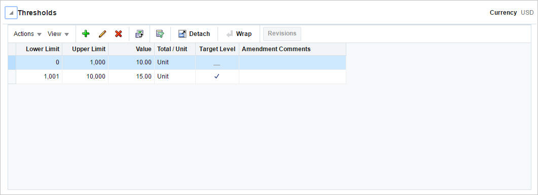

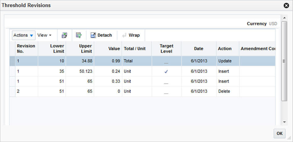

On the Thresholds section, you can specify the lower and upper limits that need to be reached in order to receive the benefits that are defined as part of the current deal. Multiple thresholds or bands can be defined for a deal. If the threshold value type that was defined for the deal component is set to Amount Off, you have the option to select whether the specified amount needs to be applied per unit or as a total value for the entire threshold band. For example, a vendor might offer the retailer a discount of $1 per unit or a total discount of $50 on buying in excess of 100 quantities. Each component added to the deal can be used as the target level around which cost calculations need to take place. You must indicate the threshold band that is to be treated as the targeted level for a deal component. This threshold band is then used for the future cost and pricing cost calculations.
You can add thresholds to a deal component while creating or editing in the Deal page.
To add the thresholds of a deal:
In the Deal page, go to Thresholds section.
. The Add Threshold pop-up appears.
In the Lower Limit field, enter the value of the lower limit of the deal component. This is the minimum value that must be met in order to get the specified discount. This value will be either a currency amount or quantity value, depending on the threshold limit type of this deal component.
In the Upper Limit field, enter the value of the upper limit of the deal component. This is the maximum value for which the specified discount will apply. This value will be either a currency amount or quantity value, depending on the threshold limit type of this deal component.
In the Value field, enter the value of the discount that will be given for meeting the specified thresholds for this deal component. This value will be either a currency amount or quantity value, depending on the threshold limit type of this deal component.
In the Total/Unit field, select the total or unit. It indicates if the value for deal components for which the threshold type is amount off is amount off by unit or in total.
Select the Target Level check box. This indicates if a threshold level is the targeted purchase or sales level for a deal component. This indicator will be used for cost calculations.
Click OK to add thresholds. You can add more thresholds by clicking OK and Add Another.
Click Cancel to return to the Thresholds section.
To edit the threshold of a deal:
Select the threshold you want to edit.
The Edit Threshold pop-up appears.
To delete the threshold:
Select the threshold you want to delete.
You are prompted to delete the record.

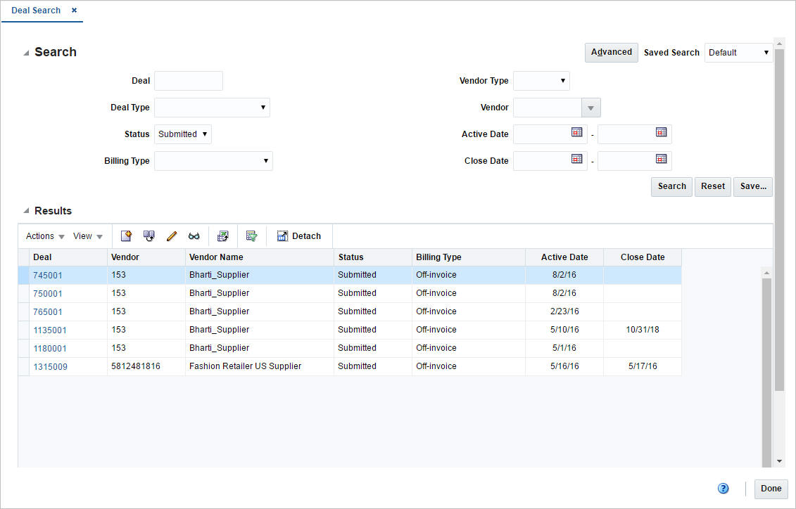

On clicking the Manage Deal link by selecting Orders > Deals > Manage Deal, the Deal Search page appears.
In the Deal Search page you can search for deals by specifying various search criteria. You can choose to access deals in the search results in edit or view mode depending on security privileges. There are also options for creating a new deal or creating a new deal from existing.
The Deal Search page includes the following sections:
Search
For more information on the Deal Search page, see the Search for a Deal section.
To search for a deal:
From the Tasks menu, select Orders > Deals > Manage Deal. The Deal Search page appears.
You can search for a deal by providing search criteria in the search section. The criteria can be provided either in Basic or Advanced mode, depending on the requirement. Basic is the default mode when the search page is entered. Click Advanced to access the search panel in advanced mode. You can return to Basic mode by clicking Basic.
To search for a deal through the basic search criteria:
Enter or select one or all of the following basic search criteria.
Table 4-4 Deal Search - Basic Search Criteria
| Fields | Description |
Deal |
Enter the deal ID. |
Deal Type |
Select the deal type. The options are: Annual, Promotional, PO Specific, Vendor Funded Markdown. |
Status |
Select the status of the deal. The options are: Worksheet, Submitted, Approved, Rejected, Closed. |
Billing Type |
Select the type of deal being created. The options are Off Invoice, Bill Back, Bill Back Rebate, Vendor Funded Promotion, Vendor Funded Markdown. |
Vendor Type |
Select the vendor type. |
Vendor |
Enter, select or search for the vendor. |
Active Date |
Enter the date on which the deal becomes active, or click the calendar icon and select the date. |
Close Date |
Enter the date on which the deal ends, or click the calendar icon and select the date. |
You can also click the Saved Search drop down to select one of the saved sets of search criteria. Selecting a saved search will populate the criteria section with saved criteria. If the saved search is selected to run automatically then the search will be executed too.
You can also choose to manage and personalize the saved searches by clicking Personalize in the list. The Personalize Saved Searches page appears.
For more information on the Personalize Saved Searches, see Personalize Saved Search in the Oracle® Retail Merchandising Foundation Cloud Service Do the Basics User Guide.
Click Search. The deals that match the search criteria are displayed in the Results section.
Click Reset to execute the saved search.
Click Save. to save the current set of search criteria as a Saved Search. The Create Saved Search pop-up appears.
For information on the Create Saved Search pop-up, see Create Saved Search in the Oracle® Retail Merchandising Foundation Cloud Service Do the Basics User Guide.
Click Done to close the pop-up.

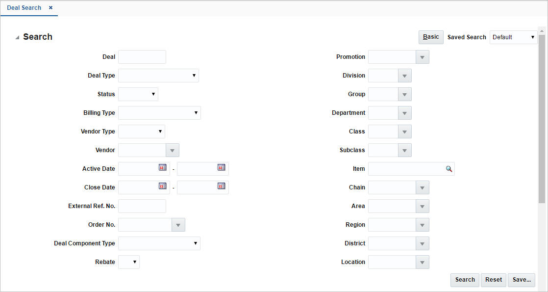

To search for a deal through the advanced search criteria:
Enter or select one or all of the following advanced search criteria.
Table 4-5 Deals Search - Advanced Search Criteria
Deal |
Deal Type |
Status |
Billing Type |
Vendor Type |
Vendor |
Active Date |
Close Date |
Enter the date on which the deal ends, or click the Calendar icon and select the date. |
External Ref. No. |
Enter the external reference number. |
Order No. |
Enter, select or search for the order number. |
Deal Component Type |
Select the deal component type. |
Rebate |
Select Yes if the rebate is included in the deal or select No if the rebate is not included in the deal. |
Promotion |
Enter, select or search for the promotion from the list. |
Division |
Enter the division number, select or search for the division name and number. |
Group |
Enter the group number, select or search for the group name and number from the list. |
Department |
Enter the department number, select or search for the department name and number from the list. |
Class |
Enter the class number, select or search for the class name and number from the list. |
Subclass |
Enter the subclass number, select or search for the subclass name and number from the list. |
Item |
Enter the item number, or search by using the search icon. |
Chain |
Enter the chain number, select or search for the chain name and number from the list. |
Area |
Enter the area number, select or search for area name and number from the list. |
Region |
Enter the region number, select or search for the region name and number from the list. |
District |
Enter the district number, select or search for the district name and number from the list. |
Location |
Enter the location number, select or search for the location name and number from the list. |
To narrow down the search, use the list next to the search fields. For example, determine if the entered value should equal or not equal the search result.
Click on the Saved Search list to select one of the saved search criteria. Selecting a saved search populates the search section with the saved search criteria. If the run automatically function is enabled for the search, the search is executed immediately.
You can also personalize your saved searches by selecting Personalize. The Personalize Saved Searches page appears.
For more information about the Personalized Saved Search, see Personalize Saved Search in the Oracle® Retail Merchandising Foundation Cloud Service Do the Basics User Guide.
Click Reset to clear the search section and results.
Click Save As... to save the current search criteria. The Create Saved Search pop-up appears.
For more information about how to save your search criteria, see Create Saved Search in the Oracle® Retail Merchandising Foundation Cloud Service Do the Basics User Guide.
Click Done to close the page.

To create a deal, follow the steps below.
From the Actions menu, select Create or click the Create icon
. The Create Deal page appears.
For more information on how to create a deal, see the Create a Deal section

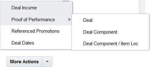

Use the More Actions menu to navigate to the following pages. The More Actions menu contains the following options.
Table 4-6 Deal - More Actions Menu and Description
| Action Buttons | Description |
More Actions |
You can navigate to open the following pop-ups by clicking More Actions menu: You can navigate to the following pop-ups from the More Actions menu:

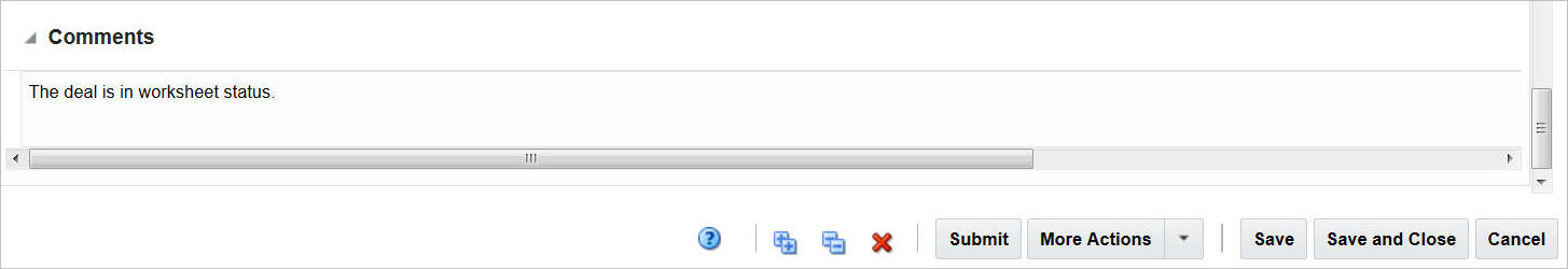

When a deal is added to the system, it must go through a series of checks before it is accessible in the system. Depending on your user role, you may not be able to move the deal to the next status. A deal may be in any of the following statuses:
Table 4-7 Deals Approval Process Status
| Status | Definition |
Worksheet |
The deal has been started, but not completed. |
Submitted |
The deal has been completed and is pending review. |
Approved |
The deal has been reviewed and has been approved. |
Rejected |
The deal has been submitted, reviewed, and has been rejected. |
Closed |
The deal is complete. |
You can submit a deal when a deal is created and the deal is in Worksheet status.
To submit a deal:
In the Components section, select Actions > Add or click the Add icon
You need to enter the required information in the following sections before submitting a deal:Components
Item/Locations
Thresholds
Enter all the required information and click Submit on the page level toolbar. The deal status changes to Submitted.
Click Save to save your changes or click Save and Close to save and close the page.
Click Cancel to discard the changes and close the Deal page.
Item/Locations
Thresholds
Enter all the required information and click Submit on the pop-up level toolbar. The deal status changes to Submitted.

To reject a deal:
In the Status field, select the deal in Submitted status and click Search.
The deals that are in Submitted status are displayed in a table in the Results section.
Select the deal that you wish to reject.
Select Actions > Edit or click the Edit icon
Click Reject. The status changes to Reject.
Click Cancel to return to the Deal Search page.

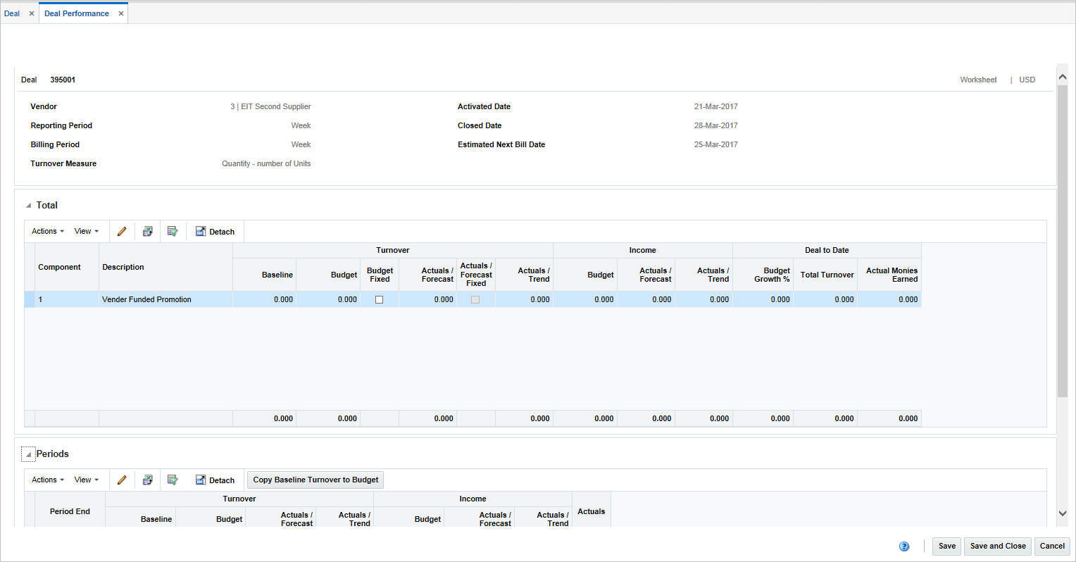

The Deal Performance page allows you to maintain forecasts for a deal, view period by period performance, and compare the actual deal performance against the actual forecasts.
As actuals are accrued, you can view the actual performance of the deal, at the component level, against the forecasted performance of the deal.
To view deal performance:
From the Tasks menu, select Orders > Deals > Create Deal. The Create Deal page appears.
From the More Actions menu, click Deal Income.
The Deal Performance page appears, which includes Total and Periods section. For more information on Total and Periods, see the Totals and the Periods section.

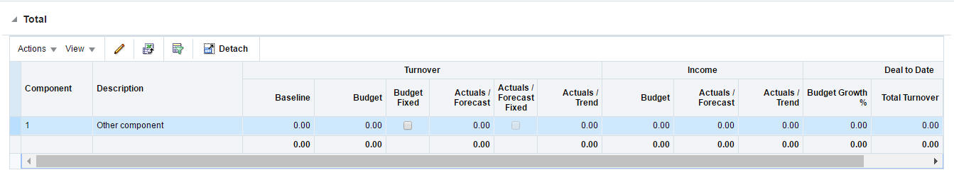

The Total section displays the turnover and income values for deal components for all the valid periods. For turnover it has baseline, budget and actual values. It also shows if turnover totals are designated fixed for distribution among periods. For income it shows budget, actual/trend and actual/forecast values. In addition it also shows Budget Growth %, Total Turnover and Actual Monies Earned with respect to total deal to date.

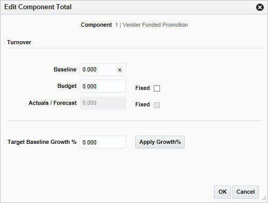

To edit total of a deal component:
From the More Actions menu, click Deal Income. The Deal Performance page appears, which includes the Total section.
. The Edit Components Total pop-up appears.
In the Baseline field Turnover sub section, enter or edit the previous year's turnover.
In the Budget field Turnover sub section, enter or edit the expected amount of turnover.
In the Actuals/Forecast field Turnover sub section, enter or edit the actuals or forecast amount.
When the budget turnovers are set, select the Fixed check box to the right of the Budget field. Setting the budget Fixed signifies that the total value for the component will remain fixed despite any change in the value specific to any period. Any change will be divided over the other periods. If this is selected than you will not be able to apply growth % over the baseline to populate budget.
Fixed can be checked against Actual/Forecast as well.In the Target Baseline Growth % field, enter the percentage you expect the baseline to grow.
Click Apply Growth%.
Click OK to save any changes and close the pop-up.
Click Cancel to discard the changes and close the pop-up.
Once a deal is approved, you can change only forecast values. Before that Baseline can also be changed.This applies for both total and periods section.

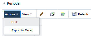

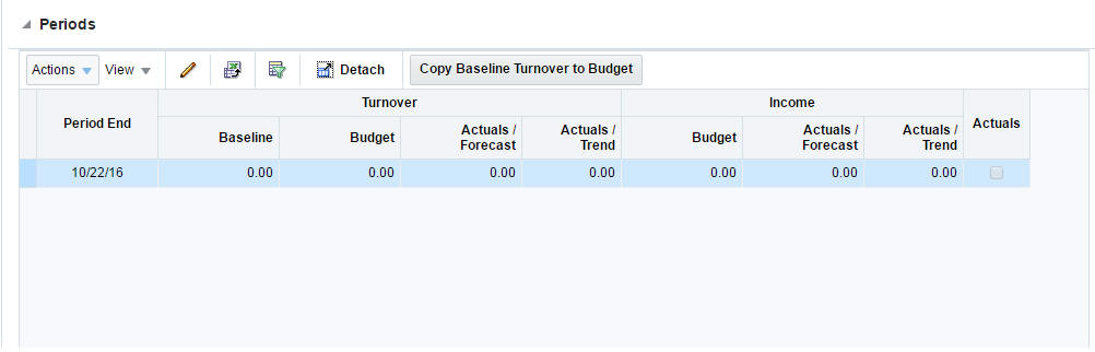

The periods table shows the performance data for deal components broken down by deal reporting periods. The period end column displays the end date of the deal reporting period. You can enter or edit budgeted and baseline turnover for a particular period in this table.
Use the Actions Menu and icons to apply actions to the table. You can perform actions listed below, as well as the actions described in the ”Action Menu and Icons” section in the Oracle Retail Merchandising Foundation Cloud Service Do the Basics User Guide.

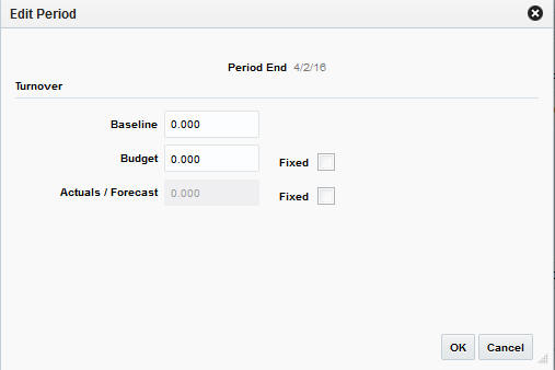

To edit periods of a deal component:
From the More Actions menu of the Deals page, click Deal Income. The Deal Performance page appears, which includes the Periods section
. The Edit Period pop-up appears.
The total check boxes are view only. They would be checked if the totals for them have been checked fixed in the totals table.
You can access the Proof of Performance page from the Deals page, More Actions > Proof of Performance. You can access Proof of Performance (POP) page at one of the following levels through the POP sub menu:
Deal
Deal Component
Deal Component/Item Loc
The POP page is used to define the performance requirements at the deal level, component level, or at the item/location level. This allows the buyer to identify what needs to be done in order to receive the deal discount, which might be an advertisement, coupon distributions or ’in store' demonstrations of the product. POP terms are used only for informational purposes in Merchandising.
You can select the level at which you want to view, create, or edit for Proof of Performance definitions and fulfillment information. The options are: Deal, Deal/Component, Deal Component Item/Loc.
To view/create/edit proof of performance:
From the More Actions menu of the Deal page, click Proof of Performance, and then click Deal or Deal Component or Deal Component/Item Loc depending on which level you want to define proof of performance.
The Proof of Performance page appears, which includes Terms Definition and Fulfillment sections.
For more information on Terms Definition and Fulfillment, see the Add Proof of Performance Terms Definition and the Add Proof of Performance Fulfillment section.
The Proof of Performance Header includes the following fields.
Table 4-10 Proof of Performance Header - Fields and Description
Title |
The title displays Deal ID and Deal Number to the top left of the head container. The Deal Status and the Currency is displayed with a separator between them to the top right of the head container. The deal number is populated by default. The supplier number, name, and the reference number are displayed. |

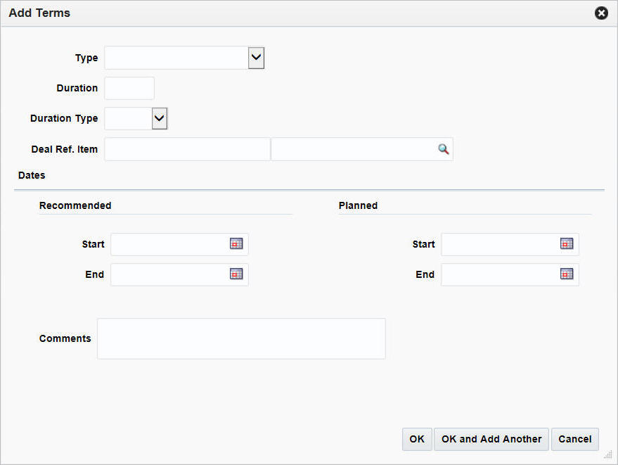

To add terms proof of performance definition:
From the More Actions menu of Deals page, click Proof of Performance, and then click Deal Performance.
The Proof of Performance page appears, which includes the Terms Definition section.
. The Add Terms pop-up appears.
In the Type field, select type of performance term.
In the Duration field, enter the duration for the duration type for which the terms will be valid.
In the Duration Type field, select the period of time that you have to comply to the terms of the deal.
In the Deal Ref. Item field, enter the deal reference item or search for and select the deal reference item.
In the Recommended Start and End date fields, enter the vendor's recommended start and end dates or click the calendar icon and select the dates.
In the Planned Start and End date fields, enter the date you intend to start and end complying or click the calendar icon and select the dates.
Click OK to save the changes and return to Proof of Performance page.
Click OK and Add Another to add more terms.
Click Cancel to reject all entries and close the pop-up.

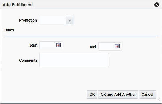

The fulfillment section is used to record or view proof of performance term fulfillment for a deal.
To add proof of performance fulfillment:
From the More Actions menu, click Proof of Performance, and then click Deal Performance.
The Proof of Performance page appears, which includes the Fulfillment section.
Fulfillments are specific to terms. You can add fulfillment only after you have added terms definition.From the Actions menu, click Add or click the Add icon
. The Add Fulfillment pop-up appears.
In the Promotion field, enter, select or search for a promotion.
In the Dates area:
In the Start Date field, enter the start date of the promotion, or click the calendar icon and select a date.
In the End Date field, enter the end date of the promotion, or click the calendar icon and select a date.
Click OK to add fulfillment. You can add more fulfillment by clicking OK and Add Another.
Click Cancel to close the fulfillment pop-up.

The Referenced Promotions option opens the Deal Promotions. This page allows you to associate a deal with a promotion. Multiple promotions can be attached to a deal. The promotion is set up in the pricing system and can then be attached to the deal.
To add promotions to a deal:
From the More Actions menu, click Referenced Promotions.
The Deal Promotions pop-up appears.
. The Add Promotions pop-up appears
You can add more promotions by clicking OK and Add Another.
Click Save to save your changes or click Save and Close to save and close the pop-up.

The threshold revisions pop-up is visible when revisions exist for a threshold.
To view the threshold revisions pop-up:
In the Deal page, go to Thresholds section and then click Revisions. The Threshold Revisions pop-up appears.

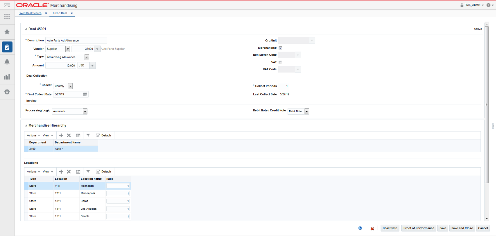

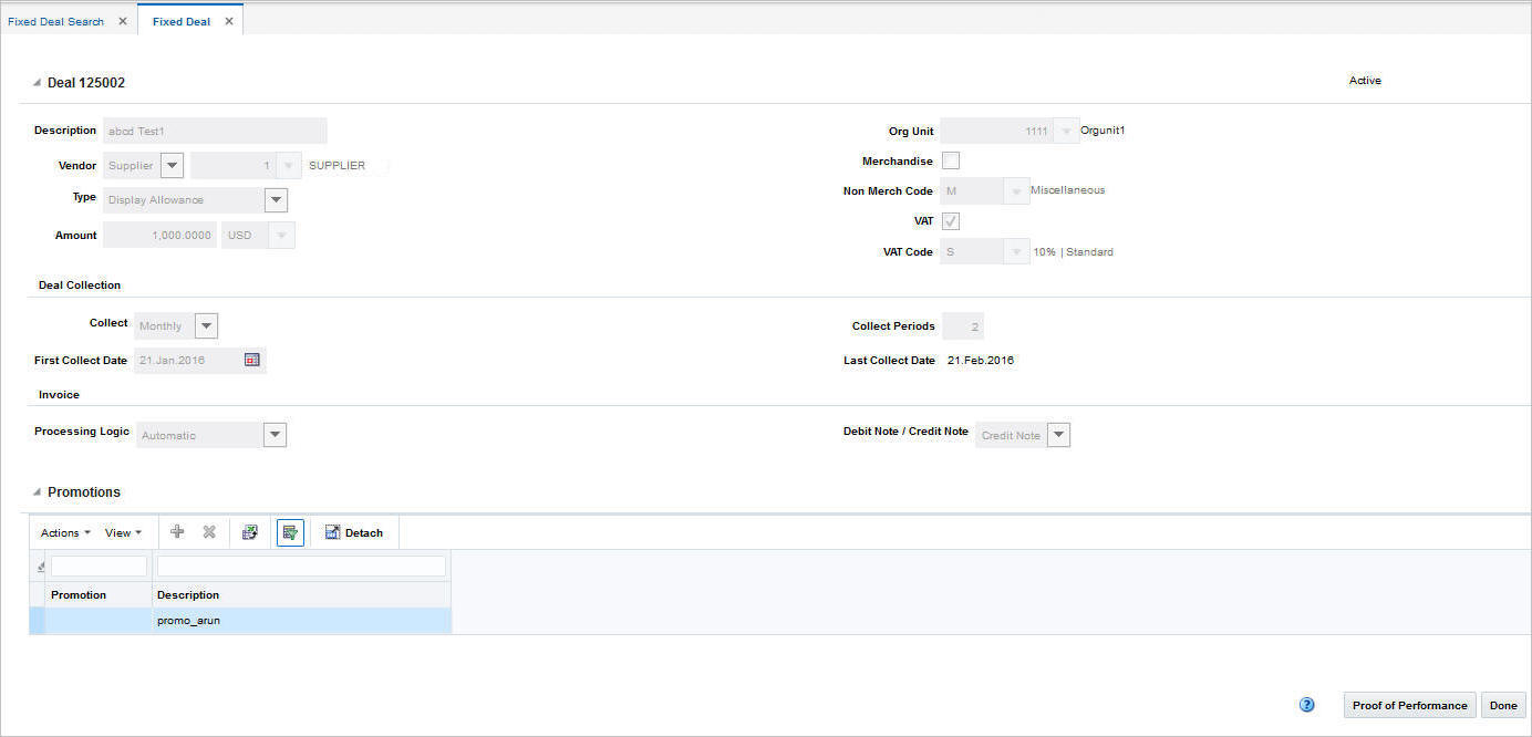

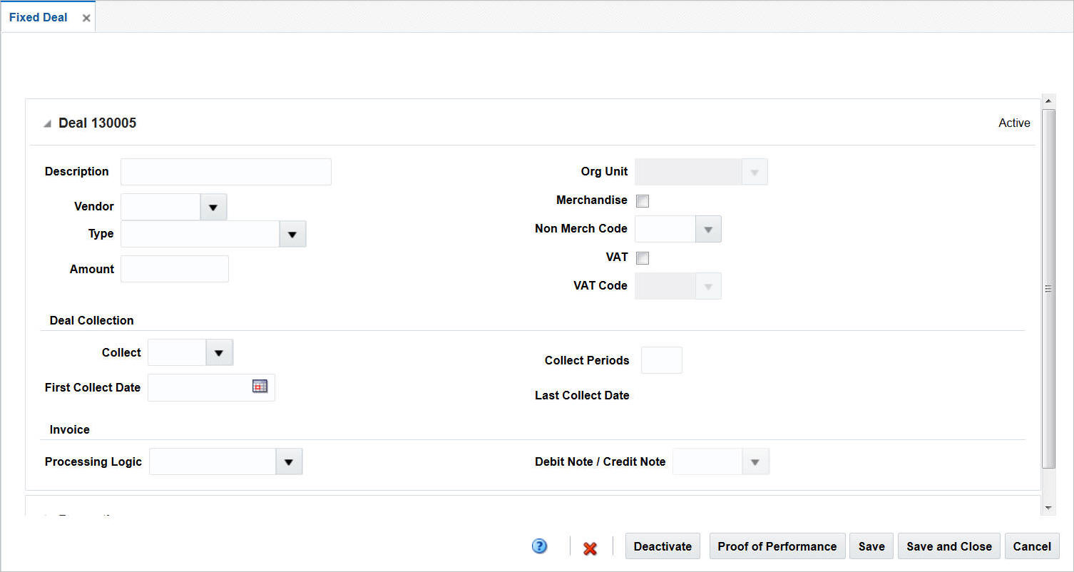

The Fixed Deal page allows you to define the following deal specific information:
Deal details
Merchandise hierarchy against which deal can be claimed
Location information at which deal can be claimed
Promotion Details against which supplier has negotiated the deal
You can also define the terms and fulfillment that is negotiated with the vendor. This information can be entered through Proof of Performance page which is displayed by clicking the Proof of Performance button on the Fixed Deal page.
With fixed deals, your organization receives payments from vendors in return for mentioning their products in promotions or for displaying their products on prime shelf space. Fixed deal payments can be claimed from the vendor either periodically or all at once.
You can create fixed deals and set up a collection schedule, from which you can make claims against the vendor and receive payments.
Fixed deals are typically created in Active status; however, you can create a fixed deal in Inactive status. For deals with Inactive status claims are put on hold.
The Fixed Deal Report provides you with information about active claims. Claim information for inactive fixed deals is not included in the report.
You can also create a fixed deal by clicking Create in the Actions menu, or by clicking the Create iconThe Fixed Deal page includes the following sections:
Deal Collection
Invoice
If the deal is associated to the merchandise hierarchy, then the Merchandise Hierarchy section appears.
This section appears if you select Merchandise in the Deal header section.

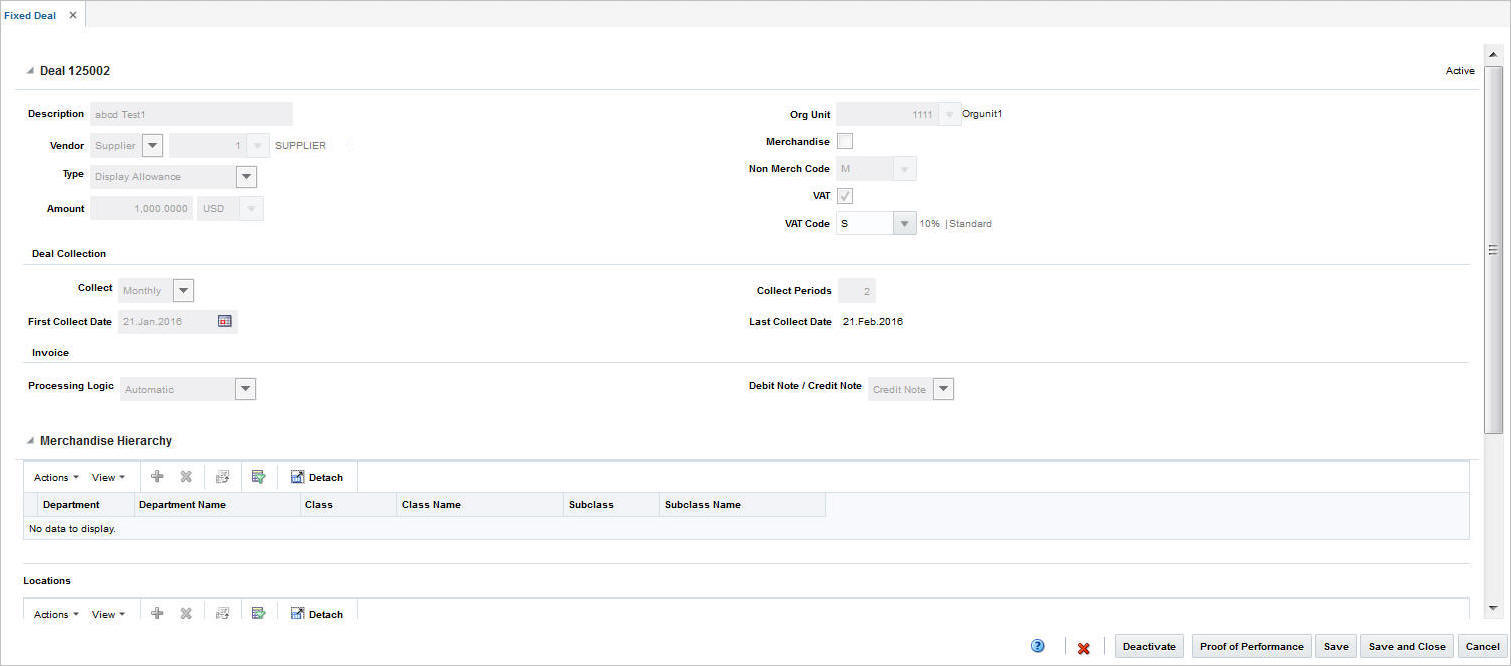

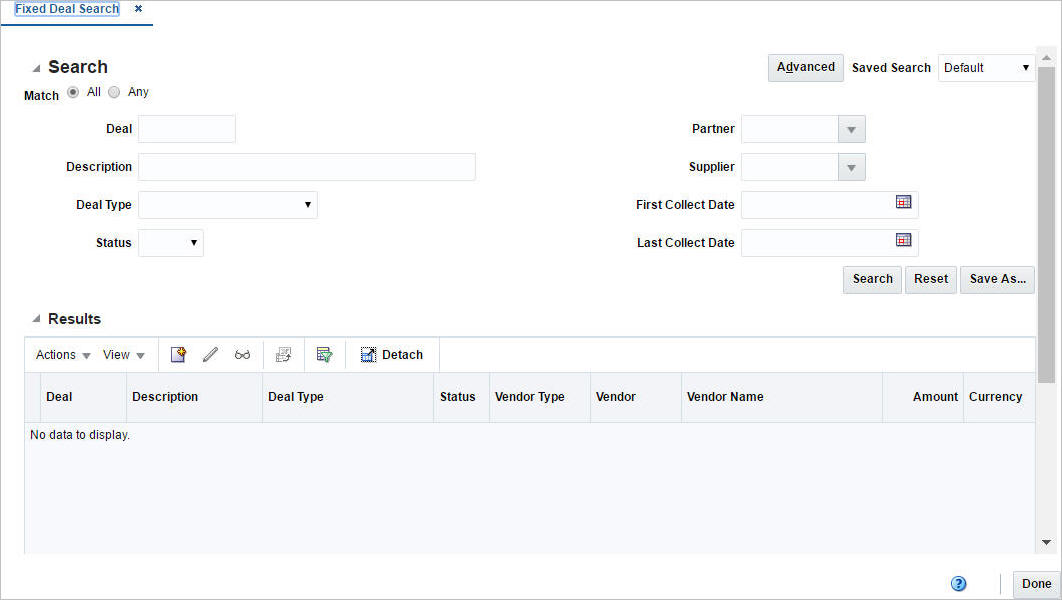

To create a fixed deal:
From the Tasks menu, select Orders > Deals > Manage Fixed Deal. The Fixed Deal Search page appears.
. The Fixed Deal widow appears.
For more information on how to create a fixed deal, see the Create a Fixed Deal section.
The Fixed Deal Header includes the following fields.
Table 4-11 Fixed Deal Header - Fields and Description
Title |
The title displays Fixed Deal ID to the top left of the head container. The Deal Status is displayed to the top right of the head container. This field contains the deal number by default. |
Description |
Enter a description of the fixed deal. |
Vendor |
Select or search for the type of fixed deal vendor. |
Type |
Select the type of payment. |
Amount |
Enter the payment amount from the supplier. |
Org Unit |
Enter, select or search for an organizational ID. |
Merchandise |
If the deal is associated to the merchandise hierarchy, select the Merchandise check box. For more information on Merchandise Hierarchy, see Merchandise Hierarchy. |
Non Merch Code |
Enter, select or search for the non merchandise code. The Non Merch field is required only if the Merchandise check box is not selected. |
VAT |
If VAT is included in the deal, select the VAT check box. |
VAT Code |
Enter, select or search for the VAT code to apply to the fixed deal. |
Deal Collection section: |
Collect |
Select how often payment for the fixed deal is collected from the supplier. If you select Date in the Collect field, the number of collection period is always one. |
First Collect Date |
Enter the date, or click the calendar icon and select the date. The date of the collection of the first amount decided as part of the fixed deal. |
Collect Periods |
Enter the number of collection periods. |
Last Collect Date |
If you enter the date in the First Collect Date field, the Last Collect Date field is displayed by default. The number of times the collection date is to be repeated after the First Collect Date. On each collection date an invoice may be raised based on the invoicing options selected for the deal. |
Invoice section: |
Processing Logic |
Select how invoices are created for the fixed deal. The options of creating invoices are: Automatic, Manual, No Invoice Processing depending on the option selected. |
Debit Note/Credit Note |
Select whether you want to send a Debit or Credit Note request to the supplier. |
The merchandise hierarchy allows you to create the relationships that are necessary in order to support the product management structure of a company. You can assign a buyer and merchandiser at the division, group, and department levels of the merchandise hierarchy. You can also link a lower level to the next higher level. For example, you can indicate which group a department belongs to or which division a group belongs to.
The location section appears if you select Merchandise in the Deal header section.

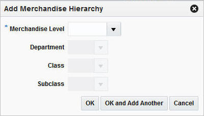

To add merchandise hierarchy:
In the Fixed Deal page, go to Merchandise Hierarchy section.
From the Actions menu, select Add or click the Add icon
. The Add Merchandise Hierarchy pop-up appears.
In the Merchandise Level field, click the merchandise level list and select the merchandise level that the deal applies to. This field is a required field.
In the Department field, select or search for the department.
In the Class field, select or search for a class.
In the Subclass field, select or search for a subclass.
Click OK and Add Another to add additional merchandise hierarchies.
To delete merchandise hierarchy:
Select the merchandise hierarchy you want to delete.
From the Actions menu, select Delete or click the Delete icon

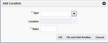

The Locations section allows you to indicate at which locations the deal is effective.
You can create locations when a fixed deal is created in the Fixed Deal page.
To create the locations to a fixed deal:
In the Fixed Deal page, go to Locations section.
From the Actions menu after entering the header details, click Create or click the Create icon
. The Add Locations pop-up appears.
In the Type field, select the location type you want to add to the fixed deal. This field is a required field.
In the Location field, enter, select or search for the location. You can also search for a location through Basic or Advanced search.
In the Ratio field, indicate what percentage of fixed deal the location contributes.
Click OK to add the location to the table and close the pop-up.
Click OK and Add Another to add additional locations.
To delete locations:
Select the locations you want to delete.
You are prompted to delete the locations.

To create a deal from an existing deal, follow the steps below.
From the Actions menu, select Create from Existing or click the Create from Existing icon
. The Create from Existing pop-up appears.
Click OK to create a deal from an existing deal.
Click Cancel to return to Deal Search page.
The Manage Fixed Deals option opens the Fixed Deal Search page. Managing a fixed deal involves performing one or more of the following tasks:
Searching for a fixed deal
Creating a fixed deal
Editing a fixed deal
Viewing a fixed deal
On clicking the Manage Fixed Deal link by selecting Orders > Deals > Manage Fixed Deal, the Fixed Deal Search page appears.
In the Fixed Deal Search page you can search, add, create, view, export to Excel, query by example, and detach deals. You can also create deals for items on a specific purchase order.
The Fixed Deal Search page includes the following sections:
Search
For more information on the Fixed Deal Search page, see the Search for a Fixed Deal section.
To manage a fixed deal use the Actions menu, View menu and icons in the Merchandise Hierarchy section.
You can access the Terms Definition and Fulfillment sections by clicking the Proof of Performance button. For information on Terms Definition and Fulfillment of a fixed deal, see the Manage Terms and the Manage Fulfillment section.
To search for a fixed deal:
You can search a fixed deal by providing search criteria in the search section. The criteria can be provided either Basic or Advanced mode, depending on the requirement. Basic is the default mode when the search page is entered. Click Advanced to access the search panel in advanced mode. You can return to Basic mode by clicking Basic.
To search for a fixed deal through the basic search criteria:
Table 4-12 Fixed Deal Search - Basic Search Criteria and Description
| Search Field | Description |
Match |
You can match your search criteria by selecting All or Any radio button.
Deal |
Description |
Enter the description of the deal. |
Deal Type |
This is the reason for the payment and does not drive any functionality. However, it allows the quick grouping of fixed deals for custom reporting. The options are: Cancel Allowance, Allowance Non Performance, Display Allowance, Early Buy Allowance, New Discount, New Warehouse, Lump Sum, New Item Allowance, Slotting Allowance, New Distribution Allowance, Advertising Allowance, Other Allowance, Scan Based Allowance. |
Status |
Select the status of the deal. The options are: Active and Inactive. |
Partner |
Enter, select or search for the type of partner for which you are creating the fixed deal. |
Supplier |
Enter, select or search for the supplier ID for which you want to create a fixed deal. |
Enter the date, or click the Calendar icon and select the date. |
Last Collect Date |
Click Search. The fixed deals that match the search criteria are displayed in the Results section.
To search a fixed deal through the advanced search criteria:
To search using advanced search criteria, enter or select one or all of the advanced search criteria.
Click Add Fields to add more fields for the advanced search. To remove the field from the search, click the x right next to the field.
Click Reorder to change the order of the available search fields. The Reorder Search Fields pop-up appears.
Select the desired search field and use the up and down arrows to rearrange the order of the fields.
Click OK to confirm the new order of the fields and close the pop-up.
Click Cancel to reject any changes and close the pop-up.
The Results section lists the retrieved fixed deals.

The Terms Definition section is used to define proof of performance terms for a given fixed deal. These terms are defined by the deal partner that offers the deal.
To add fixed deal terms definition:
From the Tasks menu, select Orders > Deals > Create Fixed Deal. The Fixed Deal page appears.
Click Proof of Performance.
The Proof of Performance page appears which includes the Terms Definition and Fulfillment sections.
In the Type field, select what must be done to comply with the terms of the deal.
In the Duration field, enter the duration for which the terms will be valid.
In the Comments field, add a comment if necessary.
Click OK to the terms and close the pop-up.
Click OK and Add Another to add additional terms.
To edit proof of performance terms definition:
Select the proof of terms definition you want to edit.
The Edit Terms pop-up appears.
Click OK to save the changes.
To delete proof of performance terms definition:
Select the proof of performance you want to delete.
You are prompted to delete the proof of performance term.

To add fixed deal proof of performance fulfillment:
You can add fulfillment only if you add terms definition.From the Actions menu, click Add or click the Add icon
In the Dates area:
Click OK to the fulfillment and close the pop-up.
Click OK and Add Another to add fulfillments.

The Promotions page allows you to associate a fixed deal with promotions. You can attach multiple promotions to a fixed deal. The promotion is set up in the pricing system and can then be attached to the fixed deal.
To add promotions to a fixed deal:
In the Fixed Deal page, go to Promotions section.
. The Add Promotions pop-up appears.
In the Promotion field, enter, select or search for a promotion. You can also search for promotions through Basic or Advanced search.
Click OK to add the promotion to the table and close the pop-up.
Click OK and Add Another to add additional promotions.
To delete fixed deal promotions:
Select the fixed deal promotions you want to delete.
