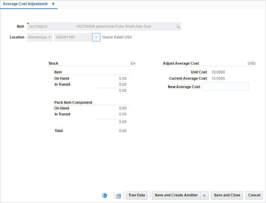

5 Create an Average Cost Adjustment
The Average Cost Adjustment page allows you to enter a new average cost for an item at a selected location.
Figure 5-1 Average Cost Adjustment Page
Average Cost Adjustment window
The Average Cost Adjustment Page displays the following fields.

Fields Description
Item
Enter, or search for the item.
Location
Select the location type. Then enter, select or search for the location for which you want to adjust the average cost.
Stock:
This section allows you to view the item and pack item component quantities at a location.
Right side of the section header displays the UOM (unit of measure) for the stock quantities shown.
Item - On Hand
Displays the stock on hand of the item at the selected location.
Item - In Transit
Displays the stock of the item in transit to the selected location.
Pack Item Component - On Hand
Displays the stock on hand of the pack item component at the selected location.
Pack Item Component - In Transit
Displays the stock of the pack item component in transit to the selected location.
Total
Displays the total quantity of the item at the selected location.
Adjust Average Cost:
This section allows you to view the current costs of an item at a location and allows you to change the average cost.
Right side of the section header shows the location currency.
Unit Cost
Displays the unit cost of the item at the selected location.
Current Average Cost
Displays the current average cost of the item at the selected location.
New Average Cost
Enter the new average cost for the selected item/location.

Adjust the Average Cost for an Item/Location
To adjust the average cost for an item at a selected location, follow the steps below.
  1. From the Tasks menu, select Finance > Average Cost Adjustment. The Average Cost Adjustment page appears.
  2. In the Item field, enter, or search for the item.
  3. In the Location field, select the location type from the list. Then enter, select or search for the location.
  4. In the New Average Cost field, enter the new cost for the item at the selected location.
  5. Then choose one of the saving options. For more information about the available options, see the Average Cost Adjustment Toolbar section.
