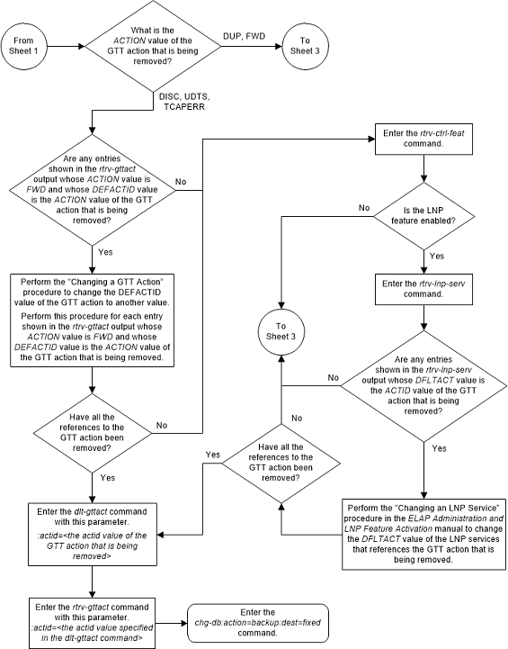

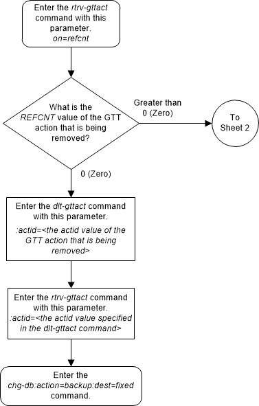

rtrv-gttact:on=refcnt
This is an example of the possible output.
rlghncxa03w 10-07-07 00:27:31 GMT EAGLE5 42.0.0 ACTID ACTION ATCAPERR ITCAPERR UDTSERR UIMREQD REFCNT --------------------------------------------------------- action2 disc --- --- --- off 2 ACTID ACTION PCA RI SSN MRNSET MAPSET REFCNT ----------------------------------------------------------------------- action1 dup 002-002-002 gt --- DFLT ----- 1 CDGTMODID = --------- CGGTMODID = --------- LOOPSET = None USEICMSG = off CGPCOGMSG = dflt CGPCA = --- action3 dup 003-003-003 gt --- 1 ----- 0 CDGTMODID = --------- CGGTMODID = --------- LOOPSET = None USEICMSG = off CGPCOGMSG = dflt CGPCA = --- ACTID ACTION PCI RI SSN MRNSET MAPSET REFCNT ----------------------------------------------------------------------- ACTID ACTION PCN RI SSN MRNSET MAPSET REFCNT ----------------------------------------------------------------------- ACTID ACTION PCN24 RI SSN MRNSET MAPSET REFCNT ----------------------------------------------------------------------- GTT-ACT table is (3 of 2000) 1% full.
If the number of entities that reference the GTT
action entry, the reference count, that is being removed is 0 (zero), continue
the procedure with
6.
The reference count is shown in the
REFCNT
column in the
rtrv-gttact
output.
ACTION
value of the GTT action
entry is
DUP
or
FWD
, continue the procedure with
5.
ACTION
entry is
DISC
UDTS
, or
TCAPERR
with
2.
ACTION
entry is
DISC
UDTS
, or
TCAPERR
, perform one of these
steps
rtrv-gttact
output contains
entries whose
ACTION
value is
FWD
and whose
DEFACTID
value is the
ACTION
value of the GTT
action entry that is being removed, perform the
Changing a GTT Action
procedure to change the
DEFACTID
value to another
GTT action entry. Perform the
procedure for each entry whose
ACTION
value is
FWD
and whose
DEFACTID
value is the
ACTION
value of the GTT
action entry that is being removed. If all references to the GTT action entry
have been removed, continue the procedure with
6.
ACTION
value is
FWD
and whose
DEFACTID
value is the
ACTION
value of the GTT
action entry that is being removed, continue the procedure with
5.
ACTION
entry is
DUP
or
FWD
5.
rtrv-gttact
output contains entries
whose
ACTION
value is
FWD
and whose
DEFACTID
value is the
ACTION
value of the GTT action entry
DEFACTID
value to another GTT action
entry.
Perform the
ACTION
value is
FWD
and whose
DEFACTID
value is the
ACTION
entry that is being removed. If all references to the GTT action entry have
6.
rtrv-gttact
output whose
ACTION
value is
FWD
rtrv-gttact
output whose
ACTION
value is
FWD
, but none of these entries
reference the GTT action that is being removed.
rtrv-ctrl-feat
command.
rlghncxa03w 10-12-28 21:15:37 GMT EAGLE5 43.0.0 The following features have been permanently enabled: Feature Name Partnum Status Quantity Command Class Management 893005801 on ---- Intermed GTT Load Sharing 893006901 on ---- HC-MIM SLK Capacity 893012707 on 64 The following features have been temporarily enabled: Feature Name Partnum Status Quantity Trial Period Left Zero entries found. The following features have expired temporary keys: Feature Name Partnum Zero entries found.
If the LNP feature is enabled, the entry
LNP ported TNs
is shown in the
rtrv-ctrl-feat
output with a
number shown in the
Quantity
column.
Continue the procedure with 5 if the LNP feature is not enabled.
Continue the procedure with 4 if the LNP feature is enabled.
rtrv-lnp-serv
command.
rlghncxa03w 10-12-11 13:45:15 GMT EAGLE5 43.0.0 SERV TT TTN DV ALIAS GTTRQD SELID DFLTACT CNAM 1 cnam1 SCCP --- On 10 fallback 8 On 20 action2 LIDB 2 lidb1 SCCP --- Off None action2 19 On None falltogtt AIN 3 ain TCAP --- Off None fallback UDF1 22 udf1 TCAP --- --- --- --- LNP-SERV TABLE IS 2% FULL (6 of 256)
If entries are shown in the
rtrv-lnp-serv
output that
reference the GTT action that is being removed, shown in the
DFLTACT
column, perform the
"Changing an LNP Service" procedure in
ELAP Administration and LNP Feature Activation
Guide to change the
DFLTACT
value to another value. If
all references to the GTT action entry have been removed after the "Changing an
LNP Service" procedure has been performed, continue the procedure with
6.
rtrv-lnp-serv
output that

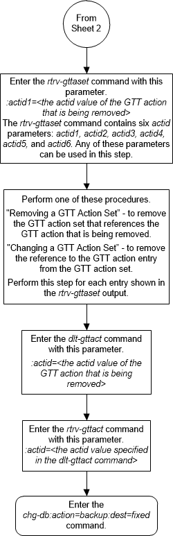

rtrv-gttaset
command with the GTT
action identifier the GTT action entry that is being removed.
For this example, enter this command.
rtrv-gttaset:actid1=action2
There are sixactid
parameters that can be used
with the
rtrv-gttaset
command:
actid1
actid2
actid3
actid4
actid5
actid6
. Any of these parameters
can be used in this step.
rlghncxa03w 10-07-07 00:28:31 GMT EAGLE5 42.0.0 ACTSN TEST ActIds MODE ------------------------------- act2 off action2 (DISC),------,------, ------,------,------ act3 off action2 (DISC),------,------, ------,------,------ GTT-ASET table is (3 of 20000) 1% full.
Perform these procedures for each entry shown in this step.
dlt-gttact
command with the
ACTID
dlt-gttact:actid=action2
When the command has successfully completed, this message should appear:
rlghncxa03w 10-07-07 00:29:31 GMT EAGLE5 42.0.0 GTT-ACT table is (2 of 2000) 1% full DLT-GTTACT: MASP A - COMPLTD
rtrv-gttact
command with the
actid
parameter value specified in
6.
The following message is displayed.
E5071 Cmd Rej: GTT Action Id does not exist
chg-db:action=backup:dest=fixed
command.
These messages should appear, the active Maintenance and Administration Subsystem Processor (MASP) appears first.
BACKUP (FIXED) : MASP A - Backup starts on active MASP. BACKUP (FIXED) : MASP A - Backup on active MASP to fixed disk complete. BACKUP (FIXED) : MASP A - Backup starts on standby MASP. BACKUP (FIXED) : MASP A - Backup on standby MASP to fixed disk complete.
Figure 4-49 Remove a GTT Action Entry - Sheet 1 of 3
Figure 4-50 Remove a GTT Action Entry - Sheet 2 of 3
Figure 4-51 Remove a GTT Action Entry - Sheet 3 of 3
