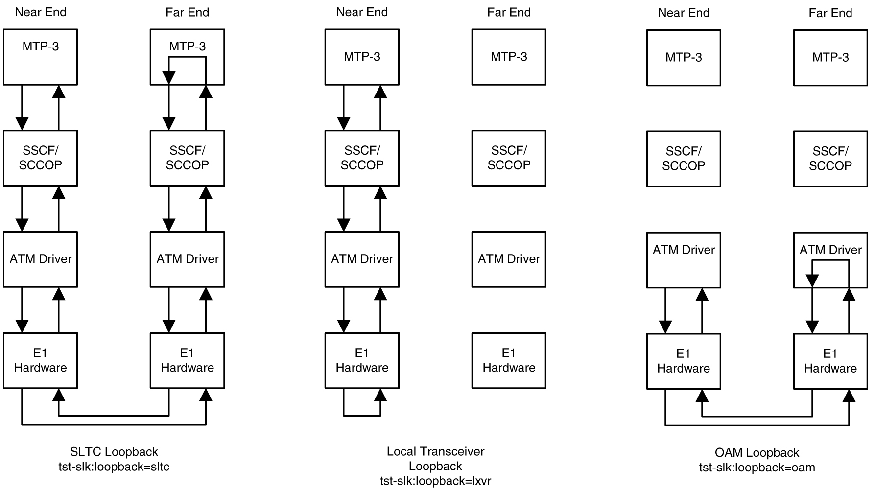

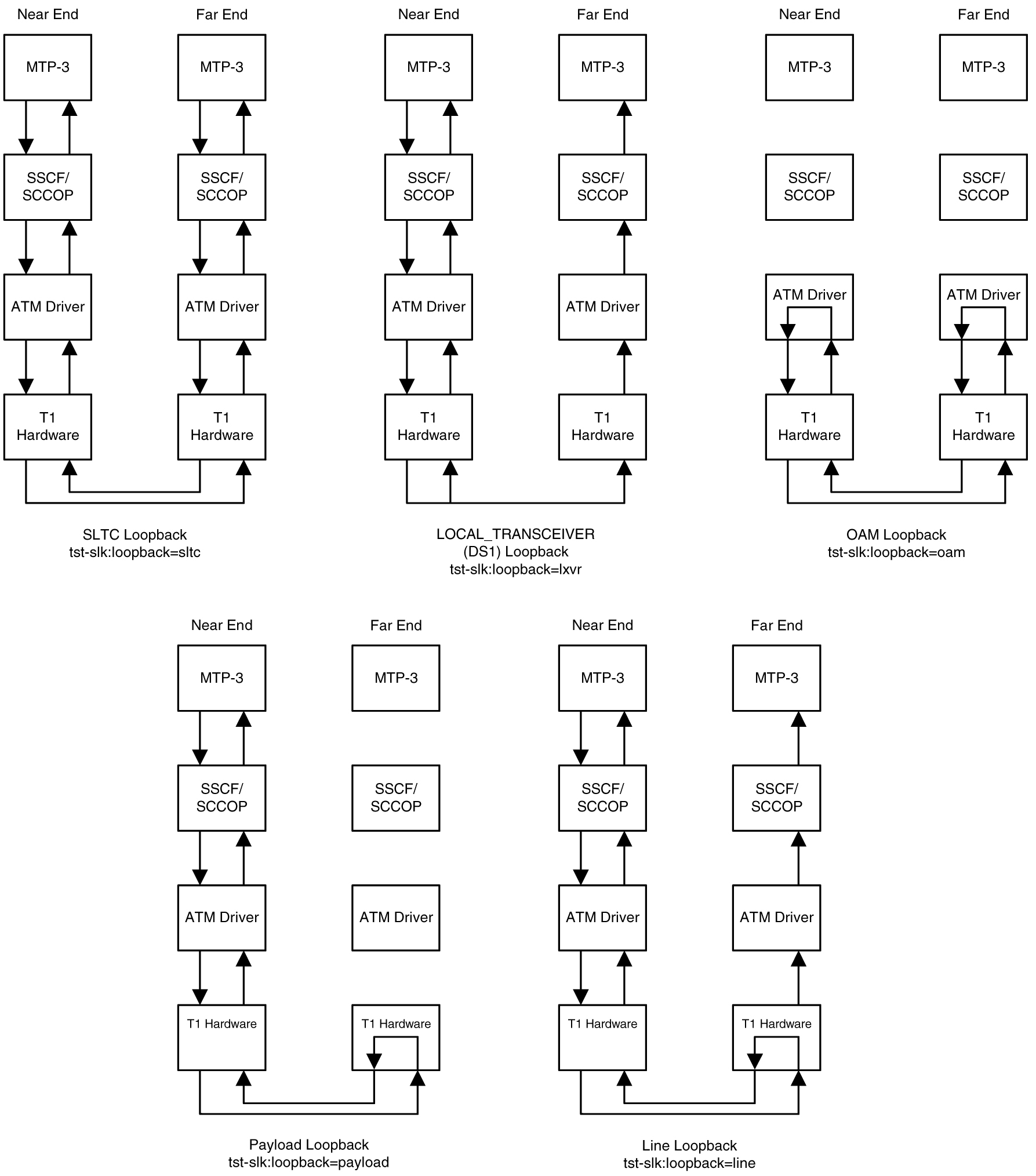

Local Loopback Support
There are five link testing capabilities for an ATM high-speed signaling link. All five of these tests can be used for an ANSI ATM high-speed signaling link; three of these tests can be used for an E1 ATM high-speed signaling link. Table C-2 gives a description of each test and shows which the type of ATM high-speed signaling link each test can be used. Figure C-9 and Figure C-10 show diagrams of each test.

Figure C-9 ANSI ATM High-Speed Signaling Link Loopback Support
Figure C-10 E1 ATM High-Speed Signaling Link Loopback Support
