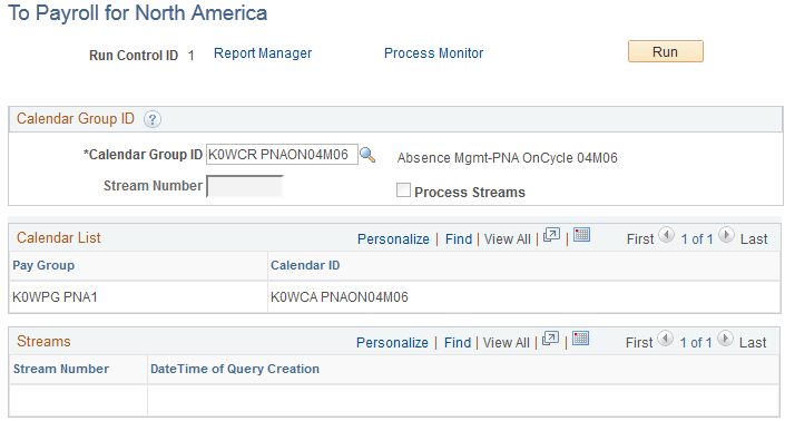

Run the process that sends the generated positive input from the absence process to the Paysheet Load Holding Record (PSHUP) for use by Payroll for North America, or create Time and Labor Payable Time for use by Time and Labor.
Use the To Payroll for North America page (GP_ABS_NA_RUNCTL) to run the process that sends the generated positive input from the absence process to the Paysheet Load Holding Record (PSHUP) for use by Payroll for North America, or create Time and Labor Payable Time for use by Time and Labor.
Image: To Payroll for North America page
This example illustrates the fields and controls on the To Payroll for North America page.
Use this page to transfer generated positive input from Absence Management to Payroll for North America. After this process is completed, the Absence Management data resides in the Paysheet Load Holding Record (PSHUP_TXN) in Payroll for North America for those employees that are not enrolled in Time and Labor.
