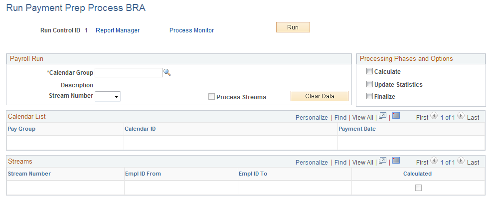

Use the Run Payment Prep Process BRA (run payment preparation process BRA) page (GPBR_RC_PAYMENT) to launch the PS Job that populates the GP_PAYMENT and GPBR_PAYMENT records.
Image: Run Payment Prep Process BRA page
This example illustrates the fields and controls on the Run Payment Prep Process BRA page.
Note: The fields on the Run Payment Prep Process BRA page in Global Payroll for Brazil are the same as on the Run Payment Prep Process page in the core application, except that an additional field (Clear Data) appears on the Run Payment Prep Process BRA page. For more information about the Run Payment Prep Process page, refer to the Run Payment Prep Process Page topic.
Field or Control
Definition
Clear Data
Click when you want to recalculate the Brazilian banking process. If you click this button, you can clear the GPBR PAYMENT output table and fill it again if the calculation changes.
Finalize
Select only if you are absolutely sure that this process is generating the information for all the eligible payees. Selecting this check box turns on an indicator field in the Calendar Group record.

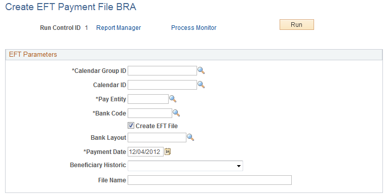

Use the Create EFT Payment File BRA page (GPBR_RC_EFTBANK) to launch the process that builds the flat output file (EFT) and generate a report.
Image: Create EFT Payment File BRA page
This example illustrates the fields and controls on the Create EFT Payment File BRA page.
Field or Control
Definition
Calendar Group ID
Select the calendar group ID for which you want to generate a payment file.
Calendar ID
Select a calendar ID to print only one specific calendar ID, like a vacations or 13th salary calendar, within a calendar group ID.
Pay Entity
Select the pay entity for which you want to generate a payment file.
Bank Code
Select the bank for which you want to generate an EFT file.
Create EFT File
Click to create the EFT file.
Payment Date
Enter the date of the payment.
Beneficiary Historic
Specify the type of transaction being sent to the bank.
File Name
Specify the name of the EFT file.
Note: You must populate the GP PAYMENT table and the GPBR PAYMENT table before you can launch this SQR, which generates the flat file for banking along with a printed report of payment details.
