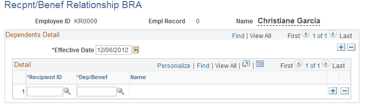

Use the Recpnt/Benef Relationship BRA (recipient/beneficiary relationship BRA) page (GPBR_RECBEN_REL) to identify which of a payee's deduction recipients to include in the annual IREN report.
Navigation
Image: Recpnt/Benef Relationship BRA page
This example illustrates the fields and controls on the Recpnt/Benef Relationship BRA page..
For the selected employee, identify any deduction recipients that are to be included in the IREN report. Deductions paid to the selected recipient will be listed in the report along with the recipient's name. (Use the Add Deduction Recipients page to specify which deduction a recipient is to receive.)

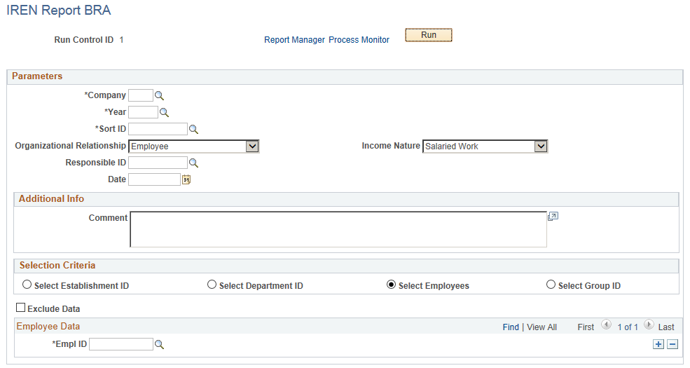

Use the IREN Report BRA page (GPBR_RC_IREN) to generate the IREN report.
Navigation
Image: IREN Report BRA page
This example illustrates the fields and controls on the IREN Report BRA page.
Field or Control |
Definition |
| Organizational Relationship |
You can generate the report for employees, contingent workers, or persons of interest. |
| Income Nature |
You can include salaried or unsalaried workers. |
| Responsible ID |
Identify the person who is responsible for this report. |
| Date |
Enter the date to print on the report. |
