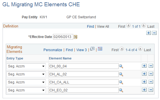

Use the GL Migrating MC Elements CHE (General Ledger Migrating Multiple Contracts Elements CHE) page (GPCH_GL_MIGR_LST) to select segment accumulators to transfer to a target record where they can be picked up by the GL process.
Navigation
Image: GL Migrating MC Elements CHE page
Field or Control |
Definition |
| Entry Type |
Select Seg. Accm (segment accumulator). |
| Element Name |
List the segment accumulators to transfer from the legal (receiving) record to the target record for GL processing. |

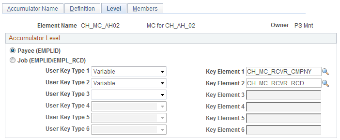

Use the Level page (GP_ACCUMULATOR_1) to specify the variables storing the record number and company to which you want to transfer segment accumulator results.
We discuss this page in the PeopleSoft Global Payroll PeopleBook.
Navigation
Image: Level page
Level page
In the User Key Type fields, select Variable, and then enter the variable element CH_MC_RCVR_CMPNY (MC Receiver Company) in combination with the variable CH_MC_RCVR_RCD (MC Receiver) in the Key Element fields. These variables are set up to hold the company and the number of the target record to which you are transferring the segment accumulator results.
Note: We discuss this page in detail in the PeopleSoft Global Payroll PeopleBook.

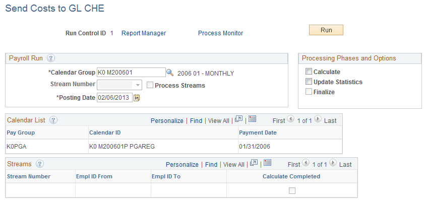

Use the Send Costs to GL CHE page (GP_GL_PREPARE) to send costs to PeopleSoft General Ledger.
When you run the General Ledger process from this page, the system transfers accumulator results to the target record and company stored in the variables specified on the segment accumulator Level page and then sends the results to PeopleSoft General Ledger.
Navigation
Image: Send Costs to GL CHE page
The fields on the General Ledger Run Control page for Switzerland are identical to those on the Send Costs to GL page in the Global Payroll core application.
