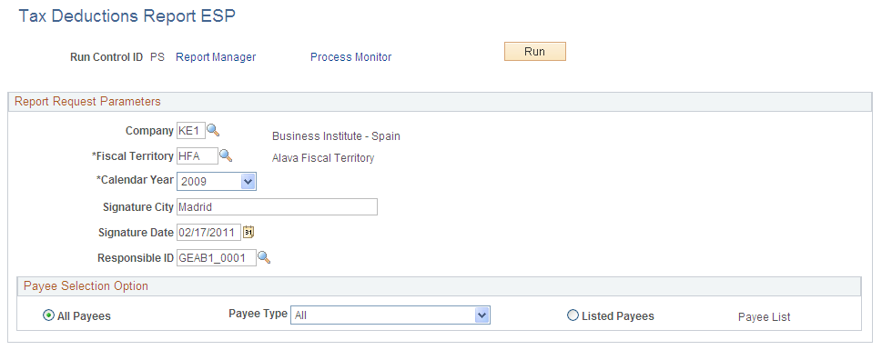

Use the Tax Deductions Report ESP page (GPES_RC_TAX_10T) to generate the Tax Deductions report (GPESTAX1) for resident or nonresident employees.
The SQR process generates a PDF file containing annual tax deduction information for each employee.
Image: Tax Deductions Report ESP page
This example illustrates the fields and controls on the Tax Deductions Report ESP page. You can find definitions for the fields and controls later on this page.
Field or Control
Definition
Company
Select the company for which to run this report.
Fiscal Territory
Select the fiscal territory to which the company submits tax reporting information.
Note: PeopleSoft Global Payroll for Spain provides functionality for generating the Tax Deductions Report just for the state fiscal territory. For other fiscal territories, you can generate this report through the programs that each fiscal agency provides when you report the Model 190. You can download these programs directly from the official websites of the historical territories.
Calendar Year
Select the calendar year to report.
Signature City
Enter the city where the report was signed.
Signature Date
Enter the date that the report was signed.
Responsible ID
Enter the ID of the person who is responsible for signing the report.
Employee Information
Specify the types of employees included in the report. Valid values are: Residents, Non Residents, and Both.
Payee Selection Option
Select All Payees to include all the employees in the company in the report. Otherwise, select Listed Payees and click the Payee List link to select the employees for the report.

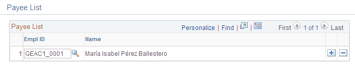

Use the Payee List page (GPES_TAX010_SEC) to select the employees to include in the Tax Deduction report. You can also print payslips for the selected payees.
Image: Payee List page
This example illustrates the fields and controls on the Payee List page. You can find definitions for the fields and controls later on this page.
Payee List page
Field or Control
Definition
Empl ID (employee ID)
Select the employee for whom you want to run the Tax Deduction report.
