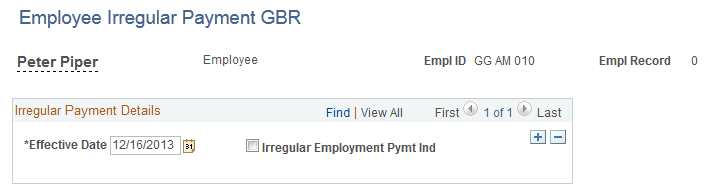

Use the Employee Irregular Payment GBR page (GPGB_EE_IR_PYMT) to set the Irregular Employment Payment Indicator flag for an employee.
Image: Employee Irregular Payment GBR page
This example illustrates the fields and controls on the Employee Irregular Payment GBR page.
You can upload a list of employees who have an irregular payment pattern. See the Process Irregular Payment GBR Page for more information.
Field or Control
Definition
Irregular Employment Pymt Ind (Irregular Employment Payment Indicator)
Select this check box to indicate that the employee does not always receive a payment every pay period. If the check box is deselected the employee does not receive a payment for 13 weeks and HMRC will assume that the employee is no longer employed by the employer and has left. An example of where this flag is set is for employees with zero contract hours.

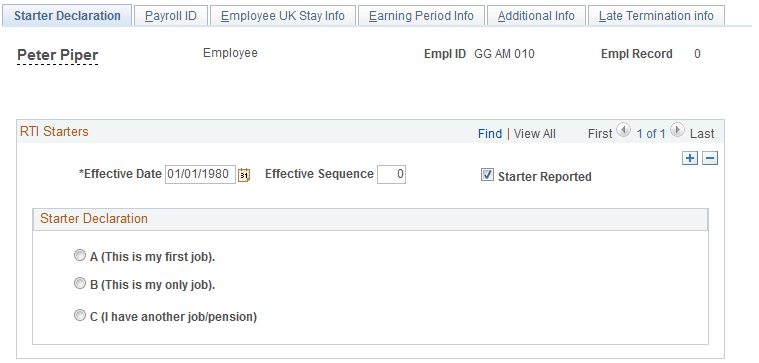

Use the Starter Declaration page (GPGB_EE_RTI_STARTR) to enter a value for all new employees hired since the start of the Tax Year, if the information is not entered through the Maintain Tax Page GBR page.
Image: Starter Declaration page
This example illustrates the fields and controls on the Starter Declaration page.
Field or Control
Definition
Effective Date
The effective date on this page should match the employee's hire date. This date is typically populated by a batch process but can be overridden.
Starter Declaration
When P46 data exists for the employee the batch process populates the Starter Declaration value. You need to manually set this value for all employees when no P46 data is present.

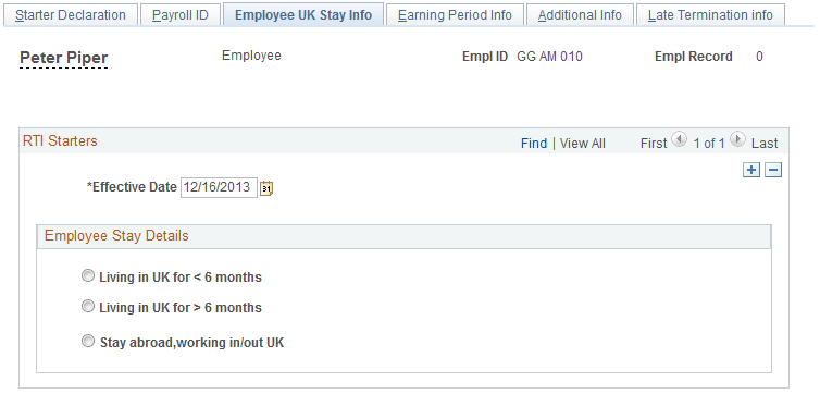

Use the Employee UK Stay Info page (GPGB_EE_RTI_STAY) to enter stay details.
Image: Employee UK Stay Info page
This example illustrates the fields and controls on the Employee UK Stay Info page.
Field or Control
Definition
Employee Stay Details
Select an option under this section when data has been entered on the P46 Expat Details GBR page (Global Payroll & Absence Mgmt > Payee Data > P46 Expat Details GBR > P46 Expat Details GBR) for the employee.
Note: For the employee to be recognized as an Expat, they must be set up on the P46 Expat Details GBR page. If the P46 (Expat) Declaration information is being captured in the P46 Expat Details GBR page, while running the GPGB_EMPMAP and GPGB_STARTER Processes, the Employee Stay Details are updated in the Employee UK Stay Info page.

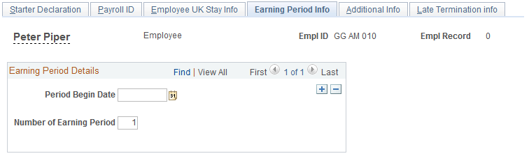

Use the Earning Period Info page (GPGB_EE_ERNPRD) to view or override the number of periods for which the employee is receiving payment in the FPS.
Image: Earning Period Info page
This example illustrates the fields and controls on the Earning Period Info page.
Field or Control
Definition
Number of Earning Period
The field indicates the number of periods for which the employee is receiving payment in the FPS. However, as an employee you can override this value. The default value is 1.
The FPS process determines the number of periods covered by a payment and updates this value wherever appropriate.
For example, if you are processing an employee who was hired in June for the first time on the July payroll, you need to enter a value of 2 in this field to indicate that the payment being made covers both the June and July payrolls.

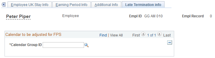

Use the Late Termination Info page (GPGB_RTI_FPSADJ) to report the leaving date of employees terminated from the previous pay period and not processed in the current pay period.
Image: Late Termination Info page
This example illustrates the fields and controls on the Late Termination Info page.
Field or Control
Definition
Calendar Group ID
Specify the calendar group ID of the terminated employee who needs to be included in the subsequent FPS.

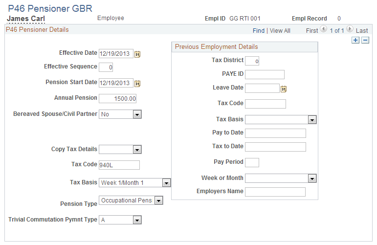

Use the P46 Pensioner GBR page (GPGB_P46_PENSN_DTL) to complete the P46 Pensioner page information when customers do not create a new employment record for employees who become pensioners.
Image: P46 Pensioner GBR page
This example illustrates the fields and controls on the P46 Pensioner GBR page.
When customers do not create a new employment record for employees who become pensioners, the Starter Declaration for a pensioner is sent to HMRC but the date that the pension started is sent in place of the employee's hire date. The P46 Pensioner page is used under such instances.
Field or Control
Definition
Trivial Commutation Pymnt Type (Trivial Commutation Payment Type)
A trivial commutation pension payment and other lump sum pension payments are one-off lump sums that pay off or are paid in place of a small pension, instead of paying the usual weekly, monthly or annual payments. Typically, these one-off payments are used if the regular payments would be very small.
Categorize these payments in the Trivial Commutation Payment Type field. The field indicates the type of lump sum paid (other than lump sum death benefits and on serious ill-health).
See the P46 Pensioner GBR Page topic for more information.

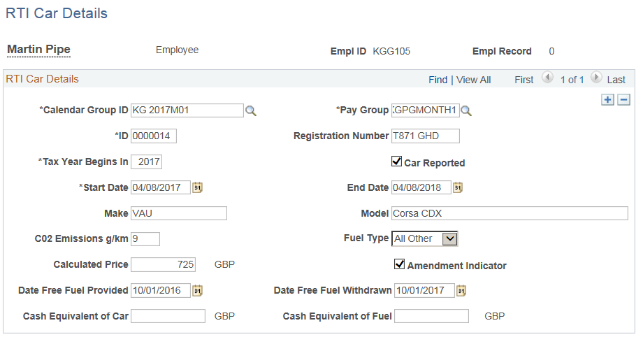

Use the RTI Car Details Page (GPGB_RTI_CAR) to enter the Car details. Company Car details is incorporated in RTI using FPS.
Image: RTI Car Details GBR Page
This example illustrates the fields and controls on the RTI Car Details GBR page.
Field or Control
Definition
Calendar Group ID
Select the required calendar group id for the car. Car will be added in the FPS report with the specified Calendar Group ID.
Pay Group
Select the pay group for the car. Car will be added in the FPS report with the selected Pay Group details.
ID
Enter a unique identification for the car. This helps to distinguish multiple car added for the same employee in the same Calendar group ID.
Registration Number
Enter the registration number of the car. It is the car identifier in the FPS report.
Car Reported
Once the car is reported in the Calendar Group, Car Reported check box will be selected by the FPS process. If we rerun FPS for the same Calendar Group, the cars will be reported again but not for the subsequent calendars.
Start Date
Enter the date from which the car is available.
End Date
Enter the date up to which the car is available.
Amendment Indicator
Select the check box if there is any amendment in the already reported cars.

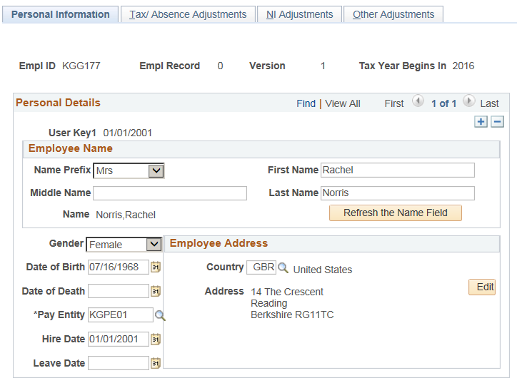

Use the Personal Information Page (GPGB_RTI_PERD_ADJ) to capture the personal information of the employees that needs to be modified while running EYU (Earlier Year Update) process.
Note: Using EYU process, employers can submit amendments to YTD figures for previous tax years after the end of year processing date has passed. The EYU adjustment values are captured using the RTI Adjustment Details GBR page. For more information on running EYU process, seeProcess RTI GBR Page
Image: Personal Information Page
This example illustrates the Personal Information page.
RTI Adjustment Details Personal Information Page
Note: Based on the selected employee, the details are displayed. If you update any data the same will be considered while reporting EYU.

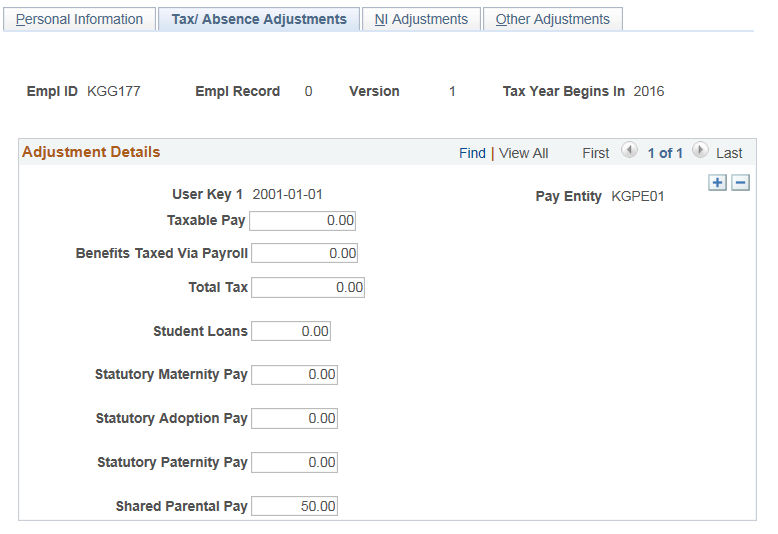

Use the Tax/Absence Adjustments page(GPGB_RTI_TAX_ADJ) to capture the tax details that need to be modified while running EYU process.
Note: The values submitted in the EYU file are adjustments and not replacement values. For example, consider a scenario where you have submitted a value of £1000 in the final FPS for an employee's Tax Paid YTD value, and then you want to change it as £1500. Here, to change the amount, you should submit a value of £500 in the EYU file, not £1500. Adjustment values may be positive or negative.
Image: Tax/Absence Adjustments page
This example illustrates the Tax/Absence Adjustments Page.
Tax Absence Adjustments Page
Note: If you update any data the same will be considered while reporting EYU.

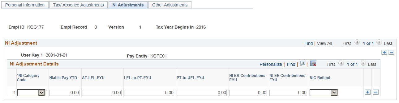

Use the NI Adjustments page( GPGB_RTI_NI_ADJ ) to capture the NI details that need to be modified while running EYU process.
Image: NI Adjustments Page
This example illustrates the NI Adjustments Page
NI Adjustments Page
