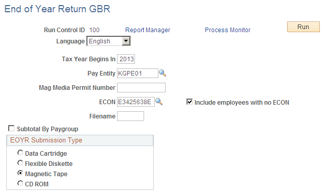

Use the End of Year Return GBR page (GPGB_RNCTL_EOYR) to run the GP UK End of Year Returns process.
Navigation
Image: End of Year Return GBR page
This example illustrates the fields and controls on the End of Year Return GBR page.
Field or Control |
Definition |
| Tax Year Begins In |
Enter the year for the start of the tax year. |
| Pay Entity |
Select the pay entity for which you want to create the year end return. Note: Pay entity tax details must exist for the pay entity before you can run the process. Use the Pay Entity Details page to define this information. |
| Mag Media Permit Number (magnetic media permit number) |
Enter the permit number for the tax year you're processing. HMRC issues employers with a new permit number for each tax year. |
| ECON (employer contracted out number) and Include employees with no ECON |
Select an ECON. The process selects employees in the pay entity with the ECON that you specify here. Select the Include employees with no ECON check box if you want the process to include any employees in the pay entity who do not have an ECON identified at employee level. |
| Filename |
Enter the name of the output file. Refer to the HMRC guidelines for filenaming conventions. |
| Subtotal By Paygroup |
Select this check box if you want the output file to include a subtotal record for each pay group. |
| EOYR Submission Type |
Select the media you're using to submit the end of year return. |
See HM Revenue and Customs Technical Guide "Submitting Year End Returns on Magnetic Media" – Reference CA51/52
