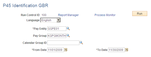

Use the P45 Identification GBR page (GPGB_RCTL_P45ID) to run the P45 Identification process (GPGB_P45).
This process identifies payees who are due to receive a P45.
Image: P45 Identification GBR page
This example illustrates the fields and controls on the P45 Identification GBR page.
Field or Control
Definition
Pay Entity, Pay Group, and Calendar Group ID
Select the group of employees for which you want to run the P45 Identification process.
You can run the process for a particular calendar group or pay group. If you complete the Pay Entity field only, all the pay groups within the pay entity are processed.
From Date and To Date
Enter the begin and end dates for the period. The process searches for payees with job data events within the period who do not have a final P45 printed. The process uses the P45 leaver information (displayed on the Maintain Tax Data GBR page) to determine whether a payee has received a finalized P45. If the calendar group ID and P45 leave date have not been populated, the payee has not received a P45.
See Maintain Tax Data GBR Page.

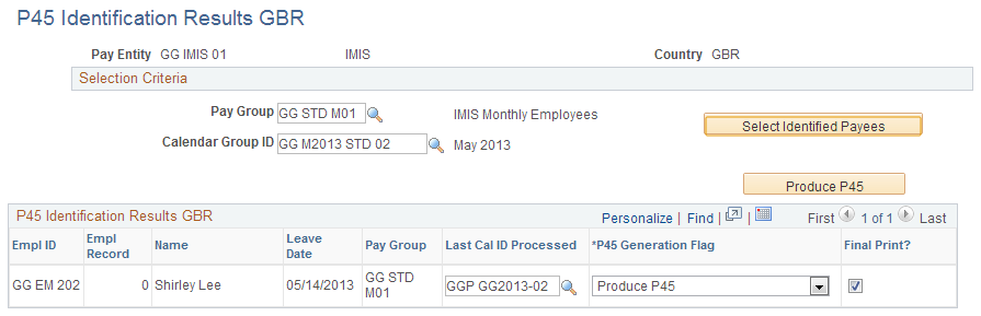

Use the P45 Identification Results page (GPGB_EE_P45_ID) to view the results of running the P45 Identification process.
You can also adjust the payee list and generate P45 reports from this page.
Image: P45 Identification Results page
This example illustrates the fields and controls on the P45 Identification Results GBR page.
Field or Control
Definition
Pay Group, Calendar Group ID, and Select Identified Payees
Select the group of employees for which you want to view the results of the identification process and click the Select Identified Payees button. You can restrict the list to a pay group or calendar group. If you leave both Pay Group and Calendar Group ID blank, the system displays the results for all pay groups within the selected Pay Entity.
If no employees are displayed when you click the Select Identified Payees button, this means that no employees were identified by the process in the pay group or calendar group.
Output File Path
Click this link to access the Output File Path page where you can specify the directory in which the output of the P45 process is created.
Note: This link is only displayed if the UK Payroll Configuration bracket (GBR BR CONFIG CHAR) is set up to allow you to specify the output directory. If the link is not displayed, the report is printed to the default destination defined in the GPGBP45.SQC.
See Bracket Data Page.
Produce P45
Click this button to generate P45s for employees with the P45 Generation Flag set to Produce P45 or Calendar Override. The P45 generated is a draft version, unless you select the Final Print? check box.
Last Cal ID Processed (last calendar ID processed)
Displays the calendar ID in which the payee was last processed. Update this field if you select Calendar Override in the P45 Generation Flag field.
P45 Generation Flag
Select a value to determine whether the P45 is printed when you run the P45 report. Values are:
Produce P45: To print the P45. This is the default value if the calendar is finalized.
Send P45 Via Email: To send electronic P45 through email to the employee’s registered email ID.
Note: Employee should have one preferred personal email id configured in his personal data. If there was no valid email address, then mail would not be delivered to the employee. In such cases, administrator can take the help of consolidated P45 generated.
Enable P45 in ESS: To produce Online P45 through ESS.. If enabled, employees can view their P45 by logging in to their Self Service
Suspend P45 Production: Suspends P45 production. Use this value if a payee's job data has been updated in error. When you select this value, the system displays the Notes link that enables you to add a reason for the suspension. A payee's P45 remains suspended until you change the P45 Generation Flag,
Calendar Override: To use a different calendar ID for the selected employee. Select the calendar to use in the Last Cal ID Processed field.
Delete P45 Production: Prevents production of the P45. Use this option to remove payees with a suspend status from the results table.
Warning! Removing a payee from the results table doesn't stop the payee from being identified the next time you run the P45 Identification process. If the payee's job data has not changed, the employee is identified as requiring a P45 again. For example, if a payee has an incorrect termination date and you delete the payee from the results table, you must also update job data to correct this error.
Unprocess/Unfinal Term Cal ID: Indicates that the employee has been terminated in job data but one of these conditions apply:
  • The payroll process has not processed the termination event.
  • The payroll process has processed the termination but the calendar (in which the termination was processed) is not finalized.
Final Print?
Select this check box to generate a final print of the P45. The system automatically selects this check box if the calendar is finalized. If this is not selected, the P45 report is a draft version ("Draft Report" appears in the report).
Notes
Click to access the P45 ID Results Notes page where you can add comments. This link only appears if you select Suspend P45 Production in the P45 Generation Flag field. Use the P45 ID Results page to record the reason for the suspension.

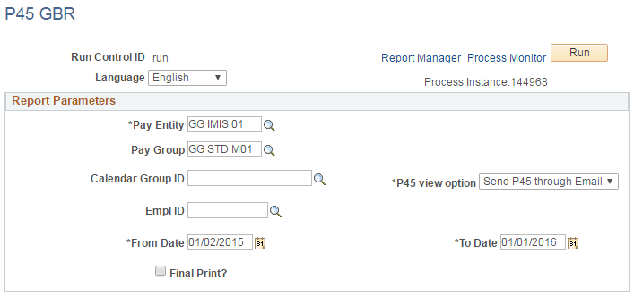

Use the P45 GBR page (GPGB_RUNCTL_P45) to produce P45s.
Typically, a P45 is issued to employees who leave employment but it can also be issued to employees for other reasons that you define for your organization.
Image: P45 GBR page
This example illustrates the fields and controls on the P45 GBR page.
P45 GBR page
Field or Control
Definition
Pay Entity, Pay Group, Calendar Group ID, and EmplID
Select the employees for which you want to run the P45 report.
You can run the process for a particular employee, calendar group or pay group. If you complete the Pay Entity field only, all the pay groups within the pay entity are processed.
P45 view option
Select any of the following option to view/produce Online P45 report.
  • Send P45 through Email: Select to send P45 through email to the employee’s registered email ID
  • Enable P45 in ESS: Select to view P45 report in employees’s ESS.
Note: The selection done in P45 Identification Results GBR page overrides the P45 view option selection in the P45 GBR page.
Final Print?
Select this check box to generate a final print of the P45. When you select Final Print? the Calendar Group ID field on the Maintain Tax Data GBR page is automatically updated, indicating that the P45 has been generated for the calendar group that appears in this field. When you ask for a final print, you can only reprint the P45 (if needed) from the same calendar group ID, even if other calculations take place.
Output File Path
