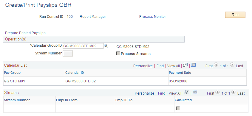

Use the Create/Print Payslips GBR page (GPGB_PSLIP) to run the Printed Payslip Job PSJob process (GPGBPYSP).
This job runs the Payslip Preparation process (GPGB_PSLIP_X), followed by the Printed Payslip SQR report (GPGBPSLP), and the Create Self Service Payslip process (GP_EPAY). You must set up payslips on the payslip definition pages before running the payslip processes.

Image: Create/Print Payslips GBR page
This example illustrates the fields and controls on the Create/Print Payslips GBR page.

Field or Control |
Definition |
| Calendar Group ID |
Select the calendar group for which you want to load payslip result data. |
| Stream Number and Process Streams |
Select the stream for which you want to load payslip result data. Stream and Process Stream fields are as defined on the Streams and Payroll/Absence Run Control pages. If you have defined them for processing, then you can use them to select results. |
Calendar List
Field or Control |
Definition |
| Pay Group |
Displays the pay group for which you are loading payslip result data. |
| Calendar ID |
Displays the calendar ID for which you are loading payslip result data. |
| Payment Date |
Displays the payment date for which you are loading payslip result data. |
Off Cycle Groups
Field or Control |
Definition |
| Pay Group |
Displays the pay group for which you are loading payslip result data |
| Period ID |
Displays the period ID for which you are loading payslip result data |
| Off Cycle Group |
Displays the off cycle group for which you are loading payslip result data |
Streams
Field or Control |
Definition |
| Stream Number |
Select the streams you are using to load data into the payslip printing tables. |
| Calculated |
Indicates which streams have been calculated. |
