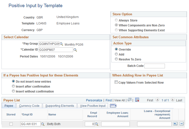

Use the Positive Input by Template page (GP_PI_BULK_SSN) to use the template delivered for the UK to enter positive input for loans.
Image: Positive Input by Template page
This example illustrates the fields and controls on the Positive Input by Template page.
Field or Control
Definition
Action Type
Select one of these options:
Override: To override the repayment amount for the pay period.
Add: To enter an additional repayment amount or an exceptional amount.
Employee Loan: Amount
Enter the override or additional amount. Leave this field blank if the positive input is for an exceptional amount.
Loan – Exceptional repayment: Amount
Enter the exceptional amount. Leave this field blank if the positive input is for an override or additional amount.
