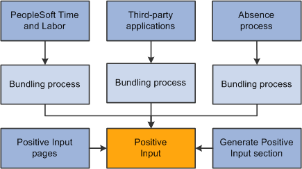

Positive input can come from various sources. You can:
Manually enter data through the positive input pages.
Receive data from Time and Labor, the Manage Variable Compensation business process in HR, or third-party applications.
Run the Absence Take process (GP_PAYE) to convert paid and unpaid absences into positive input.
Include a generate positive input section in your process list, causing the system to create positive input for a different pay calendar.
With one exception, manual entries override positive input generated by other sources. (Manual entries with an action type of Add do not override automated entries.) If a payee has system-generated entries from multiple sources, such as Time and Labor and the Absence Take process, but no manual entries, the system processes all automated entries during the pay run.
You can edit positive input only if it was entered into the system manually. To add, delete, or correct a system-generated entry, enter positive input that overrides the system-generated entry; if the data was generated by another application, correct the source records and retransmit the data.

Bundling
Positive input created by the Absence Take process, Time and Labor, or a third-party application is often bundled by pay period into an array, for more-efficient processing. If a payee works eight hours a day on a weekly pay frequency, five eight-hour entries can be bundled into one 40 hour entry. Bundling has no impact on processing or results other than that it creates a single row of output (GP_RSLT_ERN_DED) instead of multiple rows.
Each bundle receives an instance number. Instance numbers begin with 1 and are assigned to each bundled element in a calendar run.
Rules for bundling data depend on the positive input source.
Image: Sources of positive input and bundling
This diagram illustrates the sources of positive input and bundling.

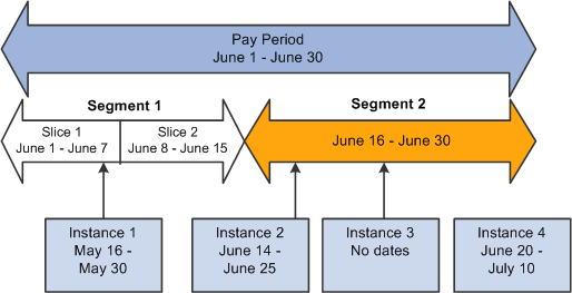

When a calendar pay period has period or element segmentation, positive input isn't prorated. It's assigned to a single segment or slice, based on the instance's end date:
If the end date falls before the calendar period begin date, the instance is assigned to the pay period's first segment or slice (see Instance 1 in the diagram).
If the end date falls in the pay period, the instance is assigned to the segment or slice in which the end date falls (see Instance 2).
When no end date is specified, the instance is assigned to the pay period's last segment or slice.
It's assumed that the end dates for the instance and the calendar are identical (see Instance 3). There is one exception: you can enter Do Not Process instructions to prevent the element's resolution. If you enter this instruction with no end date, the element isn't resolved in any slice or segment.
If the end date falls after the pay period end date, the instance isn't processed (see Instance 4).
Image: Instances assigned to segments and slices by end date
This diagram illustrates instances assigned to segments and slices by end date

One row of data is written to the output table for each instance. Therefore, if entries are bundled, one row of data is written to the output table for the entire bundle. When a separate instance number is assigned to each entry, a row of data is written to the output table for each entry.
The instance numbers stored in the output table enable you to link each entry to the processing results. An automatically generated source code (PI_Source) identifies the origin of the entry: Absence, Generated PI, Manual, or Time & Labor.
