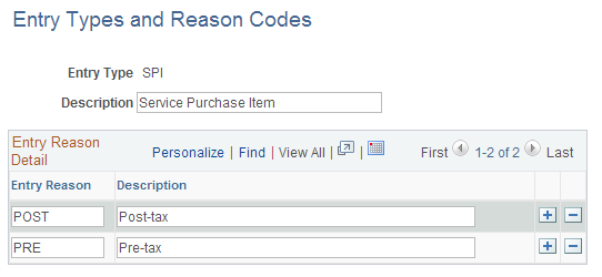

Use the Entry Types and Reason Codes page (ENTRY_TYPE) to define PeopleSoft Receivables entry types and reasons to use for service purchase payments.
Image: Entry Types and Reason Codes page
This example illustrates the Entry Types and Reason Codes page.
Entry Type and Entry Reason values are required by PeopleSoft Receivables to determine accounting information for all open items created. These values are defined in the PeopleSoft Receivables system.

Entry Type and Description
Create two entry types, one for debit items and one for credit items. Use the same entry type code and description that exist in the PeopleSoft Receivables system.
Entry Reason
For each entry type, create two entry reasons, one for pre-tax and one for post-tax. Use the same entry reason code and description that exist in the PeopleSoft Receivables system.
Note: You will reference these entry types and reasons on the Service Purchase Configuration - AR Integration Page.
