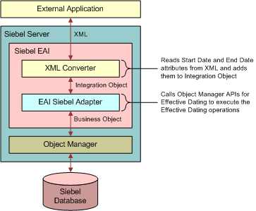

About Using Effective Dating with Siebel EAI Adapter Business Service

EAI Siebel Adapter is a general-purpose integration business service that allows you to:
Read Siebel business objects from the Siebel Database into integration objects.
Note: When called locally, the EAI Siebel Adapter business service creates an additional database connection. If this second connection times out, then further transactions will not be processed. To prevent this from happening, add the TrxDbConnReconnectIntervalSeconds parameter to the [ServerDataSrc] section of the application configuration (CFG) file. A typical value is 120.Write an integration object instance whose data originates externally in a Siebel business object.
Update multiple corresponding top-level (highest-level) parent business component records with data from one XML file, for an example, see Update Method.
The Siebel EAI Adapter allows you to access effective dating data, which means the start date and end date for a given field or link. Third-party applications can request and receive effective dating data from the Siebel application.
To view XML samples for effective dating functionality see Enabling Effective Dating on Fields.
You specify effective dating on fields of a given business component through a Siebel Web Client administration screen. For more information, see Enabling Effective Dating on Fields. Two integration component fields attributes allow you to set effective dating: EDStartDate and EDEndDate. Standard querying techniques, such as query, insert, update, sync can be used to request effective dating-enabled data.
As the following figure shows, the Siebel Object Manager framework features APIs which are called by the Siebel EAI Adapter when an integration object with effective dating enabled fields or links is read by the XML Converter.
The following two topics explain how effective dating works:
