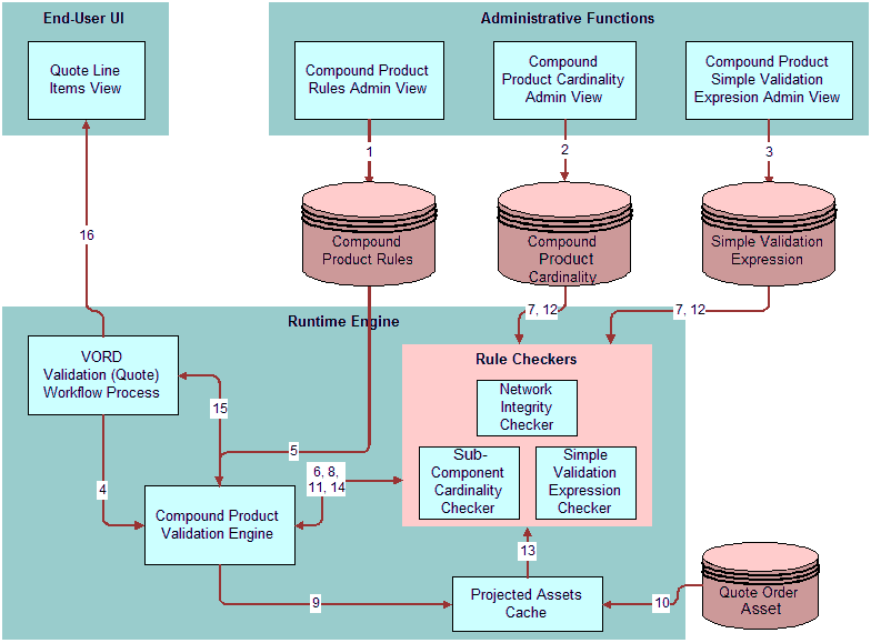

Network order entry configures products by:
  • Partitioning the network into a number of components.
  • Using Configurator to validate configuration of individual components in real time.
  • Using the Compound Product Validation Engine to validate cross-component rules only at key times, such as when the user clicks the Validate button.

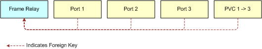

For example, The following figure illustrates part of a network that uses a frame relay as its network product and several ports and PVCs as its components. Network order entry defines the network and its components as separate products. A foreign key field in the component products relates the components to the network product. Configurator validates the configuration of the individual network product and component products. The Compound Product Validation Engine validates the network across products.
A Network and Its Components
Network order entry partitions the network into multiple components:
  • Siebel Configurator handles intra-component validation rules.
  • Business services handle validation rules for the entire multi-component network. Workflows that you can customize run these business services.
The Compound Product Validation Engine validates the network across components by applying rules, such as:
  • A multipoint service must have at least two ports and at least one PVC.
  • Any two ports can have only one connection.
  • The to and from ports for a connection must exist in the multipoint service.
  • The sum of the bandwidth attribute for all PVCs connected to a port cannot exceed the speed attribute of the port.

                        About the Compound Product Validation Engine
                        The Compound Product Validation Engine executes validation rules that cross product instances.
                        A compound product is a group of product instances in quote, order and asset tables that share a common key. A Frame Relay Network is an example of a compound product.
                        The Compound Product Validation Engine allows you to create rules that operate on a projected future state of a compound product that includes the current quote and any open orders on the existing assets. This future state is created and stored in the Projected Asset Cache object.
                          Overview of Compound Product Validation
                          The following illustrates how the Compound Product Validation Engine and its supporting components validate a compound product when a user clicks Validate.
                          Steps in Compound Product Validation
                          As the previous figure illustrates, Compound product validation includes the following steps:
                          1. Product manager defines the cross-product validation business services rules for the first-level product in the Product Validation view, Validation Services subview. For more information, see Defining Business Services for Rule Checkers.
                          2. Product manager defines the component cardinality rules for the first-level product in the Product Validation view, Cardinality Rules subview and enters basic validation rules in the Product Validation view, Product Validation Expression Rules subview. For more information, see Defining Maximum and Minimum Quantities for Network Components and Defining Simple Expression Rules for Compound Products.
                          3. The user creates a change quote for the compound product. The user validates the individual components using Configurator. After exiting Configurator and completing the network connections, the user clicks Validate. The Validate button calls a named method on the Quote Item business component, which calls the VORD Validate (Quote) workflow process.
                          4. The VORD Validate (Quote) workflow process determines the selected compound product instance. This workflow process also determines the future date for which to validate the network based on the latest requested date of quote line items for the network. For more information, see the Future Date step in VORD Validate (Quote) in the topic about creating custom rule checkers in Siebel Product Administration Guide. This workflow process then calls the Compound Product Validation Engine business service.
                          5. The Compound Product Validation Engine retrieves the compound product validation rules for the first-level product. For more information, see the Validate step in VORD Validate (Quote) in the topic about creating custom rule checkers in Siebel Product Administration Guide.
                          6. For each rule, the Compound Product Validation Engine calls the Pre-Validate method on the corresponding business service.
                          7. If necessary, the rule checker business service retrieves product specific data related to the rule (for example, the cardinality constraints for sub components of the compound product).
                          8. The rule checker determines the fields and attributes it requires and returns them to the Compound Product Validation Engine, which accumulates a list of fields and attributes that all rule checkers require.
                          9. The Compound Product Validation Engine prompts the Projected Assets Cache to retrieve the compound product instance limited to fields and attributes that the business service validation rules for the compound product require.
                          10. The Projected Assets Cache retrieves all asset records for the compound product. The cache then retrieves all open order line items due to complete before the specified due date and updates the records retrieved from the asset table to create a future state. All changes to the compound product instance in the current quote or current order are applied to generate the true future requested state.
                          11. For each rule, the Compound Product Validation Engine calls the associated rule checker business service method.
                          12. If necessary, the rule checker business service retrieves product specific data related to the rule (for example, the cardinality constraints for sub components of the compound product).
                          13. The rule checker business service queries the Projected Assets Cache to evaluate the rule (for example, the rule checker gets the bandwidth for each PVC connected to a node).
                          14. The rule checker business service returns a list of rule violations to the Compound Product Validation Engine.
                          15. The Compound Product Validation Engine accumulates the violations for each rule and returns them to the VORD Validate (Quote) workflow process.
                          16. The Compound Product Validation Engine business service displays the error message that the user defines in Message Types view.
