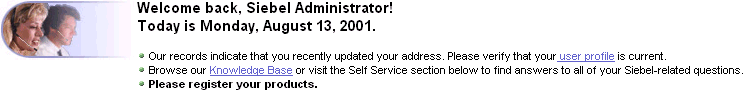

Viewing the Results of Modifying the eSalutation Applet
Log in to eService as SADMIN. The following figure is an example of the Siebel eService Salutation Applet after adding a new personalization rule.
