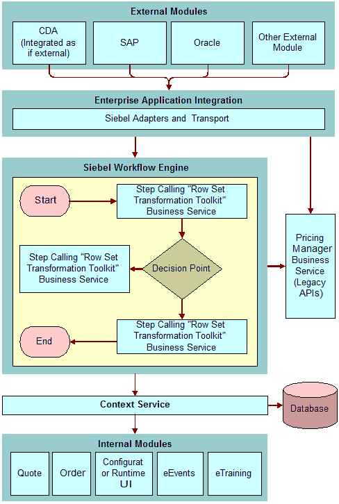

The following figure shows how the Pricing Manager business service can be integrated to provide Siebel Pricer functionality to both internal and external application modules.
Integration Methods for Siebel Pricer
Siebel Pricer supports the following types of integration:
Internal integration. This allows you to configure the Siebel application so that Siebel Pricer works with other Siebel business objects. Without configuration, Siebel Pricer works with quotes, orders, and agreements. For more information, see Internal Integration of Siebel Pricer.
External integration. This allows you to integrate Siebel Pricer with other external applications, such as back office applications, in the following way:
External integration using Pricer as a service. You can use the Siebel Pricer engine without using the Siebel interface. Use this method when your business model does not require the external quotes and orders to be replicated in the Siebel application. For more information, see External Integration of Siebel Pricer Using Pricer as a Service.
Integration using the Pricer API. The API is retained to support users who used the Pricer API in earlier versions of the Siebel application, but for whom it is no longer the best practice in version 7.8 or later. For more information, see Siebel Pricing Manager API Reference.

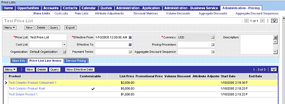

A simple product and a complex product with a component product are created. A price list is then created and the products are associated with it, as shown in the following figure.

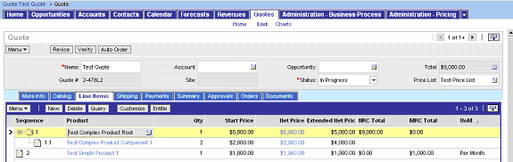

Products are added to the quote, as shown in the following figure. As expected, prices are stamped on each of the products, and all the steps under Internal Integration are performed to produce the prices.
Now, instead of using the Siebel application interface to create the quote, the following script is used to create the quote:
