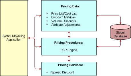

Siebel Pricer Architecture
A high-level representation of the Siebel Pricing Management Architecture is shown in the following. This diagram includes four key components:
  • Siebel UI or Calling Application. This is the point from which the end user requests pricing (for example, quotes and orders).
  • Pricing Data. This is the administrative business objects that store prices, costs, and adjustments.
  • Pricing Procedures. This is the centralized location for pricing policies and logic. Pricing procedures use the PSP engine to locate and apply prices and adjustments, and you can customize them for your company's business model. For details about the PSP Engine, see Siebel Order Management Infrastructure Guide.
  • Pricing Services. This is the specialized business services for generic, complex pricing algorithms (such as spread discount).

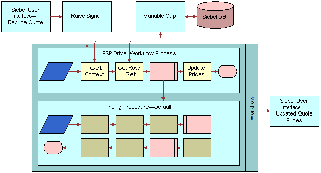

When there is a request for pricing (for example, when a user adds a product to a quote or order or selects Reprice All), the application performs the following steps, illustrated in the following figure:
  • The end user action raises a signal, such as the CalculatePriceAll signal. A signal is a parameterized call to a business service or workflow process. For more information about signals, see Siebel Order Management Infrastructure Guide.
  • The signal calls the controlling workflow process. To continue the previous example, the CalculatePriceAll signal calls the PSP Driver Workflow process. For more information about this workflow process, see Pricing Procedures and Workflow References.
  • The controlling workflow process uses variable maps to build the Context Row Set (header information) and Line Item Row Set (line item information).
    • The variable maps that build the row sets needed for pricing are identified in the definition of the signal invoked by the end user’s action. To continue the previous example, the Default Pricing Variable Map - Context and Default Pricing Variable Map - Row Set are specified as parameters to the PSP Driver Workflow process in the CalculatePriceAll Signal.
    • Variable maps build the row sets by mapping fields in the database to the variables for the row set. For more information about variable maps, see Siebel Order Management Infrastructure Guide.
  • The controlling workflow process invokes a pricing procedure.
    • The pricing procedure invoked is identified in the definition of the signal invoked by the end user’s action. To continue the previous example, the Dynamic Pricing Procedure workflow is specified in the SubPSPWFName parameter to the PSP Driver Workflow process in the CalculatePriceAll Signal.
    • The controlling workflow passes the Context Row Set and Line Item Row Set to the pricing procedure. For more information about controlling workflows and pricing procedures, see Siebel Order Management Infrastructure Guide.
  • The pricing procedure applies pricing logic to the data in the row sets.
    • To continue the previous example, for each line item in the line item row set, the Dynamic Pricing Procedure finds a starting price, executes a series of steps that may or may not adjust the net price, and outputs the final price.
    • The Dynamic Pricing Procedure passes the transformed Row Set back to the PSP Driver Workflow process. For detailed information about pricing procedures, see Pricing Procedures and Workflow References.
  • The Context Service updates the calling object (such as the quote or order) with the adjusted prices, and those prices appear in the end user interface.

PSP Driver Workflow Process Workflow
The PSP Driver Workflow Process is the beginning of all pricing operations and other features. For information about this workflow, see Siebel Order Management Infrastructure Guide.

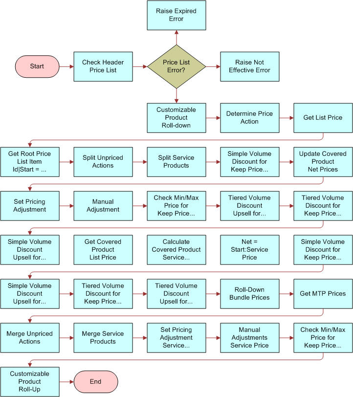

    Basic Pricing Procedure Workflow
    The Basic Pricing Procedure workflow, as shown in the following, provides basic pricer license functionality where the list price, volume discounts, and service pricing are supported.
    Workflow Description
    This workflow does the following:
    1. Stamps error codes by checking for various conditions on the Price list.
    2. From the error codes stamped in step 2, branches out to the different actions listed in step 4.
    3. Does the following:
      1. Raises Expired Error
      2. Raises Not Expired Error
      3. Calculates the quantity of each component in a customizable product instance, and rolls down the price list ID and promotion ID from the root.
    4. Determines the price action code based on the item’s Action Code and Price Type.
    5. Using the Simple Look-up Transform business service, searches for the correct price list and stamps various price fields on the line item.
    6. Gets Root Price List Item Id|Start = List|Net = Start.
    7. Splits Unpriced Actions.
      Note: Do not price line items with Skip Pricing Flag = 'Y'.
    8. Splits service and nonservice line items so they can be priced separately.
      Note: In this Pricing Procedure, products and service products need to be split and handled differently. Service procedures are services that are tied to products, for example, a maintenance service on a car. The pricing of a service is tied to the product it covers. Later in the this workflow, steps named " XXX service Pricing" will consume the Service Product Row Set.
    9. Applies the volume discount adjustment that matches the quantity on the line item.
    10. Finds out the upsell discount information.
    11. Applies tiered volume discounts to the net price.
    12. Finds out the tiered upsell discount information.
    13. Forces the net price to be within the minimum and maximum values defined in the price list item.
    14. Sets the manual adjustment and applies line item and header-level manual discounts.
    15. Sets the pricing adjustment. Before adjustments and discounts, the Net Price = Start Price.
    16. Updates the net price for any covered products that were repriced.
    17. Looks up the list price information for covered products.
    18. Calculates the start price for the service product by applying the percentage in the price list item to the net or start price of the covered product.
    19. Before adjustments and discounts, ensures that the Net Price = Start Price.
    20. Applies the volume discount adjustment that matches the quantity on the line item.
    21. Determines the upsell discount information.
    22. Applies tiered volume discounts to the net price.
    23. Determines the tiered upsell discount information.
    24. Applies line item and header-level manual discounts.
    25. Merges service and nonservice line items.
    26. Merges unpriced line items.
    27. Gets the MPT Prices and the NRC and MRC price components.
    28. Spreads discounts from bundle product root to subcomponents.
    29. Calculates the total extended price of the customizable product, including all subcomponents.

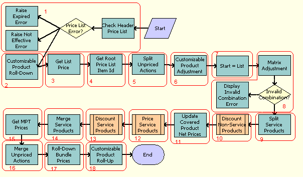

      Dynamic Pricing Procedure Workflow
      The Dynamic Pricing Procedure workflow, as shown in the following, provides the advanced pricing capabilities. It contains steps and subprocedures that populate the List Price, Start Price, and Net Price fields. It also calculates the monthly recurring and nonrecurring subtotals for root Customizable Products. These prices and subtotals are calculated based on information from price lists, customizable product adjustments, volume discounts, attribute adjustments, aggregate discounts, service price details, product promotions, and manual discounts.
      Note: The Dynamic Pricing Procedure replaces the Pricing Procedure - Default.
      Dynamic Pricing Procedure Workflow Process
      1. Checks for price list effectivity. The application will throw any error if the price list is not yet effective or has expired.
      2. Calculates the extended quantity of all component products of a CP instance. Also, it carries over some useful information from the CP root to CP components for later use.
      3. Gets the list price for each row in the row set, and appends other values from the Price List Item Buscomp to the row.
      4. Puts the CP Root Price List Item Id on each component of the CP for later use.
      5. Moves those rows with an action code that are not priced to another row set that will not be priced throughout the procedure.
      6. Gets CP Pricing Designer adjustments for components of a CP.
      7. Initializes the start price value as the list price value.
      8. Applies attribute adjustments to the start price and throws an error when an invalid combination for attribute pricing occurs.
      9. Moves service products from the row set into another row set for use in the service pricing subprocedure.
      10. Calls subprocedure Pricing Procedure - Calculate Net Price for nonservice products.
      11. Updates the covered product net price field on the service product rows in the row set.
      12. Calls subprocedure Pricing Procedure – Service to handle the service product-specific pricing for service products.
      13. Calls subprocedure Pricing Procedure - Calculate Net Price for service products.
      14. Merges the service and nonservice row sets into one row set.
      15. Establishes the NRC and MRC prices for one-time and monthly recurring price types, which will later be used for Customizable Product Rollup.
      16. Merges the priced and unpriced row sets into one row set.
      17. Spreads the discount of the root bundle products to the bundle component products.
      18. Rolls up the prices of component products to the CP root.

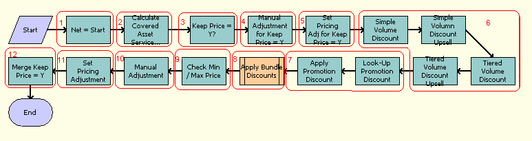

        Pricing Procedure - Calculate Net Price Workflow
        The Pricing Procedure - Calculate Net Price workflow, as shown in the following. is responsible for the net price calculation, which takes into account volume discount, aggregate discount sequence, product promotion, manual adjustment and minimum or maximum price bound checks.
        Pricing Procedure - Calculate Net Price Workflow Process
        1. Initializes the net price value as the start price value.
        2. Queries in FS Product Price Item Details Buscomp for any covered asset service pricing adjustment.
        3. Moves those rows with the Exclude Pricing flag set to another the Keep Price Row Set row set. This will skip all Siebel-Pricer-generated discounts throughout the procedure.
        4. Applies a manual adjustment (discount amount, discount percentage, discount price and header discount percentage) for the row set with Exclude Pricing flag Set.
        5. Sets the pricing adjustment that indicates the total amount of Siebel-Pricer-generated discount accounts for the row set with Exclude Pricing flag = Y.
        6. Evaluates simple and tiered volume discount. This would also populate the next discount and upsell message for upsell purposes.
        7. Evaluates product promotion discounts.
        8. Calls the Pricing Procedure - Bundle Discount subprocedure to evaluate the aggregate discount sequence.
        9. Checks whether the current net price is within the boundary of the minimum and maximum price.
        10. Applies a manual adjustment (discount amount, discount percentage, discount price and header discount percentage).
        11. Sets the pricing adjustment that indicates the total amount of Siebel-Pricer-generated discount accounts.
        12. Merges the two row sets generated from the Keep Price = Y? back into one row set.

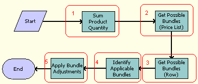

          Pricing Procedure - Aggregate Discounts Workflow
          The Pricing Procedure - Aggregate Discounts workflow, as shown in the following, is the subprocedure that evaluates the Aggregate Discount Sequence adjustment. The workflow first aggregates quantities for each product across line items. It then checks whether there are possible aggregate discounts set up by examining the price list on both the header and line item level.
          The workflow then compares the aggregate discount with the product quantity aggregation it has evaluated earlier to see whether it qualifies for any discounts.
          Pricing Procedure - Aggregate Discounts Workflow Process
          1. Groups line items by Product ID and performs a quantity aggregation. The result of this operation is a property set with Product ID and corresponding aggregated quantities.
          2. Uses Query Transformation to check if there is an Aggregate Discount Sequence associated with the price list from the header, and whether that Aggregate Discount Sequence is effective. If all conditions are met, then the list of IDs of all the aggregate discounts under that sequence would be stored in a property set.

            The following lists the steps in the Pricing Procedure - Aggregate Discounts workflow with the business service and method that is called by each step.
            Table Steps of the Pricing Procedure - Aggregate Discounts Workflow
            Name Type Business Service Method Sub Process Description
            Sum Product Quantity
            Business Service
            Row Set Transformation Toolkit
            Aggregate Transform
            Not applicable
            Sums up quantities of line items by Product ID.
            Get Possible Bundles (Price List)
            Business Service
            Row Set Transformation Toolkit Service
            Query Transform
            Not applicable
            Checks for the Aggregate Discount Sequence associated with the Price List from the Header.
            Get Possible Bundles (Row)
            Business Service
            Simple Look-Up Transform
            Not applicable
            Checks for the Aggregate Discount Sequence associated with the Price Lists from the Line Items.
            Identify Applicable Bundles
            Business Service
            Rule Set Look-Up Transform
            Not applicable
            Identifies applicable Aggregate Discounts and corresponding Multiplier.
            Apply Bundle Adjustments
            Business Service
            Not applicable
            Applies the adjustments defined in aggregate discounts.
