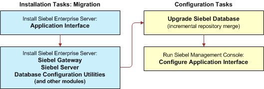

    • Existing installation of Siebel CRM 16.x or earlier (migration installation, with IRM). If you have an existing installation of a release prior to Siebel CRM 17.0, then you first install Siebel CRM 17.0 as a migration installation, and then install the current release of Siebel CRM 19.x. Documented requirements for Siebel CRM 17.x and later apply, such as for installing the software, running Incremental Repository Merge, running Siebel Management Console, and so on. See Roadmap for Installing Siebel CRM in a Migration Installation Case (Existing Installation).
      For more information, see About Database Updates for Siebel CRM 19.x Update. See also Siebel CRM Update Guide and Release Notes on My Oracle Support for the latest Siebel CRM 19.x Update release. For supported Siebel database upgrade paths and instructions for running Incremental Repository Merge, see Siebel Database Upgrade Guide.

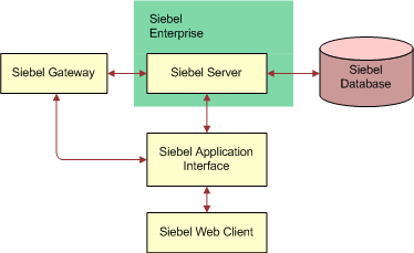

Overview of Siebel CRM Server Architecture
The following illustrates a simplified architecture for the server elements in your Siebel deployment, after you have initially installed and configured the software. For a more detailed illustration, see Siebel Deployment Planning Guide.
Simplified Architecture for a Siebel Deployment
The Siebel CRM installation and configuration process requires multiple tasks that you perform in a general sequence that depends on your installation case. For more information, see:

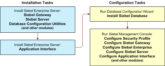

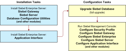

Roadmap for Installing Siebel CRM for a New Deployment
Use this roadmap to guide you in performing the installation and configuration tasks for deploying Siebel CRM, where there is no existing Siebel CRM installation and no existing Siebel database.
The following information presents a simplified view of the installation and configuration tasks for Siebel CRM server modules for a new deployment.
Note: This illustration does not mention installation or configuration tasks for Siebel Enterprise Cache, Siebel Constraint Engine, or the Siebel Migration application. However, those tasks, where applicable, are implicitly part of this roadmap. The Siebel Constraint Engine is available as a developer preview.
Installing and Configuring Servers for a New Deployment
Unless you use another authentication method, a Siebel database must exist before you can configure the Siebel CRM modules, in order to provide an authentication framework for the configuration tasks. You install Database Configuration Utilities with the first Siebel Server.
Note: For each applicable Siebel CRM module, you install Siebel CRM 19.12 Update after you install Siebel CRM 17.0 and before you install the Siebel database or configure the Siebel CRM products. For more information, see Installation-Related Changes for Siebel CRM 19.x Update.
The installation process for Siebel CRM for a new deployment requires multiple tasks that you perform in the following general sequence:
Use this roadmap to guide you in performing the installation tasks for deploying Siebel CRM, where there is an existing installation of a prior version. This is the migration installation case.
You use this roadmap when you have an existing Siebel CRM installation of a prior release of Siebel CRM (prior to Siebel CRM 17.0). You must perform the migration installation tasks for your existing installed Siebel CRM software.
Tip: For the upgrade case, where you are upgrading from a Siebel CRM release prior to version 8.1.1 or version 8.2.2, see Roadmap for Installing Siebel CRM in an Upgrade Case (Existing Database) instead. In an upgrade case, you also perform a full database upgrade instead of running Incremental Repository Merge. In general, this book uses the term migration to refer to a migration installation and uses the term upgrade to refer to a full database upgrade.
The following information presents a simplified view of the installation and configuration tasks for Siebel CRM server modules for a migration deployment.
Note: This illustration does not mention installation or configuration tasks for security, Siebel Enterprise Cache, Siebel Constraint Engine, or the Siebel Migration application. However, those tasks, where applicable, are implicitly part of this roadmap. The Siebel Constraint Engine is available as a developer preview.
Installing and Configuring Servers for a Migration Deployment
Note: For each applicable installed Siebel CRM module of a qualified version, you install Siebel CRM 19.12 Update after you install Siebel CRM 17.0 as a migration installation and before you run Incremental Repository Merge or configure the Siebel CRM products. For more information, see Installation-Related Changes for Siebel CRM 19.x Update.
This roadmap only summarizes the migration installation process and does not include details about required tasks. For example, you must do the following tasks after performing the migration installation tasks. See also Additional Tasks for Migration Installations.
Installing and Configuring Servers in an Upgrade Case
Note: For each applicable Siebel CRM module, you install Siebel CRM 19.12 Update after you install Siebel CRM 17.0 as a new installation and before you upgrade the Siebel database or configure the Siebel CRM products. For more information, see Installation-Related Changes for Siebel CRM 19.x Update.
This roadmap only briefly mentions the Siebel database upgrade tasks. Before you upgrade the database, you must have installed at least one Siebel Server with Database Configuration Utilities and installed Siebel Tools. For more information about upgrading, see About Installing in Upgrade Environments and see Siebel Database Upgrade Guide.
The installation process for Siebel CRM in an upgrade installation case requires multiple tasks that you perform in the following general sequence:
