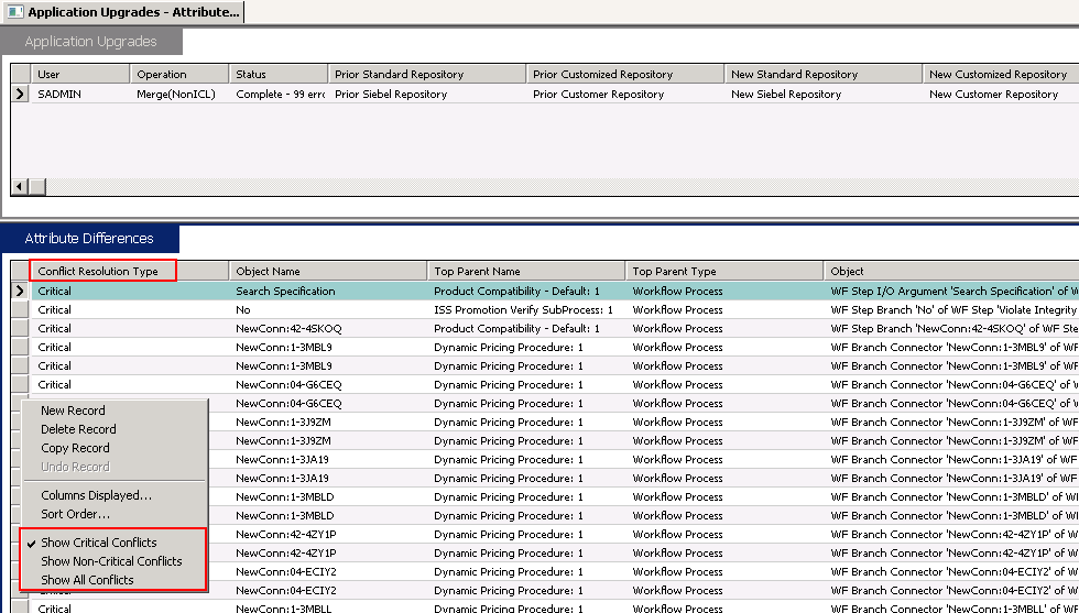

                                                                        Reviewing Object Property Conflicts
                                                                        You can review and change how object property conflicts were resolved using the Application Upgrade Attribute List view in Siebel Tools. The Attribute Differences List in the view includes the following columns:
                                                                        • Object Name. The name of the object.
                                                                        • Attribute. The object property name.
                                                                        • Conflict. The merge process puts a check mark in this field if there was an object property conflict during the merge.

                                                                            To review conflicts at the attribute level
                                                                            1. In Siebel Tools, from the Screens menu, choose Application Upgrader, and then Application Upgrade Attribute List.
                                                                              By default, you can see only the critical conflicts in the Application Upgrades Attribute differences view. You must review the critical conflicts. To view informational conflicts, right-click and select Show Non-Critical Conflicts. Noncritical conflicts include conflicts of attributes, such as Sequence number, Comments, Layout, and so on.
                                                                              This image shows the critical conflicts (in the Attribute Differences view) for the SADMIN Application Upgrade.
                                                                            2. In the Application Upgrades list, select the record of the successful merge.
                                                                            3. In the Attribute Differences list, click Query.
                                                                            4. In the Attribute Differences list, click in the Conflict field so that a check mark appears.
                                                                            5. Press Enter to run the query.
                                                                              The query displays a list of all object properties in which there is a conflict.
                                                                            6. For each record, review the entry in the Resolution field.
                                                                            7. To change the resolution, click in the Override field.
                                                                              A check mark appears that changes the value of the object property in the merged repository. Avoid overriding conflicts for the following object properties:

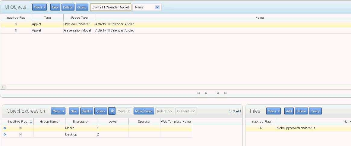

                                                                                    The following figure shows the UI Objects view with two Activity HI Calendar Applet UI object entries. One of these entries has a usage type of Renderer, while the other entry has a usage type of Presentation Mode. Two object expressions are shown in the Object Expression view: Mobile and Desktop, and in the Files view, the required JavaScript file is shown.
                                                                                    Activity HI Calendar Applet in UI Objects View, with Object Expressions and Files: This image is described in the surrounding text.
                                                                                    As the following example from an earlier version shows, the two separate renderings were implemented in the XML manifest file for the applet using the CalPR key:

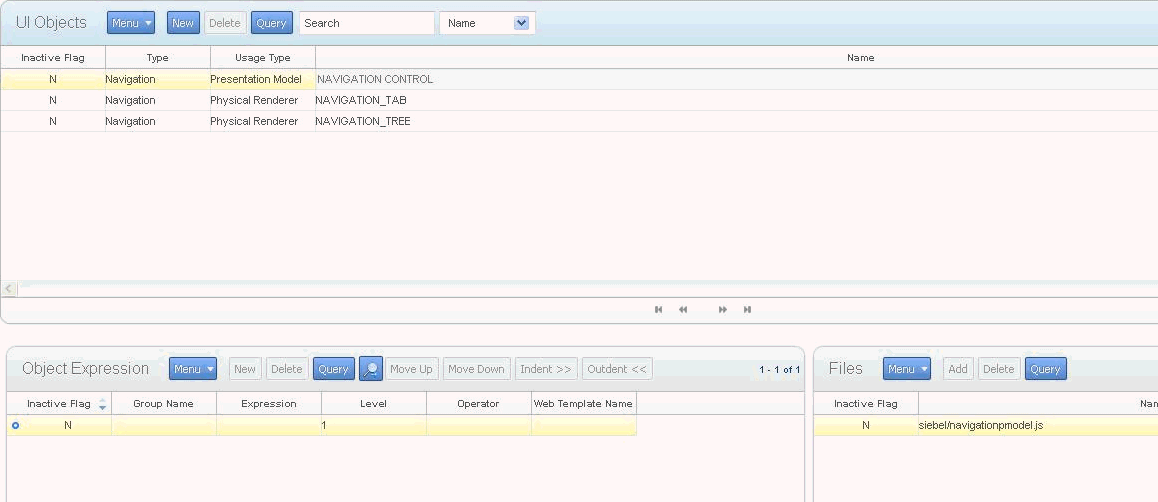

                                                                                          The following figure shows the entries for the navigation controls, such as ScreenPM, in the UI Objects screen. The Files view contains the following file: siebel/navigationmodel.js.

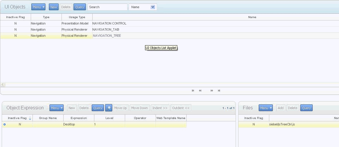

                                                                                          The following figure shows the entries for NAVIGATION_TREE. There is one entry in the Object Expression view: Desktop. The Files view contains the following file: siebel/jsTreeCtrl.js

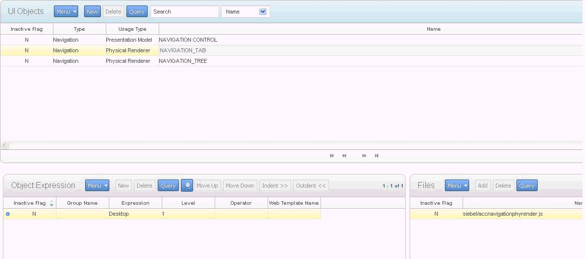

                                                                                          The following figure shows the entries for NAVIGATION_TAB. There is one entry in the Object Expression view: Desktop. The Files view contains the following file: siebel/accnavigationphyrender.js.

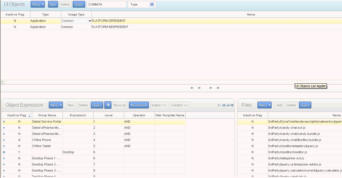

                                                                                          The files specified in the legacy manifest keys, RestOfUIPM and RestOfUIPR, are now located within the entries for UI Objects named PLATFORM_INDEPENDENT and PLATFORM_DEPENDENT. The following figure shows the migrated legacy manifest keys.
                                                                                          The migrated legacy manifest keys: Described in the surrounding text.
                                                                                          Files configured against a number of sections in the legacy manifest XML file are now part of these two UI Objects:
                                                                                          • PLATFORM DEPENDENT

                                                                                          Note: When processing Object Expressions Records to choose files for a given UI Object, the first Expression that evaluates to True is selected, and the file associated with it is downloaded to the browser. However, there is one exception. With the UI Object records of the Application type and Common usage type, all expressions in the Object Expression list are considered, and then they are aggregated and downloaded to the browser.
                                                                                            Differences Between Customer Manifest Data and Oracle Manifest Data
                                                                                            All manifest data that replaces the previous configuration in the core_manifest.xml file is seeded in the database that is packaged with the release of Siebel CRM version. You cannot change the Oracle manifest seed data. For any UI Objects record that has been seeded in the database by Oracle, the record itself and all child Object Expression records are read-only.
                                                                                            If you want to customize a given UI Object, then a separate high-level UI Objects record must be created, and the required Object Expression records must be created under it. For example, if a UI Object record with a Name value of Contact List Applet is seeded in the manifest database for the Usage Type Physical Renderer, and if you want to override the configuration with a different implementation of the Physical Renderer, then you must create a new UI Objects record with a Name value of Contact List Applet and a Usage Type value of Physical Renderer, and the Object Expression record you want to create and corresponding Files record must be entered.
                                                                                            Note: If you add a UI Objects record with the same Name, Type, and Usage Type values to a UI object that is already seeded in the Manifest database, then your newly created record is given precedence by the Manifest Runtime engine, and is used when evaluating true Object Expression values when choosing a File record to download. There is one exception, however. For UI Objects records with a Type value of Application and a Usage Type value of Common, both the Oracle seeded record and your new record are considered. The sum total of all the chosen Files for both the seeded record and your new record is aggregated and downloaded to the browser.
                                                                                              File Selection Rules
                                                                                              The following table shows file selection rules.
                                                                                              UI Object Record Values Oracle (Siebel?) Record Present User Created Record File Selection Rule
                                                                                              Type = 'Application' and Usage Type = 'Common'
                                                                                              Yes
                                                                                              No
                                                                                              All files against all winning expressions under the Oracle supplied UI Objects record are aggregated and downloaded to the browser.
                                                                                              Yes
                                                                                              Yes
                                                                                              All files against all winning expressions under both the Oracle supplied and user entered UI Objects record are aggregated and downloaded to the browser.
                                                                                              Usage Type != 'Common'
                                                                                              Yes
                                                                                              No
                                                                                              The file against the first winning expressions under the Oracle supplied UI Objects record is downloaded to the browser.
                                                                                              Yes
                                                                                              Yes
                                                                                              The file against the first winning expressions under the user entered UI Objects record is downloaded to the browser.
