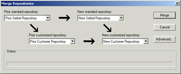

            12. From the Tools menu, choose Upgrade, then the Upgrade Application menu item.
              The Merge Repositories dialog box appears.
              In the Merge Repositories dialog box, there is an arrow going from Prior Standard Repository to New Standard Repository and then on to New Customized Repository. There is another arrow going from Prior Standard Repository to Prior Customized Repository and then on to New Customized Repository.
              The Merge Repositories dialog box provides four options:
              • Merge. This button merges the repositories you specify to produce a New Customer Repository.
              • Cancel. This button cancels the repository merge and exits the Merge Repositories dialog box.
              • Advanced. This button opens the Merge Options dialog box.
            13. In the Merge Repositories dialog box, choose the repositories listed in the following table.

            14. Click Advanced.
              The Merge Options dialog box appears.
