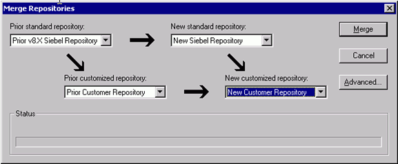

          5. Choose Tools, Upgrade, and then Upgrade Application.
            The Merge Repositories dialog box appears.
            In the Merge Repository dialog box, there is an arrow going from Prior Standard Repository to New Standard Repository and then on to New Customized Repository. There is another arrow going from Prior Standard Repository to Prior Customized Repository and then on to New Customized Repository.
            The Merge Repositories dialog box provides the following options:
            • Merge. This button merges the repositories you specify to produce a New Customer Repository.
            • Cancel. This button cancels the repository merge and exits the Merge Repositories dialog box.
            • Advanced. This button opens the Merge Options dialog box described in Step 8.
          6. In the Merge Repositories dialog box, choose the appropriate (repository name) value from each drop-down list - the following table specifies the repository name values.

          7. Review the settings in the Merge Repositories dialog box, then click Advanced.
            The Merge Options dialog box appears.
          8. In the Merge Options dialog box, click the following check boxes as appropriate:
            • Abort merge if more than n errors occur.
              This option aborts the repository merge automatically if more than a designated number of errors occur.
              Note: The typical repository merge generates many benign errors. If you select this option, set the number of errors to a large value. This will help prevent the repository merge from aborting due to benign errors.
            • Incorporate Custom Layout.
              Activate this option to help preserve field and button placement on prior custom or modified forms, views, and screens. Select a prior release and style for label placement.
              The Prior Release is the release you are upgrading from. The Placement of Labels controls where labels are placed in forms. As of Siebel CRM version 7.7, label alignment of fields changed. Label vertical alignment changed from top (where labels align to the upper part of a cell) to middle (where labels align to the centre of a cell), font weight changed from bold to normal, and text alignment changed from left (first character alignment) to right (last character alignment). Select Labels on Top and Labels on Left to preserve the look and feel of releases prior to Siebel CRM version 7.7.
          9. To continue, click OK.
          10. Click Merge on the Merge Repositories dialog box.

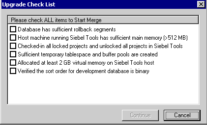

            The Upgrade Check List dialog box appears.
          11. In the Upgrade Check List dialog box, you must confirm that your environment meets the requirements for a successful repository merge. The Upgrade Check List has the following (check box) options:
            • Database has sufficient rollback segments.
            • Host machine running Siebel Toolss has sufficient main memory (>512 MB).
            • Checked-in all locked projects and unblocked all projects in Siebel Tools.
            • Sufficient temporary tablespace and buffer pools are created.
            • Allocated at least 2 GB virtual memory on Siebel Tools host.
            • Verified the sort order for development database is binary.
            Review each requirement and select the check box if your configuration meets or exceeds the requirement.
            This image is described in the surrounding text.
          12. To continue, click Continue. The merge process begins.
