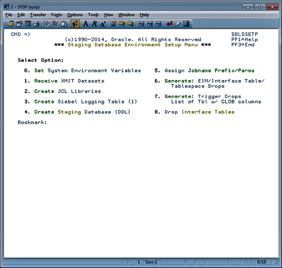

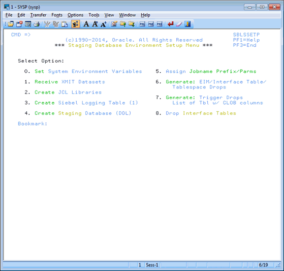

            The Staging Database Environment Setup Menu is displayed. The panel ID is SBLSSETP. The options on this panel allow you to prepare files and set environment variables to create the staging database.
            The Staging Database Environment Setup Menu options are: 0. Set System Environment Variables, 1. Receive XMIT Datasets, 2. Create JCL Libraries, 3. Create Siebel Logging Table (1), 4. Create Staging Database (DDL), 5. Assign Jobname Prefix/Params, 5. Generate: EIM/Interface Table/Tablespace Drops, 6. Generate: Trigger Drops List of Tbl w/ CLOB columns, 8. Drop Interface Tables.
          3. On the Staging Database Environment Setup Menu, select option 0: Set System Environment Variables.
            The Staging System Variable Definitions panel appears. The panel ID is SBLSETVP.

              Removing Interface Tables and Triggers
              Once you have build the staging database and prepared the upgrade environment on the z/OS host, the final task to complete before you generate the upgrade files is to remove triggers and EIM/Interface tables from the staging database. The following procedure describes this task.
              To remove EIM/Interface tables and triggers from the staging database
              1. On the Staging Database Environment Setup Menu, select option 6: Generate EIM/Interface Table/Tablespace Drops, and press Enter.
              2. Submit the JCL in the data set DSNHLQ.SIEBEL.pregen.jcl(PREGEN1). This job generates the EIM, Interface table, and table space DROP statements.
              3. Verify that the job ran successfully as described in Verifying JCL Upgrade Jobs.
              4. After submitting the job, enter cancel on the command line or press PF3 to save changes.
              5. On the Staging Database Environment Setup Menu, select option 7. Generate Trigger Drops List of Tbl w/ CLOB columns, and press Enter.
              6. Submit the JCL in the data set DSNHLQ.SIEBEL.pregen.jcl(PREGEN2). A list of trigger drops and tables with CLOB columns is generated.
              7. Verify that the job ran successfully.
              8. After submitting the job, enter cancel on the command line or press PF3 to save changes.
              9. On the Staging Database Environment Setup Menu, select option 8 Drop Interface Tables, and press Enter.
              10. Submit the JCL in the data set DSNHLQ.SIEBEL.install.jcl (INFDRPJS) to drop EIM and Interface tables from the staging database.
              11. Verify that the job ran successfully as described in Verifying JCL Upgrade Jobs.
              12. After submitting the job, enter cancel on the command line or press PF3 to save changes.
              This completes the process of creating a staging database. You can now generate the upgrade files.
