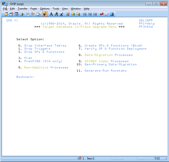

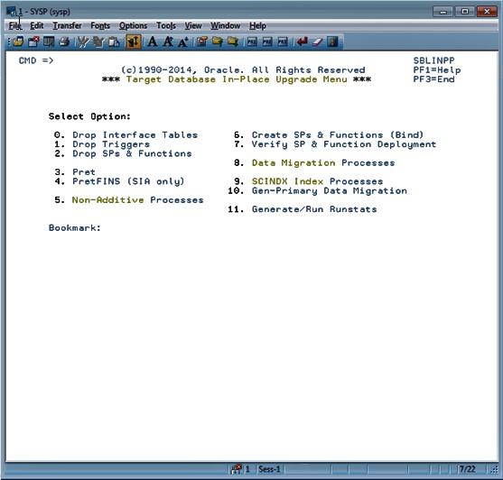

              Accessing the Target Database In-Place Upgrade Menu
              The Target Database In-Place Upgrade Menu provides options that allow you to perform all of these tasks. Perform the following procedure to access this menu:
              1. Access the Siebel In-Place Upgrade Main Menu by entering the following command:
                EXEC ’DSNHLQ.SIEBEL.EXEC’
              2. Select option 3: Target Database Processes - Upgrade, and press Enter.
                The Target Database In-Place Upgrade Menu is displayed. The panel ID is SBLINPP.
              The Target Database In-Place Upgrade Menu options are: 0. Drop Interface Tables, 1. Drop Triggers, 2. Drop SPs and Functions, 3. Pret, 4. PretFINS (SIA Only), 6. Create SPs and Functions (Bind), 7. Verify SP and Function Deployment, 8. Data Migration Processes, 9. SCINDX Index Processes, 10. Gen-Primary Data Migration, 11. Generate/Run Runstats.

                  Running the PRET Jobs for the Target Database
                  Perform the following procedure to run the PRET jobs to prepare the target database for table creation during the in-place upgrade.
                  To run the PRET jobs
                  1. On the Target Database In-Place Upgrade Menu, select option 3: Pret, and press Enter.
                  2. Run the job using the JCL in data set DSNHLQ.SIEBEL.INSTALL.JCL(SUBPRET).
                    This triggers the first PRET job, which then automatically submits the next PRET job in sequence. The number of PRET jobs that are automatically submitted varies according to your upgrade path.
                  3. Verify that the job ran successfully with a return code of 0. For information, see Verifying JCL Upgrade Jobs.
                  4. After submitting the job, enter cancel on the command line or press PF3 to save changes.
                    All jobs must complete successfully before you proceed to the next step.
                  5. On the Target Database In-Place Upgrade Menu, select option 4: PretFINS, and press Enter.
                  6. Run the job using the JCL in data set DSNHLQ.SIEBEL.INSTALL.JCL(SUBPRETF).
                    Note: You only have to perform this step if you are performing an Siebel Industry Applications upgrade.
                  7. Verify that the job ran successfully with a return code of 0. For information, see Verifying JCL Upgrade Jobs.
                  8. After submitting the job, enter cancel on the command line or press PF3 to save changes.
                    All PretFINS jobs must complete successfully before you proceed to the next step.

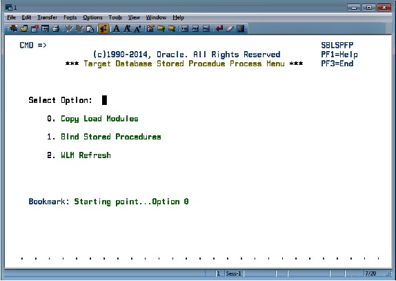

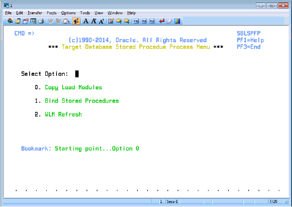

                                  Creating and Deploying Stored Procedures on the Target Database
                                  Perform the following task to install stored procedures and functions on the target database and to verify that they deployed correctly.
                                  To install and verify stored procedures
                                  1. On the Target Database In-Place Upgrade Menu, select option 6: Create SPs & Functions (Bind), and press Enter.
                                    A message appears telling you to use the instructions in the @README member to install the stored procedures and functions.
                                  2. Enter Y to continue, and press Enter.
                                    The Target Database Stored Procedure Process Menu is displayed.
                                    The Target Database Stored Procedure Process Menu options are: 0. Copy Load Modules, 1. Bind Stored Procedures, 2. WLM Refresh.
                                  3. On the Target Database Stored Procedure Process Menu, select option 0. Copy Load Modules, and press Enter.
                                  4. Run the job using the JCL in the data set DSNHLQ.SIEBEL.SP.CNTL(IEBCOPY).
                                    This job moves the stored procedure load modules into the WLMSPAS (this is the WLM load library you specified in Preparing the Upgrade Environment and Building the Staging Database).
                                  5. Verify that the job ran successfully with a return code of 0. For information, see Verifying JCL Upgrade Jobs
                                  6. After submitting the job, enter cancel on the command line or press PF3 to save changes.
                                  7. On the Target Database Stored Procedure Process Menu, select option 1. Bind Stored Procedures, and press Enter.
                                  8. Run the job using the JCL in one of the following data sets:
                                    • SNHLQ.SIEBEL.SP.CNTL(BINDHOR) for Siebel Business Applications upgrades
                                    • DSNHLQ.SIEBEL.SP.CNTL(BINDSIA) for Siebel Industry Applications upgrades
                                      This job binds the stored procedure packages.
                                      Note: If the job fails because the procedure already exists, run the appropriate DROP procedure job, either DSNHLQ.SIEBEL.SP.CNTL(DRPSIA) or DSNHLQ.SIEBEL.SP.CNTL(DRPHOR), then run the bind job again.
                                  9. Verify that the job ran successfully with a return code of 0 or 4. For information, see Verifying JCL Upgrade Jobs.
                                  10. After submitting the job, enter cancel on the command line or press PF3 to save changes.
                                  11. On the Target Database Stored Procedure Process Menu, select option 2. WLM Refresh, and press Enter.
                                  12. Submit the JCL in the data set DSNHLQ.SIEBEL.SP.CNTL(WLMREFSH).
                                    This job refreshes the DB2 WLM environment.
                                  13. Verify that the job ran successfully with a return code of 0. For information, see Verifying JCL Upgrade Jobs.
                                  14. Press PF3 twice to return to the Target Database In-Place Upgrade Menu.

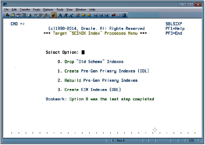

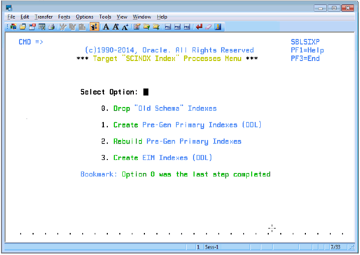

                                        Creating Schema Indexes
                                        Perform the following procedure to drop old schema indexes, create schema and EIM indexes for the current release, and submit the rebuild jobs for the 8.1 or 8.2 Gen Primary indexes for the target database.
                                        To run index jobs for the target database
                                        1. On the Target Database In-Place Upgrade Menu, select option 9: SCINDX Index Processes, and press Enter.
                                          The following message appears:
                                          Before proceeding, make sure ALL Data Migr “UPGISS jobs complete. Re-enter option 9 to continue...
                                        2. Reselect option 9: SCINDX Index Processes, and press Enter.
                                          The Target SCINDX Index Processes Menu is displayed. The panel ID is SBLSIXP.
                                          The Target SCINDX Index Processes Menu options are: 0. Drop Old Schema Indexes, 1. Create Pre-Gen Primary Indexes (DDL), 2. Rebuild Pre-Gen Primary Indexes, 3. Create EIM Indexes (DDL).
                                        3. Select option 0: Drop Old Schema Indexes, and press Enter.
                                          You are placed in edit mode on data set DSNHLQ.SIEBEL.INSTALL.JCL(GPDRPIX).
                                        4. Submit the JCL in the data set to drop the old schema indexes.

                                        7. On the Target SCINDX Index Processes Menu, select option 1: Create Pre-Gen Primary Indexes (DDL), and press Enter.
                                          You are placed in edit mode on data set DSNHLQ.SIEBEL.INSTALL.JCL(GPRIX).
                                        8. Submit the JCL in the data set to run the DDL to create the Pre-Gen Primary Indexes.
                                        11. On the Target SCINDX Index Processes Menu, select option 2: Rebuild Pre-Gen Primary Indexes (DDL), and press Enter. This job rebuilds the Pre-Gen primary indexes to create ROW_IDs for the data in the existing row.
                                          You are placed in edit mode on data set DSNHLQ.SIEBEL.INSTALL.JCL(SUBGPPIX).
                                        12. Submit the JCL in the data set.
                                          This job runs all the Pre-Gen Primary Index rebuild jobs in parallel. The number of index rebuild jobs that are run varies according to your upgrade path and the number of indexes you specified to be included in each rebuild job. See Restructuring the Index DDL for further information.
                                        13. Verify that the job ran successfully with a return code of 0 or 4. For information, see Verifying JCL Upgrade Jobs.
                                        14. After submitting the job, enter cancel on the command line or press PF3 to save changes.
                                        15. On the Target SCINDX Index Processes Menu, select option 3: Create EIM Indexes (DDL), and press Enter.
                                          You are placed in edit mode on data set DSNHLQ.SIEBEL.INSTALL.JCL(EIMIX).
                                        16. Submit the JCL in the data set to run the DDL to create new EIM indexes.
                                        17. Verify that the job ran successfully with a return code of 0 or 4. For information, see Verifying JCL Upgrade Jobs.
                                        18. After submitting the job, press PF3 to return to the Target Database In-Place Upgrade Menu.

                                          1. On the Target Database In-Place Upgrade Menu, select option 10: Gen_Primary Data Migration, and press Enter.
                                            You are placed in edit mode on data set DSNHLQ.SIEBEL.INSTALL.JCL(SUBGENP).
                                          2. Submit the JCL in the data set to update data in the target tables.
                                            This submits all the Gen-Primary data migration job streams (the number of job streams varies by upgrade type). All of the jobs are run in parallel as no dependencies exist between them.

                                            1. On the Target Database In-Place Upgrade Menu, select option 11: Generate/Run Runstats, and press Enter.
                                              Before proceeding, make sure ALL “Gen-Primary jobs completed. Re-enter option 11 to continue.
                                            2. Reselect option 11: Generate/Run Runstats, and press Enter.
                                              The Upgrade Runstats panel appears. The panel ID is SBLRSP.
                                            3. Read the information relating to the RUNSTATS jobs on the Upgrade Runstats panel, then press Enter to start the RUNSTATS job generation process.
                                            4. Messages are displayed as the jobs are generated. When the process is completed, press Enter.
                                              You are placed in edit mode on the PDS data set that contains the RUNSTATS jobs, DSNHLQ.SIEBEL.RUNST.
                                            5. Select the DSNHLQ.SIEBEL.RUNST(@RSTXREF) PDS member.
                                              This file contains information relating to each RUNSTATS job, for example, the table for which the job collects statistics and when statistics were last collected on the table.
                                            6. Select the RUNSTATS jobs you want to run and run each one individually using the JCL in the data set DSNHLQ.SIEBEL.RUNST(@RSTXREF).
                                              Alternatively, go to the DSNHLQ.SIEBEL.INSTALL.JCL(SUBRUNST) data set and submit the JCL in the data set to run all the RUNSTATS jobs for table spaces that did not have statistics collected during any of the previous upgrade processes.
                                            8. Press PF3 to save changes.
