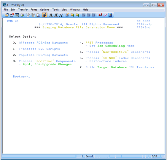

      2. On the Siebel Upgrade Main Menu, select option 1: File Generation, and press Enter.
        The Staging Database File Generation Menu is displayed. The panel ID is SBLSFGP.
        The Staging Database File Generation Menu options are: 0. Allocate PDS/Seq Datasets, 1. Translate SQL Scripts, 2. Populate PDS/Seq Datasets, 3. Process Additive Components - Apply Pre-Upgrade Changes, 4. PRET Processes - Set Job Schedulig Mode, 5. Process Non-Additive Components, 6. Process SCINDX Index Components - Restructure Indexes, 7. Build Target Database JCL Templates.

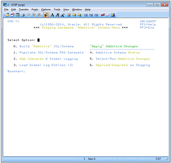

        1. On the Staging Database File Generation Menu, select option 3: Process Additive Components, and press Enter.
          The Staging Database Additive Schema Menu is displayed. The panel ID is SBLSADMP.
          The Staging Database Additive Schema Menu options are: 0. Build Additive JCL/Schema, 1. Populate JCL/Schema PDS Datasets, 2. Add Jobcards and Siebel Logging, 3. Load Siebel Log Entries (3), 4. Additive Schema Status, 5. Select/Run Additive Changes, 6. Applied/Complete on Staging.
        2. Select option 0: Build Additive JCL/Schema, and press Enter,
          Status messages are displayed as the additive components are built.
        3. On the Staging Database Additive Schema Menu, select option 1: Populate JCL/Schema PDS Datasets, and press Enter.
        4. Run the job using the JCL in data set DSNHLQ.SIEBEL.INSTALL.JCL(UNPKADD).
        5. Verify that the job ran successfully as described in Verifying JCL Upgrade Jobs. Verify that the return code is 0 and that the job populated the JCL and schema PDS data sets.
        6. After submitting the job, enter cancel on the command line or press PF3 to save changes.
        7. On the Staging Database Additive Schema Menu, select option 2: Add Jobcards & Siebel Logging, and press Enter.
          A message appears, asking you to confirm that the DSNHLQ.SIEBEL.PROC(ISPBAT) (ISPF batch procedure) is correctly configured.
        8. Verify that the ISPF batch procedure, dsnhlq.siebel.proc(ispbat), is modified to your installation standards, then enter Y to confirm and press Enter.
        9. Run the job using the JCL in data set DSNHLQ.SIEBEL.INSTALL.JCL(SUBJCL12). This job takes some time to complete.
        10. Verify that the job ran successfully with a return code of 0. For information, see Verifying JCL Upgrade Jobs.
          The JCL job card counts are displayed by job type. The number of jobs that are build for the additive components varies according to your upgrade path.
        11. After submitting the job, enter cancel on the command line or press PF3 to save changes.
        12. On the Staging Database Additive Schema Menu, select option 3: Load Siebel Log Entries (3), and press Enter. This option runs the job to load the Siebel logging table with additive entries for staging jobs.
        13. Run the job using the JCL in data set DSNHLQ.SIEBEL.INSTALL.JCL(LOADLOG2).
        14. Verify that the job ran successfully with a return code of 0. For information, see Verifying JCL Upgrade Jobs.
          Verify that additional log entries have been loaded to the TMP_SBLLOG_TAR table on the staging database.
        15. After submitting the job, enter cancel on the command line or press PF3 to save changes.
        16. On the Staging Database Additive Schema Menu, select option 4: Additive Schema Status, and press Enter.
          The Additive Schema Status panel is displayed. The panel ID is SBLSADLP. A list of the additive schema members is displayed and their staging status, either PENDING or COMPLETED.
        17. To view a member in browse mode, select the member by entering any nonblank character in the Opt column for the member (you can select more than one member to view on each panel).
        18. Press Enter. If you selected more than one member to view, press PF3 to move to the next member.

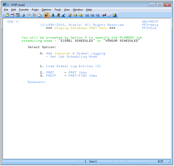

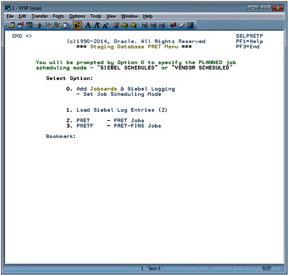

          1. On the Staging Database File Generation Menu select option 4: PRET Processes. The Staging Database PRET Menu is displayed. The panel ID is SBLPRETP.
            The Staging Database PRET Menu options are: 0. Add Jobcards and Siebel Logging - Set Job Scheduling Mode, 1. Load Siebel Log Entries (2), 2. PRET - PRET Jobs, 3. PRETF - PRET-FINS Jobs.
          2. To build job cards for the PRET and pretfins job types, on the Staging Database PRET menu, select option 0: Add Jobcards & Siebel Logging, and press Enter.
            Note: It is not necessary to set your preferred job scheduling method if you are using Siebel Scheduled mode which is implemented by default. If you want to use Vendor Scheduling mode, you must set the Scheduling option in the data set DSNHLQ.SIEBEL.EXEC(@PRETPTH) to a value of 2. For additional information, see Executing Jobs Using Siebel-Scheduled Mode or Vendor-Scheduled Mode.

            Messages are displayed indicating the job type (PRET, pretfins, or Household), the number of jobs built and the jobcards added.
          3. To load Siebel logging tables for the staging database upgrade jobs, on the Staging Database PRET Menu, select option 1: Load Siebel Log Entries (2), and press Enter.
          4. Submit the job using the JCL in data set DSNHLQ.SIEBEL.INSTALL.JCL(LOADLOG3).
          5. After submitting the job, verify that the job ran successfully with a return code of 0. For information, see Verifying JCL Upgrade Jobs. Verify that additional log entries have been loaded to the TMP_SBLLOG_TAR table on the staging database.
          6. To run the staging PRET processes, on the Staging Database PRET menu, select option 2: PRET - PRET Jobs, and press Enter.
          7. Submit the job using the JCL in data set DSNHLQ.SIEBEL.INSTALL.JCL(STGPRET).
            This triggers the first PRET job, which then automatically submits the next PRET job in sequence. The number of PRET jobs that are automatically submitted varies according to your upgrade path.
          8. After submitting the job, verify that the job ran successfully with a return code of 0. For information, see Verifying JCL Upgrade Jobs.
          9. To run the staging pretfins jobs, on the Staging Database PRET menu, select option 3: PRETF - PRET-FINS Jobs, and press Enter.

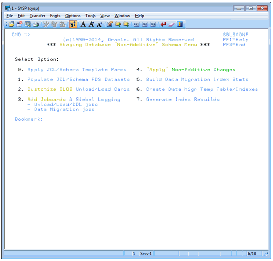

              1. On the Staging Database File Generation Menu, select option 5: Process Non-Additive Components, and press Enter.
                The Staging Database Non-Additive Schema Menu is displayed. The panel ID is SBLSADNP.
                The Staging Database Non-Additive Schema Menu options are: 0. Apply JCL/Schema Template Parms, 1. Populate JCL/Schema PDS Datasets, Customize CLOB Unload/Load Card, 3. Add Jobcards and Siebel Logging (Unload/Load/DDL jobs, Data Migration jobs), 4. Apply Non-Additive Changes, Build Data Migration Index Stmts, 6. Create Data Migr Temp Table/Indexes, Generate Index Rebuilds.
              2. On the Staging Database Non-Additive Schema Menu, select option 0: Apply JCL/Schema Template Parms, and press Enter.
                If you are performing a production environment upgrade, you are prompted to confirm that you have applied all planned additive changes to the staging database. Enter Y and press Enter.
                Messages are displayed indicating that changes are being applied to the Unload and Load data sets.
              3. On the Staging Database Non-Additive Schema Menu, select option 1: Populate JCL/Schema PDS Datasets, and press Enter.

              6. On the Staging Database Non-Additive Schema Menu, select option 2: Customize CLOB Unload/Load cards, and press Enter.

              8. On the Staging Database Non-Additive Schema Menu, select option 3: Add Jobcards & Siebel Logging to Unloads/Loads and Data Migration Jobs, and press Enter.

                1. On the Staging Database Non-Additive Schema Menu, select option 4: Apply Non-Additive Changes, and press Enter.

                  1. On the Staging Database Non-Additive Schema Menu, select option 5: Build Data Migration Index Statements, and press Enter.
                    Messages are displayed on screen indicating that data migration CEATE INDEX and DROP INDEX statements are being generated. The messages you receive depends on your upgrade path.
                  2. On the Staging Database Non-Additive Schema Menu, select option 6: Create Data Migration Temp Table/Indexes, and press Enter.

                  6. On the Staging Database Non-Additive Schema Menu, select option 7: Generate Index Rebuilds, and press Enter.

                        1. On the Staging Database File Generation Menu, select option 6: Process SCINDX Index Components - Restructure Indexes, and press Enter.

                          1. On the Staging Database File Generation Menu, select option 7: Build Target Database JCL Templates, and press Enter.
                            This option applies target database LPAR, Tableowner and STORGROUP values to the JCL templates that were created to run the preupgrade and upgrade (in-place) processes for the staging database so they are appropriate for the target database upgrade.
