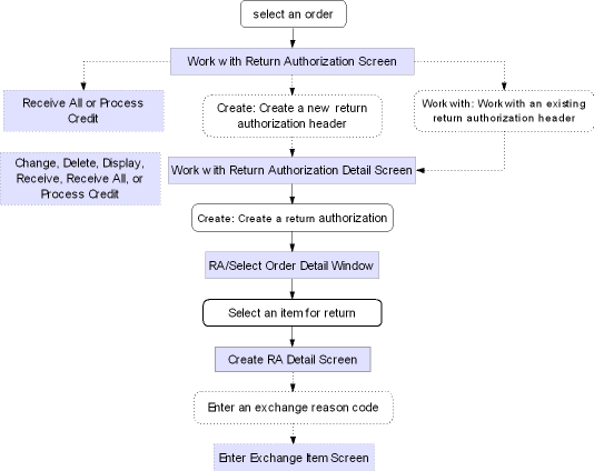

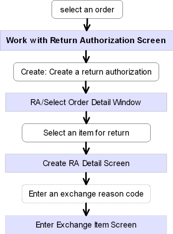

When you use the standard process, the screen you first advance to after selecting an order varies, depending on whether you have already created a return authorization for the order.
Selecting an order: The process you use to select an order for return authorization processing is the same regardless of whether you use the standard or streamlined process. See Selecting Orders for Return (WRTA).

When you are creating the first return authorization for an order:
When there is already a return authorization for the order:

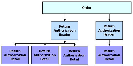

Order/header/detail structure: The relationship between the order and return authorization header and detail is illustrated in the chart below.
Each return or exchange of an item (detail record) must be associated with a header and an order. However, each order can have any number of return authorization headers, and each header can have any number of detail records.
