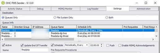

Click the settings tab, select the desired destination.
Right-click the Queue Info window and add a new Queue.

The settings tab shows direction groups, their transfer timings and MSMQ (Microsoft Message Queuing) level information. Direction groups can be added/edited and configured from here.Table 12-3 Direction Groups
| Name | Description |
ShipToShore |
Selection of tables that need to be transferred once a day. Set to transfer at 5 AM daily. |
Setup data |
All tables requiring transfer more than once a day. For example, table that gets changed frequently and /or impact the business. Set to transfer every 3 hours. |
Lob data |
All tables with Blob/picture fields are transferred separately as they take more time to transfer. They are also set to transfer once a day. Set to transfer at 6 AM daily. |
Trans-tables |
