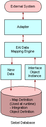

Siebel Data Mapper Overview
The Siebel Data Mapper provides you with a declarative interface to specify maps for both inbound and outbound data transformation. The maps you set up using the Siebel Data Mapper call the EAI Data Mapping Engine to complete the data transformation. Using the Siebel Data Mapper can often reduce or even eliminate the number of scripts you need to write. The following illustrates the Siebel Data Mapper architecture.
In this image, External System is connected by two-way arrow to Adapter. Adapter is connected by two-way arrow to EAI Data Mapping Engine. EAI Data Mapping Engine is connected to new Data and Interface Object Instance. New Data is connected to Siebel Database (Map Definition (Used at runtime) Integration Object Definition). Siebel Database is also connected to Interface Object Instance.
For data mapping within Siebel, Siebel applications now support two data mapping solutions, the Siebel Data Mapper and Siebel eScript Data Mapping. The Siebel Data Mapper has a declarative interface and requires no programming skills. The Siebel eScript Data Mapping uses scripts programmed in eScript as data maps. Because the Siebel Data Mapper is based on a declarative interface, it does not have the flexibility that script-based data mapping has. Use Siebel Data Mapper for most of your integration needs, except for complex mapping situations requiring aggregation, joins, or programmatic flow control.

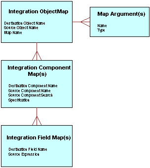

        The Siebel Data Mapper maps one integration object, source, to another integration object, target. Integration objects contain one or more integration components, which in turn contain one or more integration fields. For details on integration objects, see Integration Platform Technologies: Siebel Enterprise Application Integration.
        The following illustrates the Siebel Data Mapping Engine architecture.
        The EAI Data Mapping Engine Architecture. In this image, Integration ObjectMap (Destination Object Name, Source Object Name, Map Name) has a one-to-many relationship with Map Argument(s) (Name, Type). Integration ObjectMap has a one-to-many relationship with Integration Component Map(s) (Destination Component Name, Source Component Name, Source Component Search, Specification. Integration Component Map(s) has a one-to-many relationship with Integration Field Map(s) (Destination Field Name, Source Expression).
        A data map defines the relationship between source and target object format. The map controls the transformation process. Transformation maps are stored in the Siebel Database as explained in the following table.
        Map Type Siebel Data Table
        Integration Object maps
        S_INT_OBJMAP
        Integration Object Component maps
        S_INT_COMPMAP
        Integration Object Field maps
        S_INT_FLDMAP
          Integration Object Maps
          An integration object map is a high-level data map specifying mapping from one integration object to another. An integration object map contains one or more integration component maps and can optionally contain integration map arguments.
          Integration Map Arguments
          Data maps can be parameterized using integration map arguments. Map arguments can be referenced in any expression, including the integration field map expression, source search expression, precondition expression, and postcondition expression. For example, you may want to have a field map that creates an Order Number in the target object by prefixing the Order Number in the source object with a constant.
          You may want to use this map for orders coming from multiple partners and use a different prefix for each partner. To achieve this with a single data map, you can define an argument Prefix in the Integration Map Argument List, and use this argument Prefix in the field map source expression: [&Prefix]+[Order Number]. Then in the input method arguments in EAI Data Mapping Engine business service, you can specify any value for Prefix.
            Integration Component Maps
            Integration component maps specify how integration components in the source object get mapped to integration objects in the target object. For every occurrence of the source component in the source integration object instance, an instance of the target component is created in the target object instance. An integration component map contains one or more integration field maps. For details on integration component maps, see Creating Integration Component Maps.
              Integration Field Maps
              Integration field maps specify how fields in the source integration object are mapped to fields in the target integration component. An integration field map target is always a field in the target component of the parent component. An integration field map source can be a constant, a reference to a map argument, a field in the source component, or other legally addressable components such as ancestors of the source component. It can also be a Siebel Query Language expression using one or more of the preceding elements.
              Note: For details on integration field maps, see Creating Integration Field Maps. For details on addressing fields in components other than the source component, see Addressing Fields in Components. For details on Source Expression, see Source Expression.
