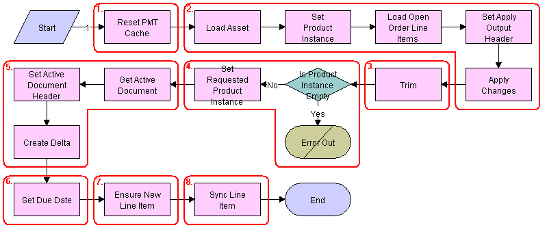

Workflow to Edit Quote Line Items
This workflow allows a user to edit the line items of quotes that result from creating or modifying service items. It consists of the workflow process SIS OM Edit Delta Quote Line Item.
This workflow applies active and unprocessed orders to the asset associated with the selected line item and displays the asset in the Product Configurator view. The user makes changes to define the newly requested state and clicks the Done button. The workflow writes the delta of the current and requested states of the asset to the current quote as 1 or more line items. This workflow is shown in the following figure.
A user initiates this workflow by clicking Customize in the Quote Detail view.
Workflow Description
This workflow does the following:
Clears business service cache of existing product instances.
Checks the action code of the high-level component in the order line item. If the action code is Add, then goes to Step 7.
If the action code is not Add, reads the asset associated with the selected quote line item from the database. Components with a status of Inactive are excluded.
Retrieves all prior active and unprocessed orders that relate to the asset and applies them to generate the requested future state of the asset.
Removes all asset components that do not have the 'Track As Asset' flag set.
If one of the active and unprocessed orders disconnects the high-level component, or there are asset components with the 'Track As Asset' flag set, then the resulting asset is empty. The workflow displays the following error message: A request has already been made to disconnect this service item. The workflow stops.
Applies the current quote line item to the asset.
Stores the quote header so that line items can be added to it.
Self-heals the asset such that the asset structure matches the product definition. If any changes are made to the asset, then a warning message appears.
Displays the currently requested state of the asset in the Product Configurator view. The user makes the required changes and clicks the Done or Cancel button.
If the user clicks the Cancel button, then the workflow is terminated. If the user clicks the Done button, then the newly requested state is retrieved from the Configurator.
If the action code of the root item is not Add, caches the previously requested state of the asset to be used as an input to Delta.
Generates the delta of the following as 1 or more quote line items:
The requested state of the asset before the current order line item was applied.
The state of the asset after the user has reconfigured it.
Writes the quote line item to the database and refreshes the view.

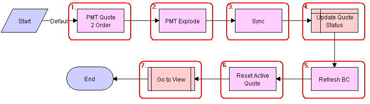

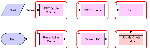

Workflow to Convert a Quote to an Order
This workflow allows a user to convert a sales quote to a sales order. It consists of the workflow processes:
SIS OM Quote To Order PMT Version
This workflow creates an order that is associated with the current quote. It copies the line items from the quote to the order and sets the quote’s status to Order Placed. This workflow is shown in the following figure.
A user initiates this workflow by choosing the Sales Order button or menu option in the Quote Orders view.
Converts a quote to an order. The new order has all the line items and attributes of the quote.
Explodes line items with a quantity greater than 1 into multiple copies of the line item, each with quantity 1.
Writes the order to the database.
Set the status of the quote to Order Placed.
Refreshes the Quote Orders View.
Resets the Active Quote so that the current quote is no longer the active quote.
Associated Business Service Methods
The following table shows the steps in this workflow that call business service methods.
| Workflow Step | Business Service Method Called |
| PMT Quote 2 Order |
Convert Product Instance |
| PMT Explode |
Explode |
| Sync |
Synchronize |
| Refresh BC |
Refresh Business Component |
| Reset Active Quote |
Set Profile Attribute |

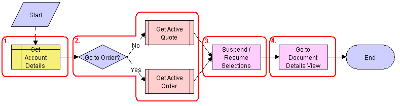

CUT Quote To Order PMT Enhancement - Sub-process
This workflow displays the Order Entry - Line Items view.
The CUT Quote To Order PMT Enhancement workflow initiates this workflow. The workflow is shown in the following figure.

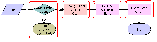

Workflow to Submit an Order
This workflow allows a user to submit an order, which signals the provisioning application that the order is ready to be provisioned. It consists of the workflow process: SIS OM Submit Order Process.
This workflow checks that account information exists. It sets the status of the order and the line items to Open. Because only orders that do not have a status of Open can be submitted, this prevents the order from being submitted again. This workflow is shown in the following figure.
A user initiates this workflow by clicking the Submit button on the order header form in the Order Entry views. The Submit button is hard coded to call this workflow.
Checks that the order status is not Open.
If the order has a status of Open, then it cannot be submitted, because it has already been submitted.
Sets the status of the order to Open.
Sets the status of each Pending line item to Open.
Resets the Active Order such that the current order is no longer the active order.

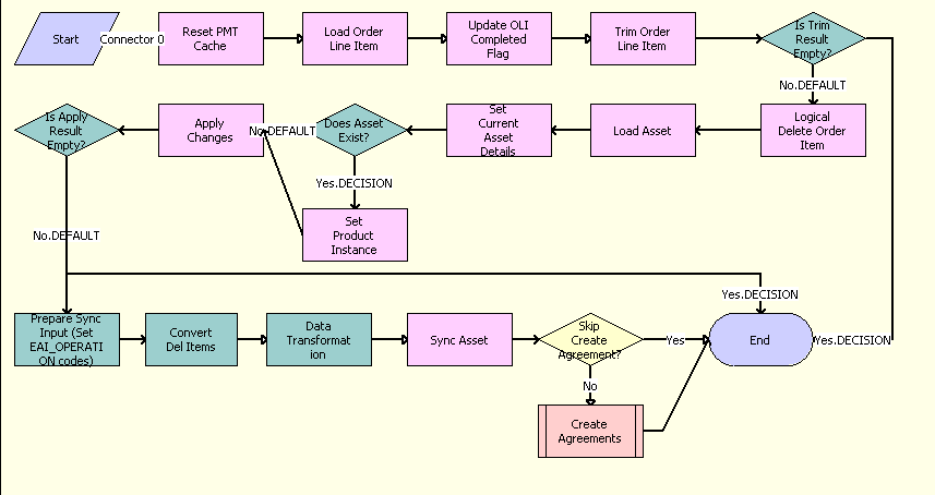

This workflow applies a completed order line item to the current account’s service profile:
SIS OM Apply Completed Service Order Line Item to Service Profile
This workflow creates assets from completed order line items or modifies a current asset. It therefore maintains the account’s service profile, which consists of its associated assets. If there are multiple accounts in an account hierarchy, then service items are applied to the service account. This workflow is shown in the following figure.
You must develop an order synchronization workflow that updates the status of order line items in your Siebel Business Application when your company’s external order management application completes all or part of an order. After it updates all the order items, the order synchronization workflow must call this workflow to apply the completed changes to the customer’s service profile, which is stored as a series of assets. You can disable this workflow if an external application maintains service profiles.
By default, a user initiates this workflow by clicking the Auto-Asset button in the Order Entry - Order Line Items view.
Reset PMT Cache. Clears business service cache of existing product instances.
Load Order Line Item. Loads the selected order line item from the database.
Update OLI Completed Flag. Updates the Order Item Processed flag. The workflow updates the Order Item Processed flag of the topmost order line item. The workflow sets this flag to Y if all line items have a status of Complete, Failed, or -. Other workflows use this flag to determine whether a line item remains Open and must be applied to the current service profile to generate a requested future state.
Note: To set the flag for the other status values, add these status values to this step’s I/O Argument Complete Statuses. The default value is: Complete, Rejected.Trim Order Line Item. Applies the Trim method. Trim eliminates any incomplete or failed changes from the order line item. It eliminates line items whose products are not tracked as assets, line items whose status is not Complete, and line items whose action code is Existing. This causes the service profile to reflect the true state of the assets.
Note: To keep the line items with the other status values, add these status values to this step’s I/O Argument KeepSpec. The default value is: (([Status] = LookupValue('FS_ORDER_STATUS', 'Complete')) OR ([Action Code] = LookupValue('DELTA_ACTION_CODE', 'Existing'))) AND ([Convert To Asset Flag] = 'Y').Is Trim Result Empty? Checks whether line items exist. If Trim has eliminated all line items, then the workflow stops. Otherwise, the workflow continues.
Logical Delete Order Item. Converts Delete actions into Modified actions. The Logical Delete step converts Delete actions into Modified actions and sets the status to Inactive. This step supports the maintenance of a history of disconnected services.
Load Asset. Loads the service profile from the database. If the order line item is a change to an existing item, then the workflow loads the corresponding service profile, or asset, from the database.
Set Current Asset Details. Uses the SetOldAssetDetails method of the ISS Promotion Agreement Manager business service to store Row Id of the current asset, the Integration Id of the current asset, the Row Id of the promotion associated with the current asset, the Promotion Instance Id of the current asset, and so on, in internal storage, so these IDs can be used by the GetPromotionDetails method.
Does Asset Exist? Checks whether there are any existing assets, that is, whetherthe number of assets is greater than 0.
Set Product Instance. Calls the Set Product Instance method of the Set Product Instance business service, which loads the product instance of the asset if any asset exists. The next step, Apply Changes, applies to the product instance of the asset that is loaded in this step.
Apply Changes. Applies changes related the order line item to the asset. If the asset does not already exist, then the workflow creates a new asset.
Is Apply Result Empty? Checks whether the asset is empty. If, as a result of applying the changes, the asset is empty, then the workflow stops. Otherwise, the workflow writes the asset to the database.
Prepare Sync Input (Set EAI_Operation Codes). Determines the operation that will be used, Insert, Update or Delete. This operation is entered in the Operation field of the Siebel Message. Based on the value of this field, the Sync Asset step determines which operation to perform.
Convert Del Items. Uses the ConvertDelItemsFieldToChildren method of the SIS OM PMT Service business service to convert the details of deleted products from Line Item fields to Integration Component MACD Order User Deleted Item structure, which will be used to update the deleted item details in the asset table.
Data Transformation. Uses the Execute method of the EAI Data Transformation Engine business service to transfer the asset hierarchy from Header - Line - XA to Line -XA. The header and line items business components are based on the same table, and this reduced hierarchy reduces the time taken to synchronize the data in the table.
Sync Asset. Uses the Synchronize method of the EAI Siebel Adapter business service to synchronize the updated asset structure to the Asset tables.
Skip Create Agreement. Determines whether or not a new agreement is created based on the input value of Skip Agreement.
Create Agreements. Calls ISS Promotion Agreement Management Sub Process workflow, which creates a new agreement or updates an existing agreement.
| Reset PMT Cache |
Reset |
| Update OLI Completed Flag |
Update Order Line Item Completed Flag |
| Trim Order Line Item |
Trim |
| Logical Delete Order Line Item |
Logical Delete |
| Apply Changes |
Apply |
| Set Product Instance |
| Sync Asset |
Synchronize |

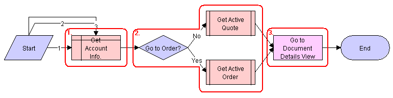

SIS OM New Products & Services Process
This workflow displays the active document, if there is one, or a newly created document in the Quote Detail or Order Entry - Line Items view. The user can then add line items, add or delete an asset, or change the attributes of the asset. This workflow is shown in the following figure.
A user initiates this workflow by clicking the New button in the Account screen’s Service Items view, or Account Summary view. This workflow is also initiated as a subprocess of the SIS OM New Products & Services Process - VORD.
Gets the account information.
If the account is of type 'Residential', then the workflow retrieves the active order. Otherwise it retrieves the active quote.
The workflow retrieves the active document (quote or order) from the session. If there is no active document, then a new document is created and set as the active document. If there is an active document, then the subprocess checks that the document is associated with the same customer account as the asset being modified, and that the document has the correct status. See SIS OM Active Quote Sub-Process and SIS OM Active Order Sub-Process. If the quote does not meet these criteria, then the workflow creates a new document and sets it as the active document.
Displays the document in the Quote Details or Order Entry - Line items view, as appropriate.

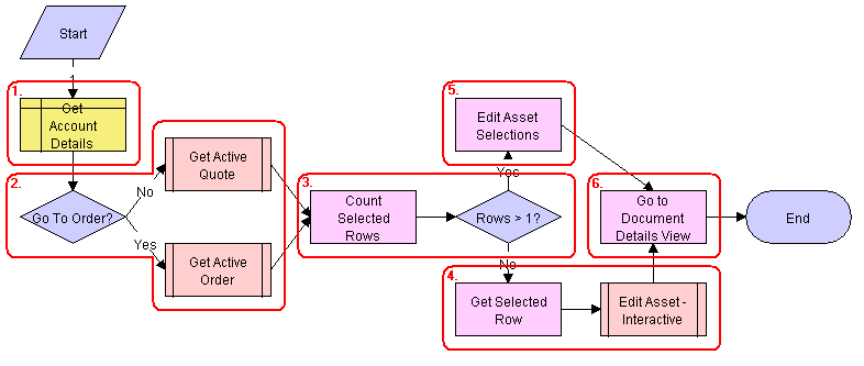

SIS OM Modify Products & Services Process
This workflow determines whether there is an active quote for the current account. If there is no active quote, then it creates a new quote. It generates a quote line item to update the selected asset. If the product is a product with components, then the workflow displays the service item in Configurator with all related open orders applied to it. Otherwise, it displays the Quote Detail view. This workflow is shown in the following figure.
A user initiates this workflow by clicking the Modify button in the following views:
Accounts screen, Service Items view
Accounts screen, Account Summary view
Networks screen, Nodes view
Networks screen, Connections view
Networks screen, All Elements view
Orders screen, Order Entry - Line Items view
Gets the details of the current account.
Retrieves the active document (quote or order) for the session.
If the account is of type 'Residential' then the active order is retrieved. Otherwise the active quote is retrieved. See SIS OM Active Quote Sub-Process and SIS OM Active Order Sub-Process.
Gets the number of assets that the user has selected to modify.
If the user has selected only one asset, then the currently requested state of the asset is retrieved and displayed in the Product Configurator view. See SIS OM Edit Complex Asset Workflow.
If the user has selected more than one asset, then the currently requested state of each asset is retrieved and added to the active document. See SIS OM Edit Complex Asset Workflow.
Displays active document.

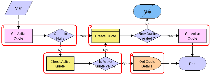

This workflow determines whether the user has an active quote for the current account. The workflow has two process properties that are set by the calling workflow: the Row ID of the customer account associated with the asset and the Row ID of the active quote. This workflow is shown in the following figure.
The following workflows initiate this workflow as a subprocess:
SIS OM Disconnect Products & Services Process
SIS OM Suspend / Resume Products & Services Process
Retrieves the active quote for the session and checks that there is a value.
If there is no active quote, then a new quote is created and set as the active quote.
If there is an active quote, determines whether the quote is associated with the same customer account as the asset being modified, and whether the quote has a status of In Progress. If the quote is not valid, then a new quote is created and set as the active quote.
If the new quote is valid, retrieves the price list Id and the currency code associated with the quote and returns them to the calling workflow.

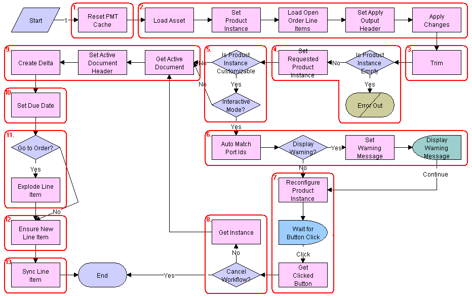

This workflow applies the open and pending orders related to the selected asset and displays the requested state in the Product Configurator view. After the user makes the changes that specify the newly requested state, the workflow writes the delta of the two requested states as quote line items and adds them to the active quote. This workflow is shown in the following figure.
The SIS OM Modify Products & Services Process initiates this workflow.
Clears the business service cache of existing product instances.
Reads the asset from the database.
Only components that do not have a status of Inactive are included. The changes specified by all the open and pending orders related to the asset are applied to it to re-create the state of the service product as the customer has requested.
Removes components from the asset that do not have the 'Track As Asset' flag set.
Determines whether an open or pending order disconnects the root component. If one of the open or pending orders disconnects the root component, or there are no components of the asset with the 'Track As Asset' flag set, then the workflow returns an empty asset and displays an error message.
Tests for a customizable asset and interactive mode.
If the asset is customizable and the workflow is in interactive mode, then the asset is displayed in the Product Configurator view, where the user can make changes to it. If the asset is not customizable or the workflow is not in interactive mode, then it goes directly to Step 9.
The future requested state of the asset is displayed in the Configurator view.
The workflow retrieves the active document. The delta of the previously requested state of the asset and the newly requested state of the asset are added as line items.
Sets the due date for all the line items.
If the active document is an order, then the line items with a quantity greater than 1 are exploded into multiple copies of the line item, each with quantity 1.
Generates a unique asset integration Id for all line items with an action code of Add.
Saves the document to the database and refreshes the view.
Reset PMT Cache |
Reset |
Load Open Order Line Items |
Find Orders |
Set Apply Output Header |
Set Output Header |
Apply Changes |
Apply |
Trim |
Trim |
Set Requested Product Instance |
Auto Match Port Ids |
AutoMatch |
Reconfigure Product Instance |
Get Clicked Button |
Get Cfg Button Click Information |
Get Instance |
Get Product Instance |
Set Active Document Header |
Set Output Header |
Create Delta |
Delta |
Set Due Date |
Set Field Value |
Explode Line Item |
Explode |
Ensure New Line Item |
Set Field Value |
Sync Line Item |
Synchronize |

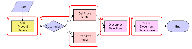

This workflow identifies an active document (quote or order) for the current account. Then it generates a line item to disconnect the selected asset and displays the document detail view. This workflow is shown in the following figure.
A user initiates this workflow by clicking the Disconnect button in the following views:
If the account is of type 'Residential', then the active order is retrieved. Otherwise, the active quote is retrieved. See SIS OM Active Quote Sub-Process and SIS OM Active Order Sub-Process.
Allows the user to disconnect the asset.
The workflow gets the asset's current state and then creates quote line items to disconnect the asset in that state. See SIS OM Disconnect Asset Sub-process.
Note: When deleting a network node, the process will automatically delete all associated network connections. If this is not desirable behavior, then change the value of the Delete Connection argument to N.Displays active document.

Sets the due date for the line items.
Generates a new asset integration ID for any line item with an action code of Add.
Saves the document to the database.
Reset PMT Cache |
Reset |
Find Orders |
Set Output Header |
Apply Changes |
Apply |
Trim |
Trim |
Set Output Header |
Create Delta |
Delta |
Set Due Date |
Set Field Value |
Set Field Value |
Sync Line Item |
Synchronize |

This group of workflows allows a user to suspend or resume a service. It consists of the workflow process and subprocesses:
This workflow identifies an active document for the current account. Then it generates a line item to suspend or resume the selected asset and displays the document detail view. This workflow is shown in the following figure.
A user initiates this workflow by clicking the Suspend or Resume button in the following views:
Allows the user to suspend or resume the asset.
The workflow gets the asset's current state and then creates quote line items to suspend or resume the asset in that state. See SIS OM Suspend / Resume Asset Sub-process.
| Suspend / Resume Selections |
Iterate Process For Selected Rows |
| Go to Document Details View |
GotoView |

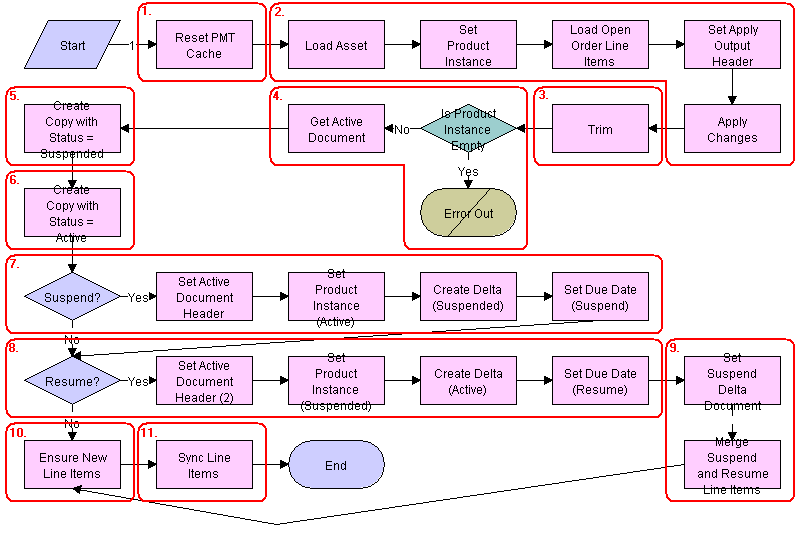

This workflow applies the open and pending orders related to the selected asset to get its requested state. Then it creates line items to suspend or resume the selected asset in that state. It adds these line items to the active document. This workflow is shown in the following figure.
The SIS OM Suspend / Resume Products & Services Process initiates this workflow.
The workflow includes only components that do not have a status of Inactive. The workflow looks for all the orders with a status of Open or Pending that are related to the selected asset. The workflow applies the changes specified by those orders. This re-creates the state of the service product as the user has requested it.
Removes any components from the asset that do not have the 'Track As Asset' flag set.
Displays an error message if the asset is empty.
If one of the open or pending orders disconnects the root component, or there are no components that have the 'Track As Asset' flag set, then the result is an empty asset. In this case, the workflow displays an error message.
Copies the asset and sets the status of each component to 'Suspended'.
Copies the asset and sets the status of each component to Active.
If the Suspend button was clicked, then the workflow generates the delta of the requested state of the asset and the future suspended state of the asset. This creates line items to suspend the asset. Sets the due date for each line item.
If the resume button was clicked, then the workflow generates the delta of the requested state of the asset and the future active state of the asset. This creates line items to resume the asset, and it sets the due date for each line item.
Merges the line items of the suspend and resume requests into a single document.
Generates a new asset integration Id for any line item with an action code of Add.
Reset PMT Cache |
Reset |
Find Orders |
Set Output Header |
Apply Changes |
Apply |
Trim |
Trim |
Create Copy with Status = Suspended |
Set Field Value |
Create Copy with Status = Active |
Set Field Value |
Set Output Header |
Set Requested Product Instance (Active) |
Create Delta (Suspended) |
Delta |
Set Due Date (Suspend) |
Set Field Value |
Set Active Document Header (2) |
Set Output Header |
Set Requested Product Instance (Suspended) |
Create Delta (Active) |
Delta |
Set Due Date (Resume) |
Set Field Value |
Set Suspend Delta Document |
Merge Suspend and Resume Line Items |
Merge |
Set Field Value |
Sync Line Item |
Synchronize |

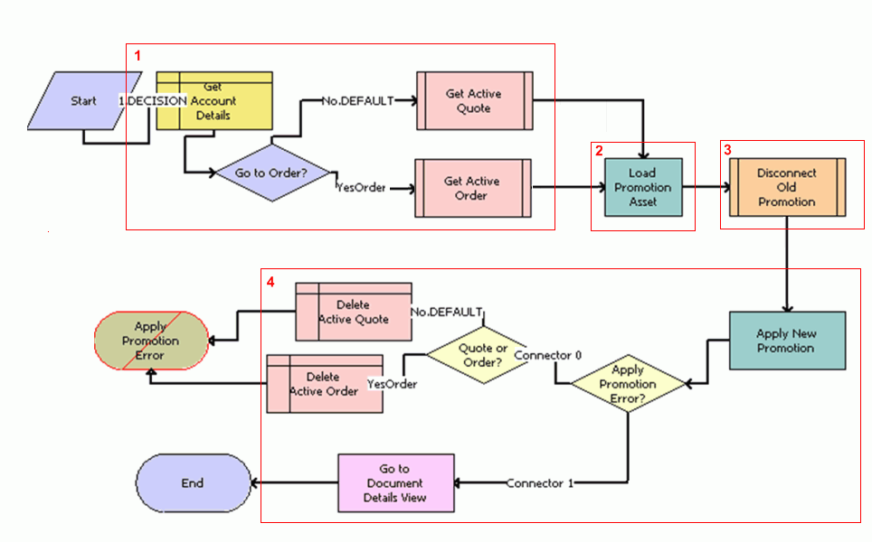

ISS Promotion Upgrade Process
This workflow, shown in the following figure, upgrades one promotion to another promotion. ISS Promotion Upgrade Process is initiated by a user when the user upgrades an existing promotion.
Get Account Details. This step gets the account details, and:
If linked to an order, gets the active order.
If linked to a quote (which is the default), gets the active quote.
Load Promotion Asset. This step loads the promotion asset.
Disconnect Old Promotion. This step disconnects the old promotion.
Apply New Promotion. This step applies the new promotion, and:
If errors are generated on applying the promotion, then it deletes the active document (order or quote) obtained in Step 1.
Otherwise, it goes to the document details view.
Load Promotion Asset |
LoadPromAsset |
Apply New Promotion |
ApplyPromotion |

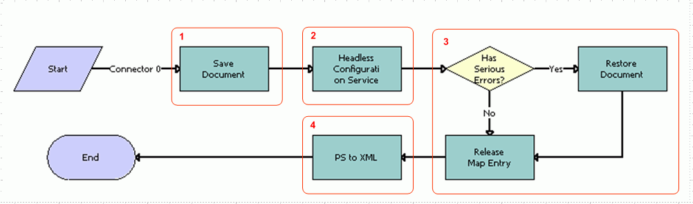

Headless Configuration Web Service
The Headless Configuration Web Service is a wrapper workflow for using Promotion AutoMatch functionality from Web services. This workflow, shown in the following figure, calls the Headless Configuration Service.
Save Document. This step saves the current document.
Headless Configuration Service. This step calls the Headless Configuration Service.
Has Serious Errors? This step determines whether errors have been generated:
If errors were generated, then the document is restored to its original format.
If no errors were generated, then the map entry is released.
PS to XML. This step converts output property set to XML.
Save Document |
Save Document |
Headless Configuration Service |
Apply Promotion Defaults |
Restore Document |
Restore Document |
Release Map Entry |
Release Map Entry |
PS to XML |
PropSetToXML |

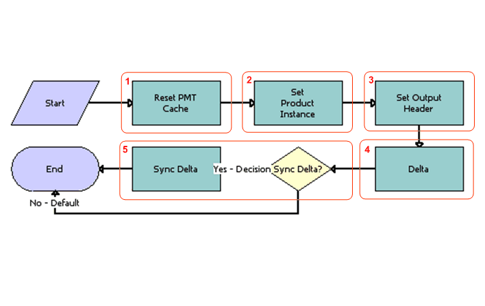

SIS OM Sync Delta Subprocess
This workflow, shown in the following figure, is called by the Headless Configuration Service to synchronize the changes to the customizable product line item. The asset based ordering difference between the batch validated asset and the original asset is calculated, and that is applied to the document.
This workflow is called by the HdlsCfgSvcSyncABO signal.
Reset PMT Cache. This step resets the cache to prevent an incomplete workflow from entering the PMT cache.
Set Product Instance. This step sets the product instance.
Set Output Header. This step sets the output header.
Delta. This step calls the Delta method of the SIS OM PMT Service to compare the modified asset against the original asset.
Sync Delta? This step checks if the decision is to synchronize the change:
If the decision to synchronize is Yes, then synchronizes the change.
This decision is controlled by the Sync input argument of the Headless Configuration Service business service.
If the decision to synchronize is No (which is the default), then the process ends.
Reset PMT Cache |
Reset |
Set Output Header |
Set Output Header |
Delta |
Delta |
Sync Delta |
Synchronize |
