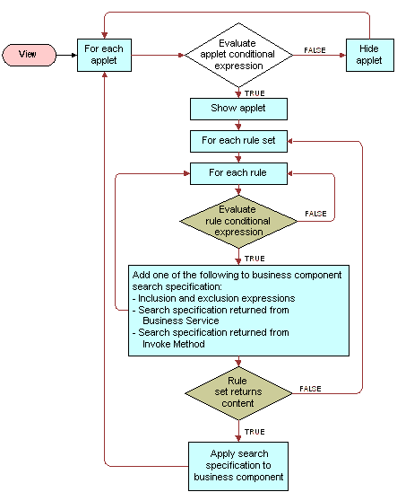

Rule Sets and Rules Flow Chart
You create both rule sets and rules in the Rule Sets view. The following figure shows the relationship of rules and rule sets to applets and views.
Evaluating Rule Sets
The following table lists the sequence in which rule sets are evaluated.
If... | Then... |
A rule set is evaluated and no content or records are returned. |
The next rule set is evaluated and
The conditional expression associated with the rule set evaluates to FALSE. |
Creating Complex Evaluation Flow
You can also use conditional expressions to set up Boolean logic (IF, AND, OR) among the rule sets associated with a view or an applet to create a more complex flow of evaluation.
The results of the evaluation of all the rules in the set are returned to the underlying business component associated with the applet in the form of a search expression. This search expression controls the content displayed in the applet.

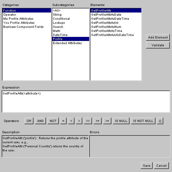

About the Personalization Business Rules Designer
The Personalization Business Rules Designer allows business managers to implement personalization rules without learning complex programming languages.
Displaying the Personalization Business Rules Designer
See also Personalization Business Rules Designer Contents, Process of Creating Business Rules, and Writing a Business Rule.
The Personalization Business Rules Designer (the following figure) appears when you click the icon in any selected expression field.
The contents of the Personalization Business Rules Designers are:
Categories. Contains the main categories available for building business rules:
Function. Siebel Query Language functions.
For more information, see Functions.
Operator. Siebel Query Language operators.
For more information, see Operators for Building Condition Expressions.
Me Profile Attributes. The profile attributes of the primary user, such as a Siebel eSales customer or Siebel Call Center agent.
The following table lists valid subcategories.
Subcategory Description ShowAsString
GetProfileAttr is used in the expression.
ShowAsNumber
GetProfileAttrAsNum is used in the expression.
ShowAsInteger
GetProfileAttrAsInt is used in the expression.
ShowAsDate
GetProfileAttrAsDate is used in the expression.
ShowAsTime
GetProfileAttrAsTime is used in the expression.
ShowAsDateTime
GetProfileAttrAsDateTime is used in the expression.
For more information on GetProfileAttr functions, see Profile Functions.
You Profile Attributes. The profile attributes of the secondary user, such as a customer calling a call center agent. Uses the same subcategories as Me Profile Attributes.
Business Component Fields. These depend on the context of the rule (the following table), that is, where the Rules Designer is invoked. This category will or will not have data in its elements, depending on the following contexts.
Context Data Shown View
None
Applet
Fields in the business component on which the applet is based
Rule set not associated with an applet
None
Rule set associated with one applet
Rule set associated with more than one applet, and the applets are based on the same business component
Fields in the business component on which the applets are based
Rule set associated with more than one applet, and the applets are based on different business components
None
Applet event
Application event
None
Business component event
Business component fields
Action set not associated with an applet event or business component event
None
Action set associated with one applet event
Action set associated with one business component event
Action set associated with more than one applet event or business component event
None
Subcategories. Contains subcategories of the selected category. Its context is controlled by the Categories box and it controls the context of the Elements box.
Elements. Contains all of the elements used to build business rules. Its context is controlled by the Categories and Subcategories boxes.
Expression. Displays the business rule. You can type and edit in the box, as well as add elements to it.
Quick bar (Operators). Provides buttons for frequently used operators.
Description. Gives a description of the element selected in the Elements box.
Errors. Displays errors in expressions or highlighted parts of expressions when you click Validate.
See also Displaying the Personalization Business Rules Designer, Personalization Business Rules Designer Contents, and Writing a Business Rule.
Use the following process to build your business rule using the Personalization Business Rules Designer:
Select an element, and then click Add Element.
Note: Double-clicking an element has the same effect as Add Element. You can also type text in the Expressions box.The Rules Designer automatically provides the correct syntax for elements. For example, adding the Left string function displays
Left(<string>,<n>)
in the Expressions box.Fill in arguments in the element, and then enclose it in parentheses if necessary.
Add other elements and complete them.
Connect elements using the Quick bar or by typing.
Click Validate to check your expression for errors.
If part of an expression is highlighted, only the highlighted string is evaluated. Errors are displayed in the Errors box.
Save the business rule and return to the expression field.
This also validates the entire rule.
If... Then... The rule is valid.
The rule is saved and the Rules Designer is closed.
The rule has any errors.
They are displayed and the Rules Designer is not closed.

Writing a Personalization Rule
This procedure describes how to write a personalization rule.
To write a personalization rule
Click the icon in a selected expression field.
Choose Operator from Categories, Pattern Matching from Subcategories, and EXISTS from Elements, and then click Add Element.
The Expression box displays
EXISTS(<condition>)
.Click
<condition>
to highlight it.Choose Business Component Fields from Categories, <All> from Subcategories, and Related Product from Elements, and then click Add Element.
EXISTS([Related Product])
.Place the cursor after
[Related Product]
in the Expression box, then click = in the Quick bar.The Expression box displays
EXISTS([Related Product]=)
.Place the cursor after =.
Choose Function from Categories, Profile from Subcategories, GetProfileAttr from Elements, and then click Add Element.
The Expression box displays:
EXISTS([Related Product]= GetProfileAttr(<attribute>))
Click
<attribute>
to highlight it, and then type"ProductInCart"
.The Expression box displays the completed rule:
EXISTS([Related Product] = GetProfileAttr("ProductInCart"))
Save the rule to validate it and put it in the expression field.

Conditional Expression |
Optional. Use the conditional expression to control the evaluation of the rule, or to set up Boolean logic for evaluation of all the rules in the rule set. |
Include Expression |
Use with the Expressions rule type. An expression that sets parameters to include content. |
Exclude Expression |
Use with the Expressions rule type. An expression that sets parameters to exclude content. |
((GetProfileAttr("Me.Is Anonymous") IS NULL) OR (GetProfileAttr("Me.Is Anonymous" = 'FALSE')) AND (GetProfileAttr (Full Name" IS NOT NULL)
This shows the expression only to registered users.
Description
Register your products.
This field is optional.
Include Expression
<br><img src='images/bullet_green.gif' align='top' > <b> Please register your products.
This free-form HTML text displays a bullet with the message in bold.

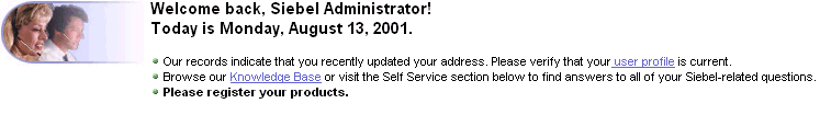

Viewing the Results of Modifying the eSalutation Applet
Log in to eService as SADMIN. The following figure is an example of the Siebel eService Salutation Applet after adding a new personalization rule.
