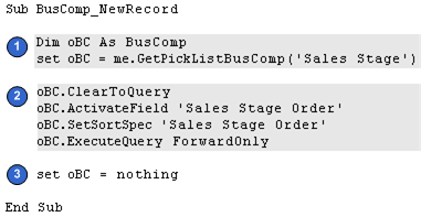

                                                              Example of Declaring an Object As a Siebel CRM Object Type
                                                              The following image includes an example that configures Siebel VB to access a Siebel object. You can declare an object as a Siebel CRM object type.
                                                              This figure provides an example of declaring an object as a Siebel CRM Object Type.
                                                              Explanation of Callouts
                                                              To declare an object as a Siebel CRM object type, you do the following work:
                                                              1. You create an object variable to access the code. This example uses as BusComp to declare the object. It does not use as Object. This example instantiates the business component (BusComp) Siebel object type. You could declare it as an object, but if you use the methods associated with the object type, then you must declare it as the appropriate object type.
                                                              2. You can use methods and properties to manipulate the objects.
                                                              3. Set oBC to nothing. It is recommended that you always set an object to nothing when your code instantiates it.
                                                              You can use similar code to access other types of objects that are compliant with COM. You can use the software application that creates the object to modify properties and methods of the objects. For an example, see Date and Time Methods.

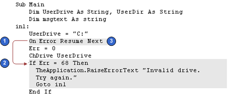

                                                                                                                                          Using the Body of the Code to Handle Siebel VB Errors
                                                                                                                                          To handle errors in the body of code, you place the code that handles the error immediately before the line of code that could cause an error.
                                                                                                                                          The following image includes an example that handles errors in the body of the code.
                                                                                                                                          Example That Handles Errors In the Body of the Code. This image is described in surrounding text.
                                                                                                                                          The example that handles errors in the body of the code includes the following items:
                                                                                                                                          1. The On Error statement identifies the line of code to run if an error occurs.
                                                                                                                                          2. The If statement handles the error. It uses the Err statement to identify the error that Siebel VB returns.
                                                                                                                                          3. The Resume Next argument instructs Siebel VB to proceed to the next line of code after it handles the error.

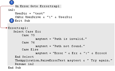

                                                                                                                                            Using an Error Handler to Handle Siebel VB Errors
                                                                                                                                            The following image includes an example that uses an error handler to handle errors.
                                                                                                                                            Example That Handles Errors With an Error Handler. This image is described in surrounding text.
                                                                                                                                            The example that uses an error handler to handle errors includes the following items:
                                                                                                                                            1. The On Error statement identifies the line of code that Siebel CRM runs if an error occurs. The code segment is part of the main code and it uses the Err statement to determine the error code that Siebel VB returns.
                                                                                                                                            2. You precede the code with an Exit statement to make sure that it does not accidentally proceed to the error handler.

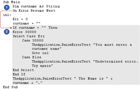

                                                                                                                                                Using the Body of the Code to Handle Custom Errors
                                                                                                                                                The following image includes an example that uses the body of the code to handle a custom error.
                                                                                                                                                Example That Handles Custom Errors In the Body of the Code. This image is described in surrounding text.
                                                                                                                                                The example that uses the body of the code to handle a custom error includes the following items:
                                                                                                                                                1. Place the code that handles the error immediately before the line of code that could cause an error.
                                                                                                                                                2. You use the Error statement to set the custom error to a value of 30000.

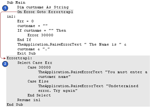

                                                                                                                                                  Using a Label to Handle Custom Errors
                                                                                                                                                  The following image includes an example that uses a label to handle a custom error.
                                                                                                                                                  Example That Handles Custom Errors With a Label. This image is described in surrounding text.
                                                                                                                                                  The example that uses a label to handle a custom error includes the following items:
                                                                                                                                                  2. Use a labeled section of code to handle the custom error.
