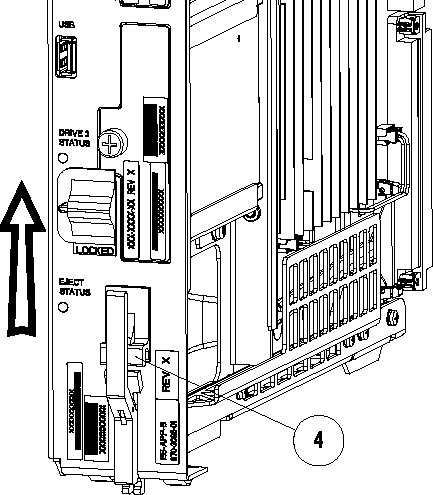

  1. On the E5-APP-B card, slide the Ejector switch (4) up to the UNLOCKED position (see Figure 5-1).
    Caution:
    When the Ejector switch goes from locked to unlocked and the E5-APP-B card is in service, the card will halt.
    Figure 5-1 E5-APP-B Card Eject Hardware Switch, UNLOCKED
  2. WAIT for the E5-APP-B Eject Status LED to go from blinking red to a steady red.
    When the Eject Status LED is steady red, the E5-APP-B card is in shutdown state.
    If the Ejector switch is put into the LOCKED position now, the E5-APP-B card will reboot.

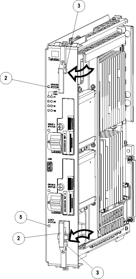

  3. Grasp the upper and lower card Inject/Eject (I/E) lever release (3) just underneath the I/E lever, and press it to meet the I/E lever. This is the mechanical interlock for the card.
    See Figure 5-2
    Figure 5-2 E5-APP-B Card UNLOCKED
  4. While holding the I/E interlock and lever, pull the levers (2) away from the shelf until they are parallel to the floor.
  5. Remove the E5-APP-B card from the EAGLE shelf.
