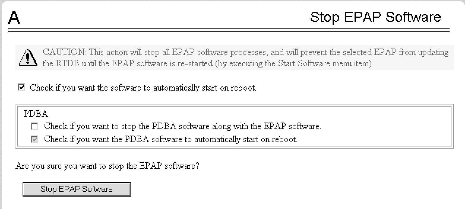

  4. Select Process Control>Stop Software to ensure that no other updates are occurring. The screen in Figure 3-13 displays:
    Figure 3-13 Stop EPAP Software

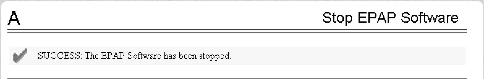

  5. When you stopped the software on the selected EPAP, the screen in Figure 3-14 displays:
    Figure 3-14 Stop EPAP Software - Success

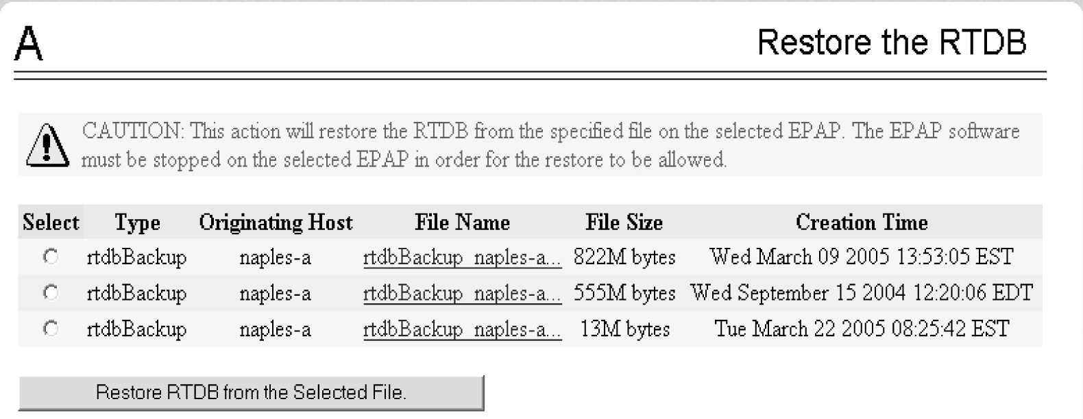

  6. Select RTDB>Maintenance>Restore RTDB. The screen shown in Figure 3-15 displays:
    Figure 3-15 Restoring the RTDB
  7. On the screen shown in Figure 3-15, select the file that was transferred in Figure 3-15. Click Restore the RTDB from the Selected File.

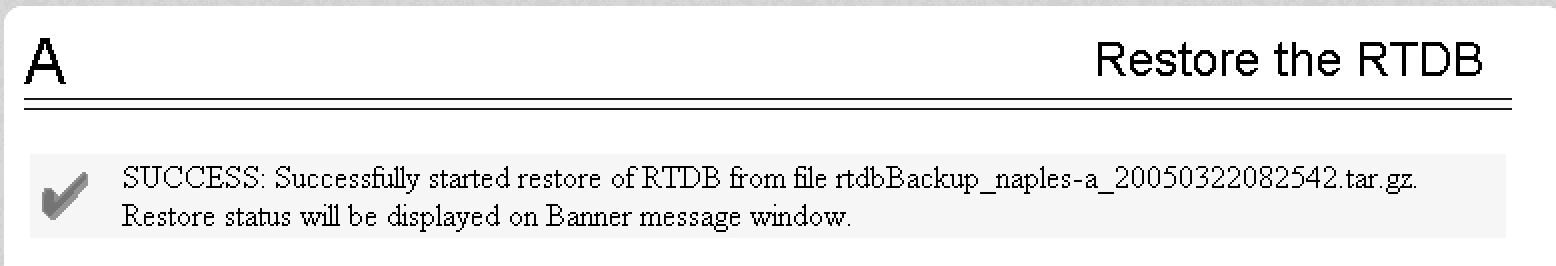

  9. When restoring the file is successful, the screen shown in Figure 3-17 displays:
    Figure 3-17 Restore the RTDB - Success

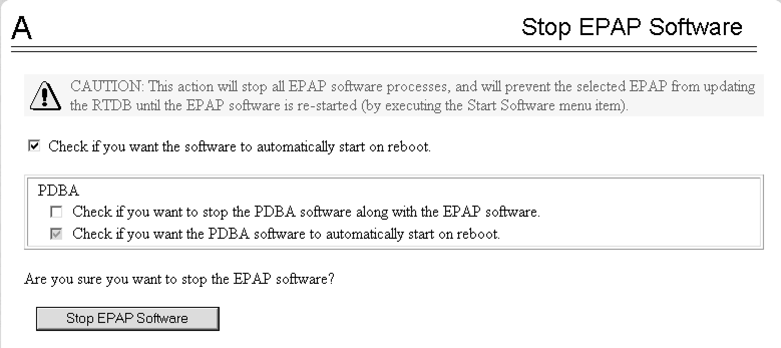

    The screen in Figure 3-18 displays:
    Figure 3-18 Stop EPAP Software

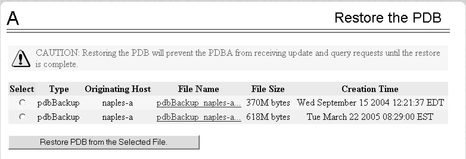

  6. Select PDBA>Maintenance>Backup>Restore the PDB.
    The screen shown in Figure 3-20 displays:
    Figure 3-20 Restoring the PDB
  7. On the screen shown in 6, select the file that was transferred in Restoring Databases from Backup Files.
    Click Restore the PDB from the Selected File.
